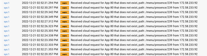

"Received cloud request for app 80 that does not exist"
Hi,
I'm not sure if this is related to the upgrade to 2.3.4.123 or something else, but these started streaming in this morning after my last reboot. I don't see any App with ID 80, nor a presence sensor with ID 239. Any help would be appreciated..
That's some sort of cloud integration that used to be app 80 but app 80 has been removed. The IP is a t-mobile IP. That ring any bells? Maybe something you set up for presence that has since been deleted?

Yes, that would’ve probably been my ex’s phone :sweat_smile:… any way to nuke it?
Hmmm. Sorry to drudge up bad memories. Politely ask them to delete the app from their phone? Tell them there's a zero-day exploit for that app and suggest they delete it right away? Let them know it allows you to track their location and out of concern for their privacy you'd like them to delete it? Make it a requirement of the settlement?
Thank you. Got ahold of him and got him to log out / delete the app. All good now (the logs, not my divorce..)
