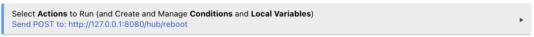

I use a schedule to reboot my hub once a week.
FYI, while @thebearmay's driver provides a ton of useful information and stats, it isn't needed to perform a reboot.
An RM action like the one shown below should be sufficient:

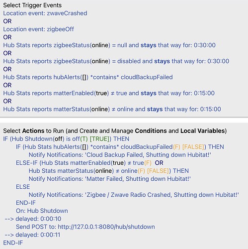

FWIW, there are programmatic ways to minimize this happening. Here's one:

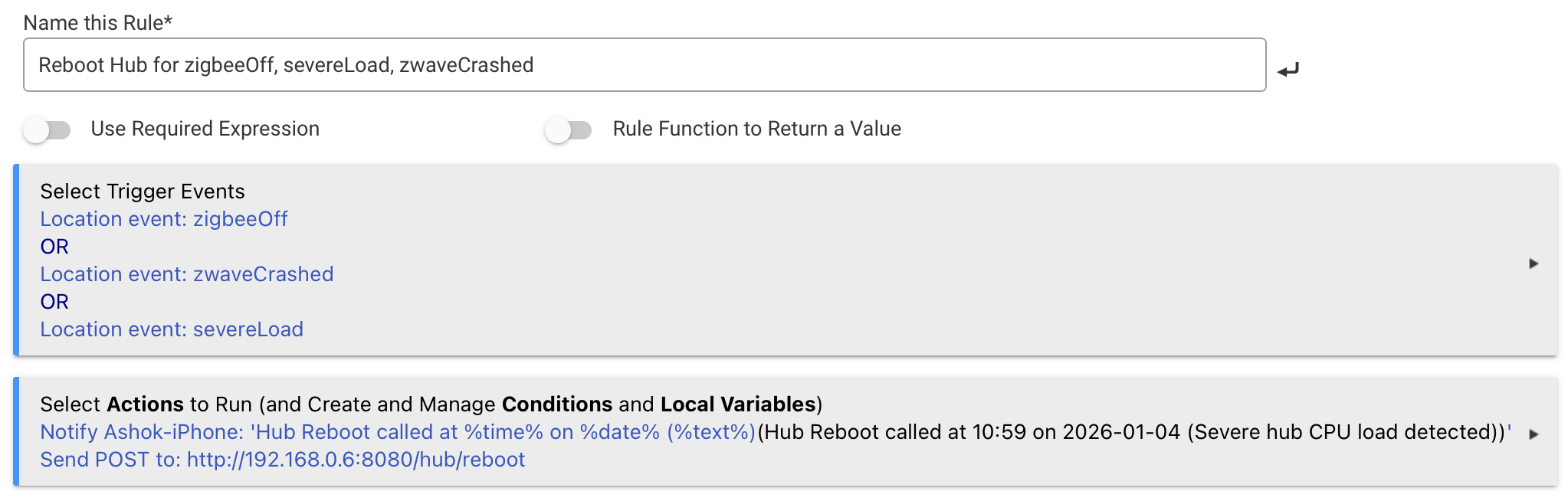

You know what they say about great minds :wink:

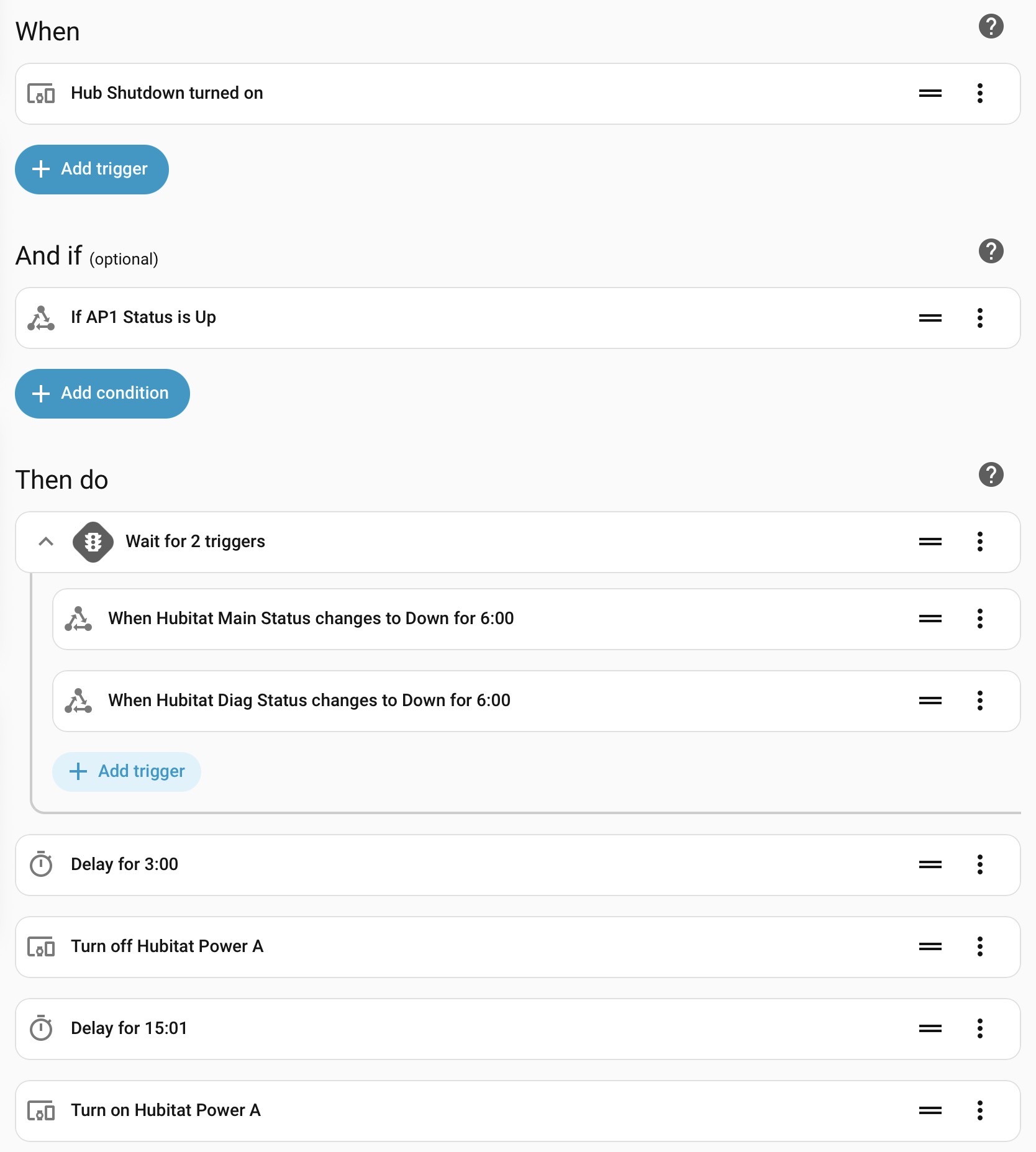

What restarts your hub, after your rule performs a hub shutdown?
In my previous home, my hubs were on outlets controlled by zigbee2mqtt. I had a NR flow that would ping the hubs periodically, and when no ping response was received for >5 minutes, the outlets would cycle.
Wondering if @sidjohn1 does something similar?
Home Assistant connected to a sonoff usb outlet/switch and uptimekuma to make sure my AP is up and both hubitat 8080/8081 ports are down

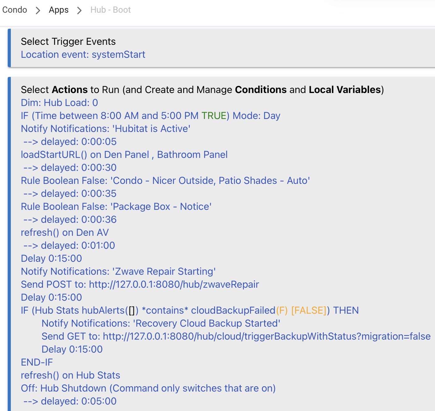

Just in case someone copies this, the cloudbackupfailed notice is sticky post shutdown and can cause a boot loop if you reboot/sutdown on the error. This is how i fix that.

I did this, it showed up in the log, but nothing happened.
Just to confirm that everything else in your rule was ok:
  1. It was an HTTP POST action and not GET, correct?
  2. The HTTP post was sent to port 8080 and not 80, correct?
Please post the logs from when this rule ran.
app:1712026-01-10 11:56:58.286 AM
info
Action: Send POST to: http://127.0.0.1:8080/hub/reboot
Ok, It did reboot, but I was expecting something to show on my screen. When nothing showed, I assumed nothing happened, but it did actually reboot.
This is normal behaviour.
