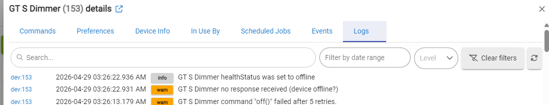

Looks like I had descriptive logging turned on for all children, so I removed that and now my log files dont show up, not sure if it still spams my zigbee channels, but at least hubitat isnt being overloaded.
I bought a 2 gang dimmer this time.
Is there any way I can use this?
https://ko.aliexpress.com/item/1005006869802535.html?spm=a2g0o.order_list.order_list_main.5.5758140faooq6u&gatewayAdapt=glo2kor
It works very precisely with the link product below. The breathing of the dimmer performance is very perfect.
https://www.aliexpress.com/p/order/detail.html?spm=a2g0o.order_list.order_list_main.40.5758140faooq6u&orderId=1119733158572235

dev:2392026-03-29 02:48:54.410 PMinfoTuyaDim updating settings for the parent device ... [logEnable:true, traceEnable:false, txtEnable:true, healthCheckInterval:10, infoEnable:true, debugEnable:true, autoOn:true, autoRefresh:true, minLevel:0, maxLevel:100, advancedOptions:true]
dev:2392026-03-29 02:48:54.408 PMdebugTuyaDim updated parent->child
dev:2392026-03-29 02:48:54.407 PMdebugTuyaDim forcedProfile is not set
dev:2392026-03-29 02:48:54.360 PMinfoscheduling health check every 10 minutes
dev:2392026-03-29 02:48:54.313 PMdebugTuyaDim updated() ... model=TS0601 manufacturer=_TZE284_jtbgusdc destinationEP=01 deviceProfile=UNKNOWN
dev:2392026-03-29 02:48:34.722 PMinfoscheduling health check every 10 minutes
dev:2392026-03-29 02:42:47.975 PMinfoscheduling health check every 10 minutes
dev:2392026-03-29 02:42:43.411 PMwarnTuyaDim command "on()" failed after 5 retries.
dev:2392026-03-29 02:42:03.827 PMwarnTuyaDim command "off()" failed after 5 retries.

dev:2392026-03-29 02:41:51.385 PMinfoInitializeVars( fullInit = true )...
dev:2392026-03-29 02:41:51.385 PMinfoTuyaDim All States DELETED
dev:2392026-03-29 02:41:51.384 PMdebugdeleting state states
dev:2392026-03-29 02:41:51.383 PMdebugdeleting state destinationEP
dev:2392026-03-29 02:41:51.382 PMdebugdeleting state driverVersion
dev:2392026-03-29 02:41:51.378 PMdebugdeleting state stats
dev:2392026-03-29 02:41:51.377 PMdebugdeleting state lastRx
dev:2392026-03-29 02:41:51.376 PMdebugdeleting state lastTx
dev:2392026-03-29 02:41:51.375 PMinfoTuyaDim All scheduled jobs DELETED
dev:2392026-03-29 02:41:51.353 PMinfoTuyaDim All current states (attributes) DELETED
dev:2392026-03-29 02:41:51.349 PMdebugdeleting healthStatus
dev:2392026-03-29 02:41:51.345 PMdebugdeleting switch
dev:2392026-03-29 02:41:51.342 PMdebugdeleting checkInterval
dev:2392026-03-29 02:41:51.338 PMdebugdeleting rtt
dev:2392026-03-29 02:41:51.335 PMdebugdeleting lightType
dev:2392026-03-29 02:41:51.331 PMdebugdeleting switch
dev:2392026-03-29 02:41:51.328 PMdebugdeleting ledMode
dev:2392026-03-29 02:41:51.325 PMdebugdeleting powerOnMode
dev:2392026-03-29 02:41:51.319 PMdebugdeleting level
dev:2392026-03-29 02:41:51.316 PMinfoTuyaDim All settings (preferences) DELETED
dev:2392026-03-29 02:41:51.313 PMdebugdeleting autoOn
dev:2392026-03-29 02:41:51.310 PMdebugdeleting maxLevel
dev:2392026-03-29 02:41:51.307 PMdebugdeleting minLevel
dev:2392026-03-29 02:41:51.304 PMdebugdeleting healthCheckInterval
dev:2392026-03-29 02:41:51.302 PMdebugdeleting advancedOptions
dev:2392026-03-29 02:41:51.299 PMdebugdeleting autoRefresh
dev:2392026-03-29 02:41:51.296 PMdebugdeleting debugEnable
dev:2392026-03-29 02:41:51.293 PMdebugdeleting infoEnable
dev:2392026-03-29 02:41:51.290 PMdebugdeleting txtEnable
dev:2392026-03-29 02:41:51.287 PMdebugdeleting traceEnable
dev:2392026-03-29 02:41:51.283 PMdebugdeleting logEnable
dev:2392026-03-29 02:41:51.283 PMwarnTuyaDim loadAllDefaults() !!!
dev:2392026-03-29 02:41:51.281 PMinfoinitialize() ... model=TS0601 manufacturer=_TZE284_jtbgusdc destinationEP=01 deviceProfile=UNKNOWN
dev:2392026-03-29 02:41:49.874 PMdebugTuyaDim sendZigbeeCommands: [he cmd 0xC3D5 0x01 0x0006 0 {}]
dev:2392026-03-29 02:41:45.316 PMdebugTuyaDim sendZigbeeCommands: [he cmd 0xC3D5 0x01 0x0006 0 {}]
dev:2392026-03-29 02:41:42.237 PMdebugTuyaDim sendZigbeeCommands: [he cmd 0xC3D5 0x01 0x0006 0 {}]
dev:2392026-03-29 02:41:40.604 PMdebugTuyaDim sendZigbeeCommands: [he cmd 0xC3D5 0x01 0x0006 0 {}]
dev:2392026-03-29 02:41:38.891 PMdebugTuyaDim sendZigbeeCommands: [he cmd 0xC3D5 0x01 0x0006 0 {}]
dev:2392026-03-29 02:41:28.112 PMinfoTuyaDim Round-trip time is 74 (ms)
dev:2392026-03-29 02:41:28.096 PMinfoTuyaDim healthStatus was set to online
dev:2392026-03-29 02:41:28.091 PMdebugTuyaDim parse: received raw description: read attr - raw: C3D50100000A0100204E, dni: C3D5, endpoint: 01, cluster: 0000, size: 0A, attrId: 0001, encoding: 20, command: 01, value: 4E
dev:2392026-03-29 02:41:28.041 PMdebugTuyaDim sendZigbeeCommands: [he rattr 0xC3D5 0x01 0x0000 0x0001 {}, delay 200]
dev:2392026-03-29 02:41:28.039 PMdebugTuyaDim ping parent: pingTime = [cmdTime:1774762857467, pingTime:1774762888037]
dev:2392026-03-29 02:41:07.462 PMinfoTuyaDim healthStatus was set to offline
dev:2392026-03-29 02:41:07.457 PMwarnTuyaDim no response received (device offline?)
dev:2392026-03-29 02:40:57.722 PMwarnTuyaDim command "off()" failed after 5 retries.
dev:2392026-03-29 02:40:57.467 PMdebugTuyaDim sendZigbeeCommands: [he cmd 0xC3D5 0x01 0x0006 0 {}]
dev:2392026-03-29 02:40:50.097 PMinfoTuyaDim updating settings for the parent device ... [logEnable:true, traceEnable:false, txtEnable:true, minLevel:0, maxLevel:100, autoOn:true, infoEnable:true, debugEnable:true, autoRefresh:true, advancedOptions:true, healthCheckInterval:10]
dev:2392026-03-29 02:40:50.095 PMdebugTuyaDim updated parent->child
dev:2392026-03-29 02:40:50.094 PMdebugTuyaDim forcedProfile is not set
dev:2392026-03-29 02:40:50.046 PMinfoscheduling health check every 10 minutes
dev:2392026-03-29 02:40:49.990 PMdebugTuyaDim updated() ... model=TS0601 manufacturer=_TZE284_jtbgusdc destinationEP=01 deviceProfile=UNKNOWN
dev:2392026-03-29 02:40:49.903 PMdebugTuyaDim sendZigbeeCommands: [he cmd 0xC3D5 0x01 0x0006 0 {}]
dev:2392026-03-29 02:40:43.810 PMdebugTuyaDim sendZigbeeCommands: [he cmd 0xC3D5 0x01 0x0006 0 {}]
dev:2392026-03-29 02:40:42.752 PMinfoTuyaDim updating settings for the parent device ... [logEnable:true, traceEnable:false, txtEnable:true, healthCheckInterval:10, infoEnable:true, debugEnable:true, autoOn:true, autoRefresh:false, minLevel:0, maxLevel:100, advancedOptions:true]
dev:2392026-03-29 02:40:42.750 PMdebugTuyaDim updated parent->child
dev:2392026-03-29 02:40:42.749 PMdebugTuyaDim forcedProfile is not set
dev:2392026-03-29 02:40:42.683 PMinfoscheduling health check every 10 minutes
dev:2392026-03-29 02:40:42.638 PMdebugTuyaDim updated() ... model=TS0601 manufacturer=_TZE284_jtbgusdc destinationEP=01 deviceProfile=UNKNOWN
dev:2392026-03-29 02:40:35.885 PMinfoscheduling health check every 10 minutes
dev:2392026-03-29 02:40:35.809 PMinfoInitializeVars( fullInit = true )...
dev:2392026-03-29 02:40:35.808 PMdebugdeleting state states
dev:2392026-03-29 02:40:35.807 PMdebugdeleting state destinationEP
dev:2392026-03-29 02:40:35.807 PMdebugdeleting state driverVersion
dev:2392026-03-29 02:40:35.806 PMdebugdeleting state stats
dev:2392026-03-29 02:40:35.805 PMdebugdeleting state lastRx
dev:2392026-03-29 02:40:35.804 PMdebugdeleting state lastTx
dev:2392026-03-29 02:40:35.779 PMdebugdeleting healthStatus
dev:2392026-03-29 02:40:35.775 PMdebugdeleting switch
dev:2392026-03-29 02:40:35.772 PMdebugdeleting checkInterval
dev:2392026-03-29 02:40:35.765 PMdebugdeleting rtt
dev:2392026-03-29 02:40:35.762 PMdebugdeleting lightType
dev:2392026-03-29 02:40:35.759 PMdebugdeleting switch
dev:2392026-03-29 02:40:35.756 PMdebugdeleting ledMode
dev:2392026-03-29 02:40:35.753 PMdebugdeleting powerOnMode
dev:2392026-03-29 02:40:35.747 PMdebugdeleting level
dev:2392026-03-29 02:40:35.742 PMdebugdeleting autoOn
dev:2392026-03-29 02:40:35.739 PMdebugdeleting maxLevel
dev:2392026-03-29 02:40:35.735 PMdebugdeleting minLevel
dev:2392026-03-29 02:40:35.730 PMdebugdeleting healthCheckInterval
dev:2392026-03-29 02:40:35.727 PMdebugdeleting txtEnable
dev:2392026-03-29 02:40:35.724 PMdebugdeleting traceEnable
dev:2392026-03-29 02:40:35.721 PMdebugdeleting logEnable
dev:2392026-03-29 02:40:35.718 PMinfoinitialize() ... model=TS0601 manufacturer=_TZE284_jtbgusdc destinationEP=01 deviceProfile=UNKNOWN
dev:2392026-03-29 02:39:49.126 PMinfoscheduling health check every 10 minutes
dev:2392026-03-29 02:38:23.477 PMwarnTuyaDim command "on()" failed after 5 retries.
dev:2392026-03-29 02:37:23.161 PMinfoTuyaDim updating settings for the parent device ... [infoEnable:true, debugEnable:true, autoRefresh:true, advancedOptions:true, logEnable:true, traceEnable:false, txtEnable:true, healthCheckInterval:10, minLevel:0, maxLevel:100, autoOn:true]
dev:2392026-03-29 02:37:23.152 PMdebugTuyaDim updated parent->child
dev:2392026-03-29 02:37:23.151 PMdebugTuyaDim forcedProfile is not set
dev:2392026-03-29 02:37:23.128 PMinfoscheduling health check every 10 minutes
dev:2392026-03-29 02:37:23.100 PMdebugTuyaDim updated() ... model=TS0601 manufacturer=_TZE284_jtbgusdc destinationEP=01 deviceProfile=UNKNOWN
dev:2392026-03-29 02:37:23.099 PMwarnTuyaDim device model TS0601 manufacturer _TZE284_jtbgusdc was not found!
dev:2392026-03-29 02:37:23.097 PMwarnTuyaDim model TS0601 manufacturer _TZE284_jtbgusdc NOT FOUND! deviceName=UNKNOWN profileName=UNKNOWN
dev:2392026-03-29 02:37:23.096 PMdebugTuyaDim setDestinationEP() destinationEP = 01
dev:2392026-03-29 02:37:23.094 PMdebugTuyaDim configure() ...
dev:2392026-03-29 02:37:23.089 PMdebugTuyaDim sendZigbeeCommands: [he raw 0x3708 1 0x01 0x0000 {10 00 00 04 00 00 00 01 00 05 00 07 00 FE FF}, delay 200, zdo bind 0x3708 0x01 0x01 0x0006 {A4C13835079BFE0C} {}, delay 200, zdo bind 0x3708 0x01 0x01 0x0008 {A4C13835079BFE0C} {}, delay 200, he cr 0x3708 0x01 0x0006 0 0x10 1 0xFFFE {}, delay 200, he cr 0x3708 0x01 0x0008 0 0x20 1 0xFFFE {}, delay 200, he rattr 0x3708 0x01 0x0006 0 {}, delay 100, he rattr 0x3708 0x01 0x0008 0 {}, delay 100]
dev:2392026-03-29 02:37:23.087 PMdebugTuyaDim cmdRefresh: (childDni=3708-01 endpointId=01) isParent()=true
dev:2392026-03-29 02:37:23.053 PMdebugTuyaDim spelling tuyaBlackMagic()
dev:2392026-03-29 02:37:23.052 PMdebugTuyaDim createChildDevices: no child devices to be created
dev:2392026-03-29 02:37:23.051 PMdebugTuyaDim createChildDevices: no child devices to be deleted
dev:2392026-03-29 02:37:23.049 PMdebugTuyaDim createChildDevices: single channel dimmer, no child devices are needed
dev:2392026-03-29 02:37:23.045 PMdebugTuyaDim initialized() device.getData() = [application:4E, softwareBuild:null, inClusters:0004,0005,EF00,0000,ED00, outClusters:0019,000A, model:TS0601, manufacturer:_TZE284_jtbgusdc]
dev:2392026-03-29 02:37:23.035 PMdebugTuyaDim initialized() ... model=TS0601 manufacturer=_TZE284_jtbgusdc destinationEP=UNKNOWN deviceProfile=UNKNOWN
dev:2392026-03-29 02:37:23.014 PMwarnTuyaDim device model TS0601 manufacturer _TZE284_jtbgusdc was not found!
dev:2392026-03-29 02:37:23.012 PMwarnTuyaDim model TS0601 manufacturer _TZE284_jtbgusdc NOT FOUND! deviceName=UNKNOWN profileName=UNKNOWN
dev:2392026-03-29 02:37:23.000 PMinfoInitializeVars( fullInit = true )...
dev:2392026-03-29 02:37:22.999 PMinfoTuyaDim All States DELETED
dev:2392026-03-29 02:37:22.998 PMdebugdeleting state states
dev:2392026-03-29 02:37:22.997 PMdebugdeleting state destinationEP
dev:2392026-03-29 02:37:22.996 PMdebugdeleting state driverVersion
dev:2392026-03-29 02:37:22.995 PMdebugdeleting state stats
dev:2392026-03-29 02:37:22.995 PMdebugdeleting state lastRx
dev:2392026-03-29 02:37:22.994 PMdebugdeleting state lastTx
dev:2392026-03-29 02:37:22.984 PMinfoTuyaDim All scheduled jobs DELETED
dev:2392026-03-29 02:37:22.967 PMinfoTuyaDim All current states (attributes) DELETED
dev:2392026-03-29 02:37:22.962 PMdebugdeleting healthStatus
dev:2392026-03-29 02:37:22.959 PMdebugdeleting switch
dev:2392026-03-29 02:37:22.956 PMdebugdeleting checkInterval
dev:2392026-03-29 02:37:22.952 PMdebugdeleting rtt
dev:2392026-03-29 02:37:22.949 PMdebugdeleting lightType
dev:2392026-03-29 02:37:22.946 PMdebugdeleting switch
dev:2392026-03-29 02:37:22.943 PMdebugdeleting ledMode
dev:2392026-03-29 02:37:22.939 PMdebugdeleting powerOnMode
dev:2392026-03-29 02:37:22.934 PMdebugdeleting level
dev:2392026-03-29 02:37:22.913 PMinfoTuyaDim All settings (preferences) DELETED
dev:2392026-03-29 02:37:22.910 PMdebugdeleting autoOn
dev:2392026-03-29 02:37:22.907 PMdebugdeleting maxLevel
dev:2392026-03-29 02:37:22.904 PMdebugdeleting minLevel
dev:2392026-03-29 02:37:22.901 PMdebugdeleting healthCheckInterval
dev:2392026-03-29 02:37:22.898 PMdebugdeleting txtEnable
dev:2392026-03-29 02:37:22.896 PMdebugdeleting traceEnable
dev:2392026-03-29 02:37:22.893 PMdebugdeleting logEnable
dev:2392026-03-29 02:37:22.890 PMdebugdeleting advancedOptions
dev:2392026-03-29 02:37:22.887 PMdebugdeleting autoRefresh
dev:2392026-03-29 02:37:22.884 PMdebugdeleting debugEnable
dev:2392026-03-29 02:37:22.880 PMdebugdeleting infoEnable
dev:2392026-03-29 02:37:22.873 PMwarnTuyaDim loadAllDefaults() !!!
dev:2392026-03-29 02:37:22.871 PMinfoinitialize() ... model=TS0601 manufacturer=_TZE284_jtbgusdc destinationEP=01 deviceProfile=UNKNOWN
dev:2392026-03-29 02:37:20.804 PMinfoTuyaDim updating settings for the parent device ... [infoEnable:true, debugEnable:true, autoRefresh:true, advancedOptions:true, logEnable:true, traceEnable:false, txtEnable:true, healthCheckInterval:10, minLevel:0, maxLevel:100, autoOn:true]
dev:2392026-03-29 02:37:20.802 PMdebugTuyaDim updated parent->child
dev:2392026-03-29 02:37:20.801 PMdebugTuyaDim forcedProfile is not set
dev:2392026-03-29 02:37:20.719 PMinfoscheduling health check every 10 minutes
dev:2392026-03-29 02:37:20.674 PMdebugTuyaDim updated() ... model=TS0601 manufacturer=_TZE284_jtbgusdc destinationEP=01 deviceProfile=UNKNOWN
dev:2392026-03-29 02:37:20.672 PMwarnTuyaDim device model TS0601 manufacturer _TZE284_jtbgusdc was not found!
dev:2392026-03-29 02:37:20.670 PMwarnTuyaDim model TS0601 manufacturer _TZE284_jtbgusdc NOT FOUND! deviceName=UNKNOWN profileName=UNKNOWN
dev:2392026-03-29 02:37:20.667 PMdebugTuyaDim setDestinationEP() destinationEP = 01
dev:2392026-03-29 02:37:20.665 PMdebugTuyaDim configure() ...
dev:2392026-03-29 02:37:20.280 PMdebugTuyaDim sendZigbeeCommands: [he rattr 0x3708 0x01 0x0006 0 {}, delay 100, he rattr 0x3708 0x01 0x0008 0 {}, delay 100]
dev:2392026-03-29 02:37:20.278 PMdebugTuyaDim cmdRefresh: (childDni=3708-01 endpointId=01) isParent()=true
dev:2392026-03-29 02:37:20.276 PMdebugTuyaDim refresh: parent 3708-01
dev:2392026-03-29 02:37:19.240 PMdebugTuyaDim sendZigbeeCommands: [he cmd 0x3708 0x01 0x0008 4 { 0xFF 0x6400 }, he cmd 0x3708 0x01 0x0006 1 {}]
dev:2392026-03-29 02:37:19.239 PMdebugTuyaDim cmdSetLevel: sending cmdTS011=[he cmd 0x3708 0x01 0x0008 4 { 0xFF 0x6400 }, he cmd 0x3708 0x01 0x0006 1 {}]
dev:2392026-03-29 02:37:19.237 PMdebugTuyaDim GIRIER/others: cmdSetLevel: sending value 255 cmdTS011=[he cmd 0x3708 0x01 0x0008 4 { 0xFF 0x6400 }]
dev:2392026-03-29 02:37:19.143 PMinfoTuyaDim healthStatus was set to offline
dev:2392026-03-29 02:37:19.139 PMwarnTuyaDim no response received (device offline?)
dev:2392026-03-29 02:37:09.196 PMdebugTuyaDim sendZigbeeCommands: [he rattr 0x3708 0x01 0x0006 0 {}, delay 100, he rattr 0x3708 0x01 0x0008 0 {}, delay 100]
dev:2392026-03-29 02:37:09.194 PMdebugTuyaDim cmdRefresh: (childDni=3708-01 endpointId=01) isParent()=true
dev:2392026-03-29 02:37:09.192 PMdebugTuyaDim refresh: parent 3708-01
dev:2392026-03-29 02:37:08.138 PMdebugTuyaDim sendZigbeeCommands: [he cmd 0x3708 0x01 0x0008 4 { 0xFF 0x6400 }, he cmd 0x3708 0x01 0x0006 1 {}]
dev:2392026-03-29 02:37:08.137 PMdebugTuyaDim cmdSetLevel: sending cmdTS011=[he cmd 0x3708 0x01 0x0008 4 { 0xFF 0x6400 }, he cmd 0x3708 0x01 0x0006 1 {}]
dev:2392026-03-29 02:37:08.135 PMdebugTuyaDim GIRIER/others: cmdSetLevel: sending value 255 cmdTS011=[he cmd 0x3708 0x01 0x0008 4 { 0xFF 0x6400 }]
dev:2392026-03-29 02:37:03.585 PMdebugTuyaDim sendZigbeeCommands: [he rattr 0x3708 0x01 0x0006 0 {}, delay 100, he rattr 0x3708 0x01 0x0008 0 {}, delay 100]
dev:2392026-03-29 02:37:03.583 PMdebugTuyaDim cmdRefresh: (childDni=3708-01 endpointId=01) isParent()=true
dev:2392026-03-29 02:37:03.581 PMdebugTuyaDim refresh: parent 3708-01
dev:2392026-03-29 02:37:02.533 PMdebugTuyaDim sendZigbeeCommands: [he cmd 0x3708 0x01 0x0008 4 { 0xFF 0x6400 }, he cmd 0x3708 0x01 0x0006 1 {}]
dev:2392026-03-29 02:37:02.531 PMdebugTuyaDim cmdSetLevel: sending cmdTS011=[he cmd 0x3708 0x01 0x0008 4 { 0xFF 0x6400 }, he cmd 0x3708 0x01 0x0006 1 {}]
dev:2392026-03-29 02:37:02.528 PMdebugTuyaDim GIRIER/others: cmdSetLevel: sending value 255 cmdTS011=[he cmd 0x3708 0x01 0x0008 4 { 0xFF 0x6400 }]
dev:2392026-03-29 02:36:57.911 PMdebugTuyaDim sendZigbeeCommands: [he rattr 0x3708 0x01 0x0006 0 {}, delay 100, he rattr 0x3708 0x01 0x0008 0 {}, delay 100]
dev:2392026-03-29 02:36:57.909 PMdebugTuyaDim cmdRefresh: (childDni=3708-01 endpointId=01) isParent()=true
dev:2392026-03-29 02:36:57.907 PMdebugTuyaDim refresh: parent 3708-01
dev:2392026-03-29 02:36:57.688 PMdebugTuyaDim zigbee received unknown Basic cluster attribute 0xFFDF (value e )
dev:2392026-03-29 02:36:57.662 PMinfoTuyaDim healthStatus was set to online
dev:2392026-03-29 02:36:57.646 PMdebugTuyaDim parse: received raw description: read attr - raw: 37080100001CDFFF420A06000000650700000012, dni: 3708, endpoint: 01, cluster: 0000, size: 1C, attrId: FFDF, encoding: 42, command: 0A, value: 0A06000000650700000012
dev:2392026-03-29 02:36:56.877 PMdebugTuyaDim sendZigbeeCommands: [he cmd 0x3708 0x01 0x0008 4 { 0xFF 0x6400 }, he cmd 0x3708 0x01 0x0006 1 {}]
dev:2392026-03-29 02:36:56.875 PMdebugTuyaDim cmdSetLevel: sending cmdTS011=[he cmd 0x3708 0x01 0x0008 4 { 0xFF 0x6400 }, he cmd 0x3708 0x01 0x0006 1 {}]
dev:2392026-03-29 02:36:56.871 PMdebugTuyaDim GIRIER/others: cmdSetLevel: sending value 255 cmdTS011=[he cmd 0x3708 0x01 0x0008 4 { 0xFF 0x6400 }]
dev:2392026-03-29 02:36:50.915 PMdebugTuyaDim sendZigbeeCommands: [he cmd 0x3708 0x01 0x0006 0 {}]
dev:2392026-03-29 02:36:46.349 PMdebugTuyaDim sendZigbeeCommands: [he cmd 0x3708 0x01 0x0006 0 {}]
dev:2392026-03-29 02:36:43.289 PMdebugTuyaDim sendZigbeeCommands: [he cmd 0x3708 0x01 0x0006 0 {}]
dev:2392026-03-29 02:36:41.743 PMdebugTuyaDim sendZigbeeCommands: [he cmd 0x3708 0x01 0x0006 0 {}]
dev:2392026-03-29 02:36:40.081 PMdebugTuyaDim sendZigbeeCommands: [he cmd 0x3708 0x01 0x0006 0 {}]

Hi, kkossev
I updated the driver.
But strangely, it doesn't work.
It keeps turning offline.
When you have time, please check it again.
I'm using another driver temporarily, so you can take your time to occupy it.
Summary
dev:2582026-04-28 07:01:02.402 PM
info
Gled N1 Dimmer was turned off
dev:2582026-04-28 07:00:59.628 PM
info
Gled N1 Dimmer level is 100%
dev:2582026-04-28 07:00:59.618 PM
info
Gled N1 Dimmer was turned on
dev:2582026-04-28 06:52:52.255 PM
warn
description logging is: true
dev:2582026-04-28 06:52:52.254 PM
warn
debug logging is: false
dev:2582026-04-28 06:52:52.252 PM
info
updated...
dev:2582026-04-28 06:52:22.451 PM
info
dev:2582026-04-28 06:52:18.720 PM
info
dev:2582026-04-28 06:52:18.716 PM
info
dev:2582026-04-28 06:52:05.197 PM
info
dev:2582026-04-28 06:52:03.813 PM
info
dev:2582026-04-28 06:52:03.809 PM
info
dev:2582026-04-28 06:52:01.696 PM
info
dev:2582026-04-28 06:51:59.407 PM
info
dev:2582026-04-28 06:51:59.402 PM
info
dev:2582026-04-28 06:51:25.430 PM
info
dev:2582026-04-28 06:51:19.384 PM
info
Gled N1 Dimmer level was set to 100%
dev:2582026-04-28 06:51:13.623 PM
info
Gled N1 Dimmer level is 20%
dev:2582026-04-28 06:51:13.619 PM
info
dev:2582026-04-28 06:51:12.688 PM
info
dev:2582026-04-28 06:51:10.302 PM
info
dev:2582026-04-28 06:51:09.922 PM
info
Gled N1 Dimmer saturation is 0%

However, as in the picture, an abnormal part, an offline mark, appears, and appears in the log.
But it actually works.

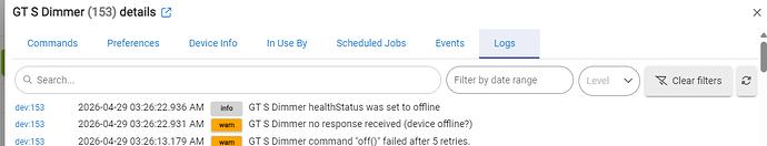

I see the off() command is not confirmed by this device, that's why the driver considers it has gone offline ..
Does the off() command actually work and turn the dimmer off?
I rebooted the hub.
If you command ON and OFF in the picture below, they all work well.
It could be a problem with Hubitat.
I remember seeing this on Hubitat official other drivers as well.
Maybe I can delete it and reconnect it
I will come back to this device issues after I publish the new Aqara P100 multi sensor driver.. : )
I deleted 2 devices and connected them again.
One instrument has returned to normal, and the other has the same problem.
It's time for me to go to bed.
