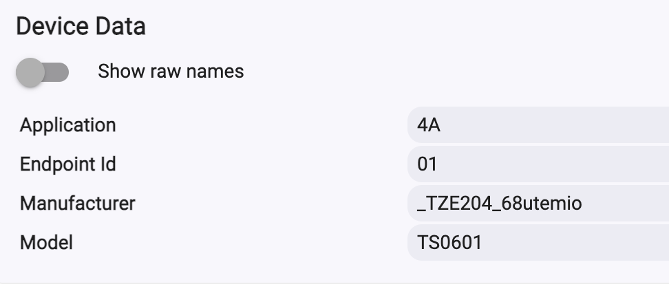

Hi Marcelo,
I will need to know your device model and manufacturer, as shown at the bottom of the Hubitat web page.
  • endpointId: 01
  • application: 46
  • manufacturer: _TZE200_r32ctezx
  • model: TS0601
  • tuyaVersion: 1.0.6

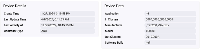

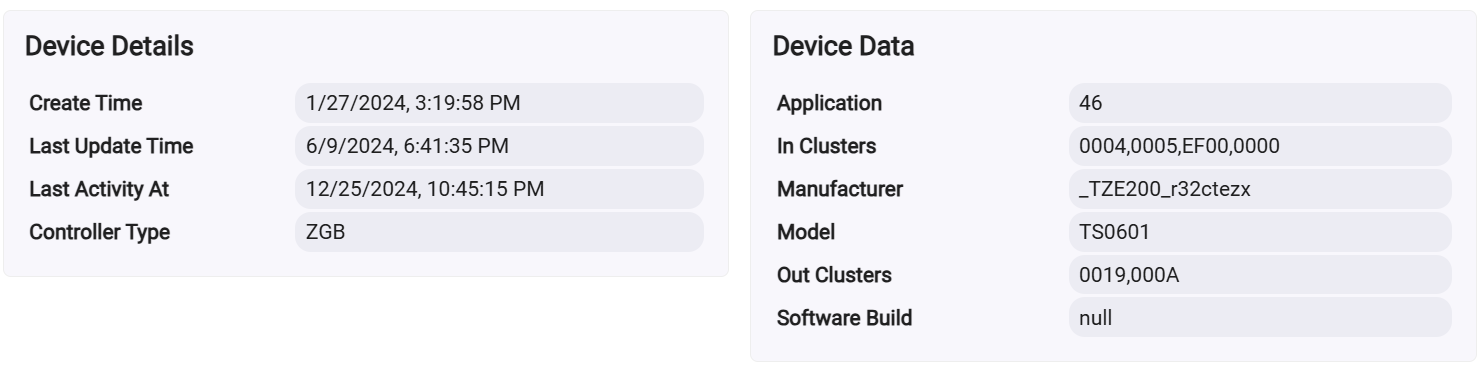

Hello, it took quite some while before I got this far that I've now collected some fresh log info from this device. As it's been quite some while I also post here again the basic information for the device / fan control.
And here the log I get when manually switching the fan ON to level 1, 2, 3, 4, 5 and then OFF and then back ON to level 5, 4, 3, 2, 1, OFF.

Hello again, I also have a current ZemiSmart Single-Gang Zigbee Dimmer which I've been trying to add to HE without success. It pairs as the Moes 1-2-3 gang device, but from your comments above it looks more like this driver. In any case neither of these, nor the generic driver seem to control the dimmer.
Its properties show as:
Any ideas...?
Hello @kkossev - So not all my area of expertise, but I had a go at creating a fingerprint by looking a the other examples in your driver and it seems to work. For now I'm using it on my installation, but if you're ok with it, it seems to be usable... Here goes:
"_TZE204_68utemio": [ numEps: 1, model: "TS0601", inClusters: "0000,0004,0005,EF00", joinName: "Zemismart Zigbee 1-Gang Switch Dimmer"], //@mtate
with the link in the TS0601 Dimmer section:
[numEps: 1, profileId:"0104", endpointId:"01", inClusters:"0000,0004,0005,EF00", outClusters:"0019,000A", model:"TS0601", manufacturer:"_TZE204_68utemio", deviceJoinName: "Zemismart Zigbee 1-Gang Switch Dimmer"], // @MTate
Frankly a bit scared. First time I've done this.
