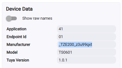

I just installed a Moes Starfeather Zigbee Wall Switch; recognized as Model TSO601 - Manufacturer = _TZE200_z3u99qxt. Tuya Version = 1.0.1.
Purchased off of Amazon --- MOES Full Touch Smart Switch, ZigBee SF(Star Feather 2026 Version) Wall Light Switch, Neutral Wire Required, Anti-Glare Panel,Work with Smart Life/Tuya App, Alexa and Google Home White 1 Gang - Amazon.com. I have this driver installed with HPM and the device is paired and the device parameters update and the switch works when I engage it physically however, it will not turn on or off by the app. Is there any chance you can update the driver for this newer model?
'Moes ZigBee Wall Switch 1/2/3-Gang revision 1.5.0 - 2026-04-14 :
  • added all known Moes Star Feather Zigbee Wall Switches (1-4 gangs) with support for all their features, including _TZE200_z3u99qxt @smc.cross
Can you update manually to the new version and test if it works OK with your device (TSO601 = _TZE200_z3u99qxt) ?

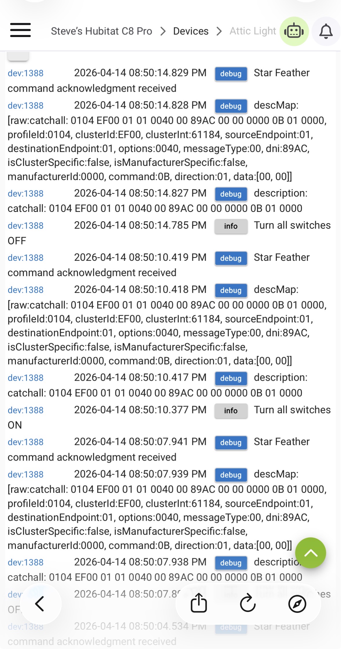

Thanks for a quick turn; as before, it pairs and allows the parameters to be changed and I manually updated the driver and saw my user name in the code. However it does not turn on the relay from the app. Attached is a short snapshot of the logs. Let me know if you need anything else or a longer run of the logs.
Hi Steven, I don't know what your device is?
Please post the Zigbee model / manufacturer as shown at the bottom of the Device Info page.
Also, please show me the logs after clicking on the Refresh() button.
UPDATE: I think that I have found the problem in the on/off functions for the Star Feather switches - I will try to update the driver this evening
UPDATE2: the fix is applied on the updated driver - same version 1.5.0, time stamp is '2026/04/15 8:23 AM'.
You rock kkossev! That did it :slight_smile:

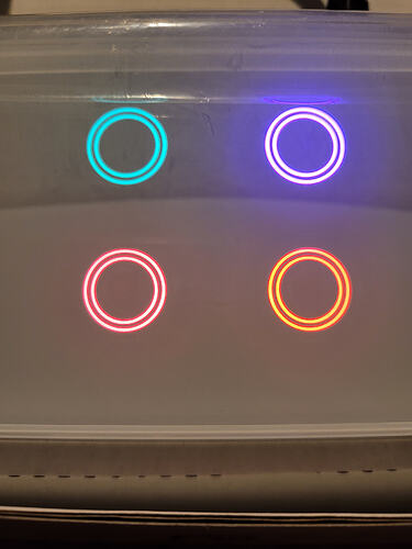

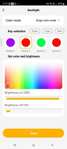

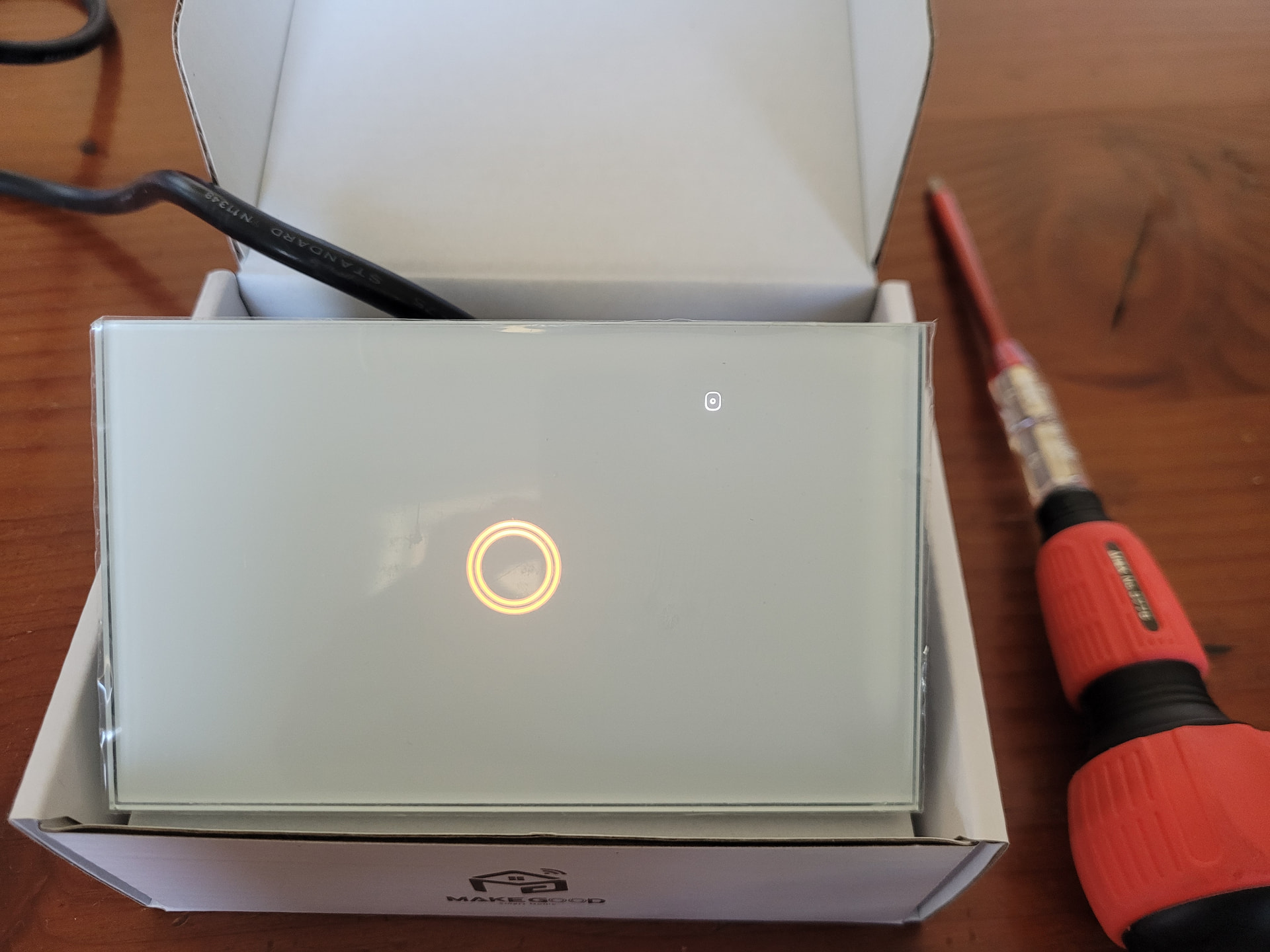

This driver works for the newer MakeGood (I assume it is a rebrand) TS0601 zigbee switches. However, these newer switches use RGB LEDs and you can set the color of on and off to what ever you want on each switch.
So far it seems to work to add them to a Tuya zigbee hub, set the colors and then add it to the Hubitat. Is there any way to adjust the color within Hubitat or will that take a complete rewrite of the driver?

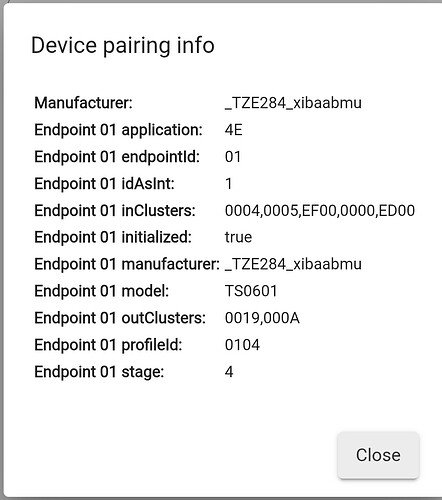

Can you post the complete device fingerprint? Use the HE inbuilt ‘Device’ driver, command ‘Get Info’
Is this what you mean?
fingerprint profileId:"0104", endpointId:"01", inClusters:"0004,0005,EF00,0000,ED00", outClusters:"0019,000A", model:"TS0601", manufacturer:"_TZE284_ebe3s0rz", controllerType: "ZGB"
trace
ZCL version:03
trace
Model:TS0601
trace
Manufacturer:_TZE284_ebe3s0rz
debug
getting info for unknown Zigbee device..
Zigbee parsed:[raw:C30E0100001801002046E2FF2038E4FF2000, dni:C30E, endpoint:01, cluster:0000, size:18, attrId:0001, encoding:20, command:0A, value:46, clusterInt:0, attrInt:1, additionalAttrs:[[value:38, encoding:20, attrId:FFE2, consumedBytes:4, attrInt:65506], [value:00, encoding:20, attrId:FFE4, consumedBytes:4, attrInt:65508]]]

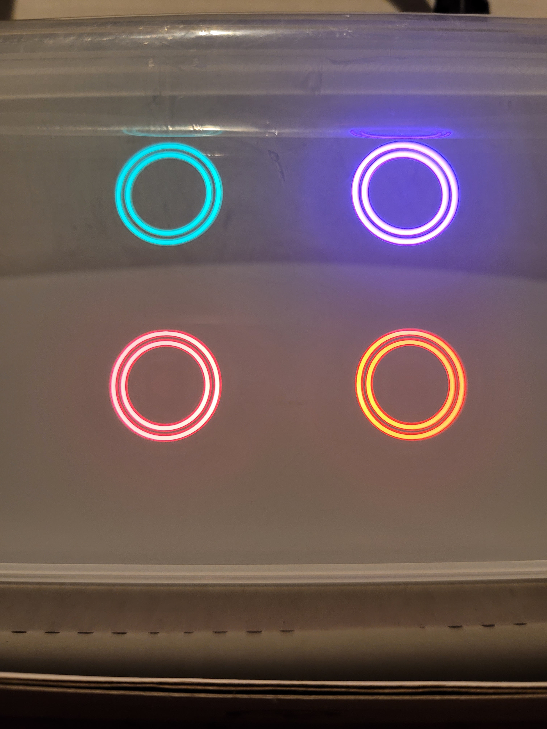

Above is for a 2 gang switch. This is a 4 gang and colors are pretty nice and bight. You can adjust the intensity as well as color. My old phone doesn't do justice to the color.
They also beep pretty loud for on/off which I'm going to have to turn off.
In the Tuya app. You can have a single color different intensity for on/off or dual color with different color for on/off.

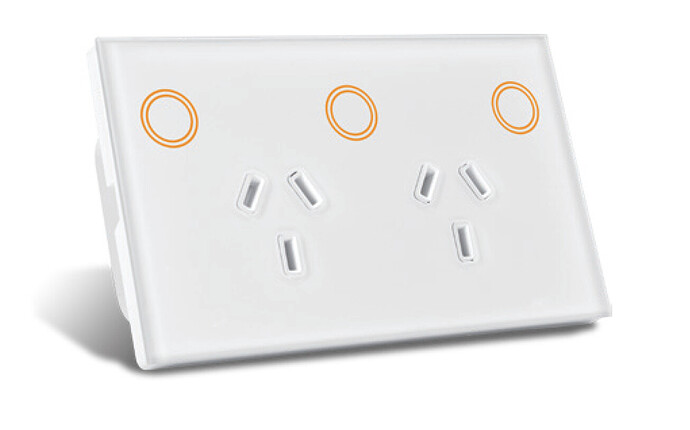

While we are having fun with TS0601 zigbee switches.
Any thoughts on a double GPO and Light?
The light works as a single gang light with the Moe TS0601 driver.

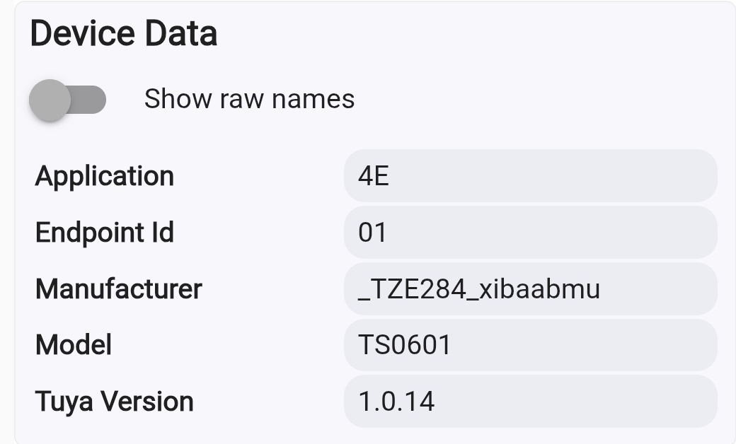

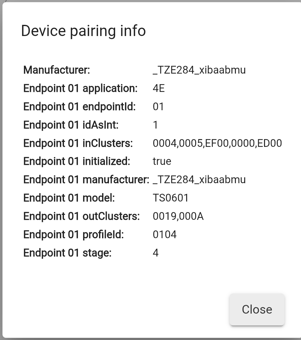

Hi,@kkossev!
I'm struggling to make a new four gang Zemismart switch to work. I tried several drivers, including yours Tuya Zigbee Switch, without success; the Moes ZigBee Wall Switch 1/2/3-Gang (Tuya TS0601 Switches) isn't working too - this one recognize all the 4 child devices, but they don't work. With this driver the child devices also can't have its names edited, neither command the lights.
When pairing for the first time, Hubitat recognized it as a Zemismart Zigbee Blind.
The device data is the following:
Device Data
Application 4E
Endpoint Id 01
Manufacturer _TZE284_xibaabmu
Model TS0601
Tuya Version 1.0.14
Any chance to add it to your driver? This is the device link.
Thanks in advance for any help!
