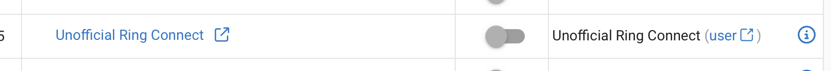

I installed the app code via HPM and so far so good. All I care about is that I can see my contact sensors at this point and there they are under the location. But I'm confused - the App instance doesn't appear under Apps; I only see Devices. Is that expected behavior?
