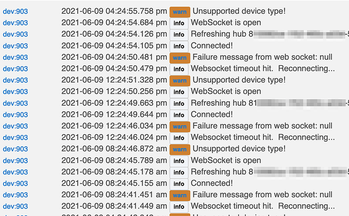

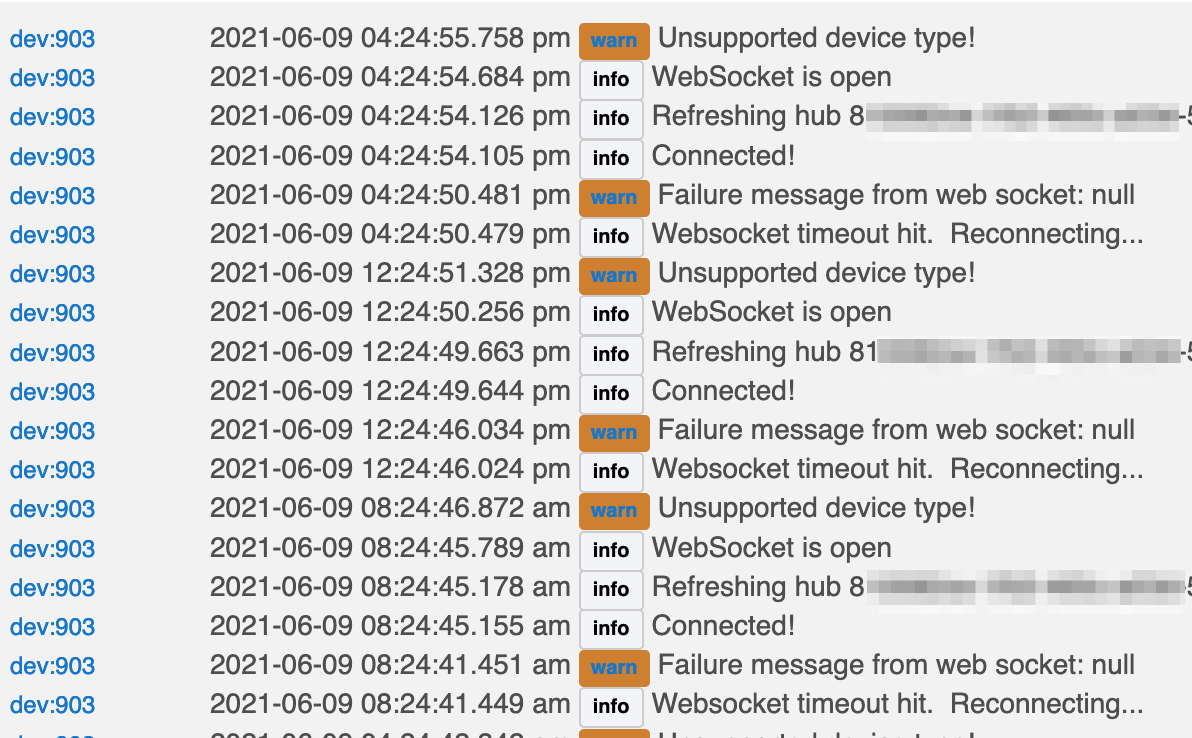

So, I installed the Ring integration and it worked flawlessly for about a day, however now I can no longer get any status changes, and when I look at the Events for the Ring API Virtual device I see the following ...
websocket disconnect DEVICE 2021-05-29 04:14:19.449 AM CDT
websocket failure DEVICE 2021-05-29 04:14:19.356 AM CDT
websocket connected DEVICE 2021-05-29 12:14:18.690 AM CDT
It logged a ton of these, then apparently just stopped trying, hasnt updated the log in about a week.

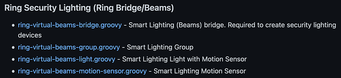

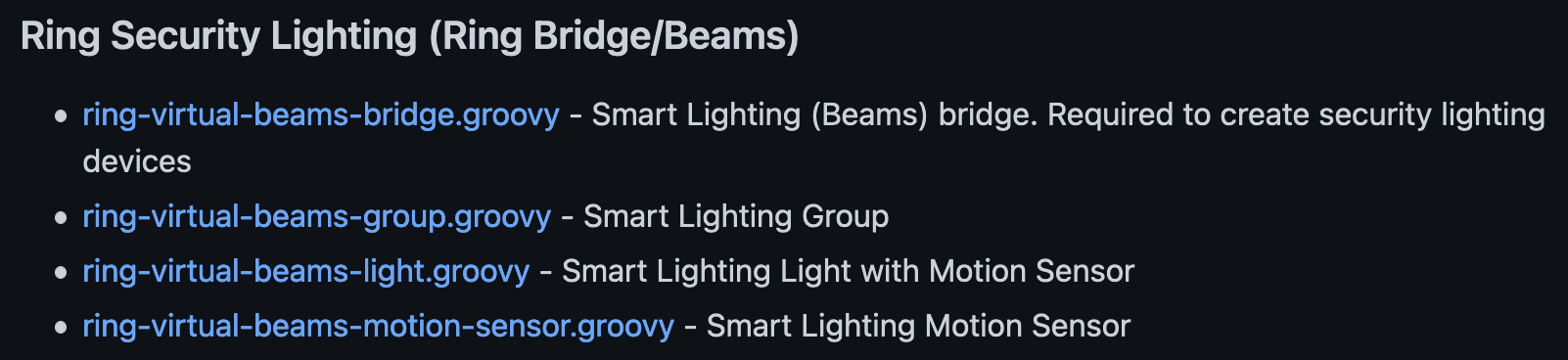

Now to my problem. I have the Ring Lighting Bridge, the Alarm hub (for future expansion), the wired floodlight and the battery floodlight (both with motion sensors.) I have completed the install (successfully, I think, and the Ring API virtual device, virtual beams lights, virtual beams groups, virtual alarm hub, virtual beams bridge all appear as devices. Unfortunately, I am unable to detect motion using the virtual beams groups device or the virtual beams lights device. The status of the Ring API Device websocket is connected. Can you tell me what have I missed?
Is it possible you got signed out?
Safe to assume you have the beams code loaded and devices discovered?
I don't have beam lights, so can't really help out here much.
At the risk of sounding stupid, are you talking about signed out of the Ring app, or signed out of the Ring integration (virtual device?) on the HE?
Not at all, all questions are valid.
The latter, signed out of the Ring credentials you used in this integration.
I see something similar, but it's normal in terms of every 4 hours the WebSocket gets disconnected by Amazon and this integration goes and re-connects.
e.g.
My integration worked for about a day, however now I get this over and over in the log
I've checked the alarm hub and the top level virtual device, but I don't see where I can re-enter the credentials.
Nothing's changed credential-wise, but cannot see where to re-enter in this integration.

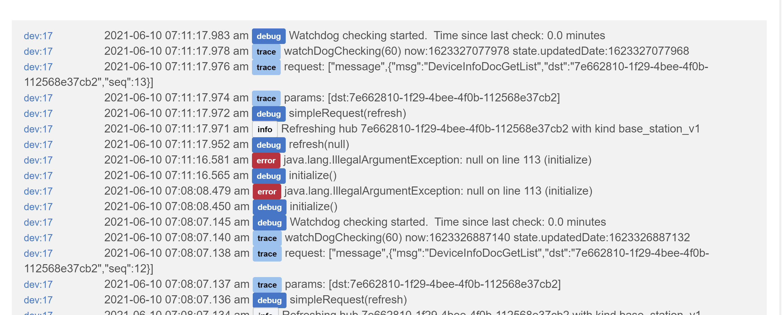

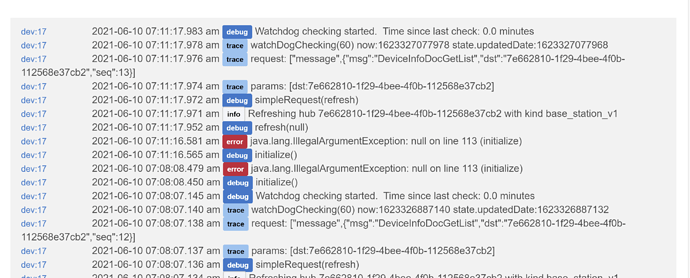

I get this in the system logs
