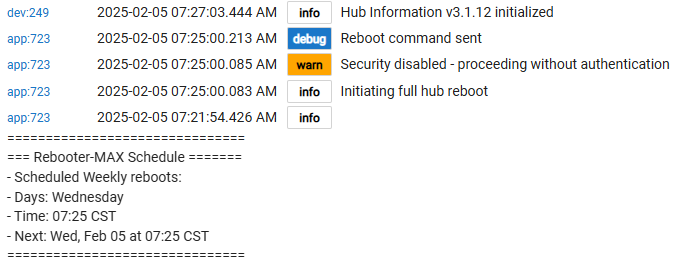

[ re-release ] hub auto rebooter - max
Updated Dominick Meglio's app using AI ..
To do weekly-biweekly-monthly reboots. with lots of added logging.
I think It mostly works .. but I have not tested the hub security reboot.
( I do not use hub security ) < If someone want to test this that would be great.
Install ..

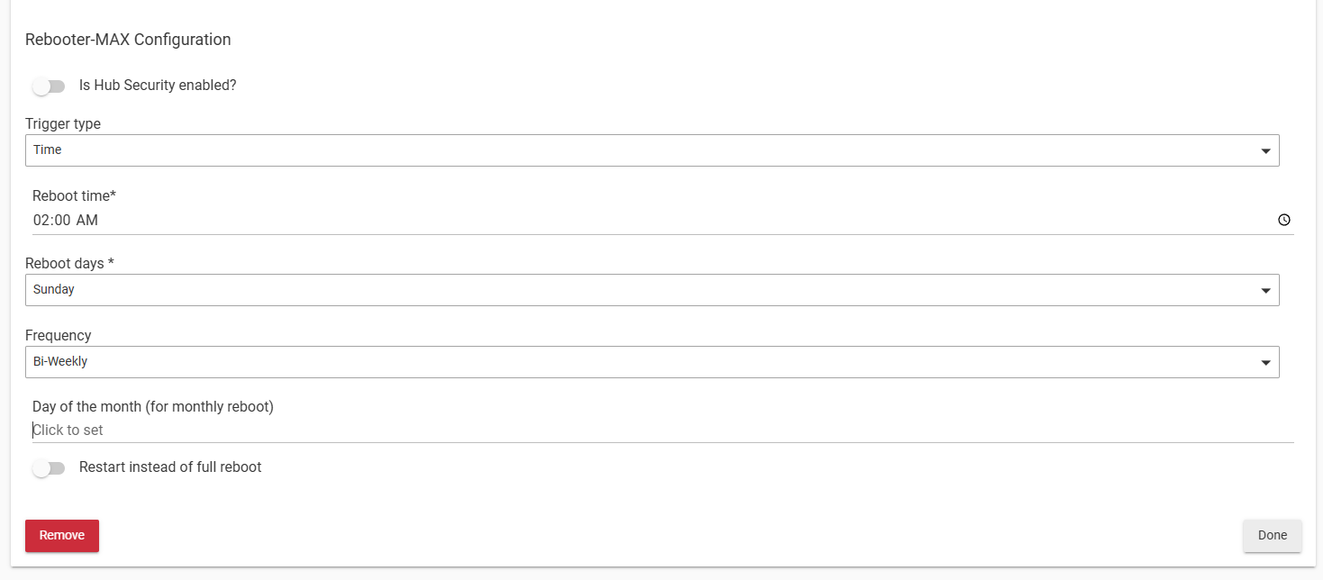

def prefMain() {
    return dynamicPage(name: "prefMain", title: "Rebooter-MAX Configuration", install: true, uninstall: true) {
        section("") {
            input "rebootSecurity", "bool", title: "Is Hub Security enabled?", defaultValue: false
            if (rebootSecurity) {
                input "rebootUsername", "string", title: "Hub Security username", required: true
                input "rebootPassword", "password", title: "Hub Security password", required: true
            input "rebootType", "enum", title: "Trigger type", options: ["Time", "Button"], defaultValue: "Time", submitOnChange: true
            if (rebootType == "Time") {
                input "rebootTime", "time", title: "Reboot time", required: true
                input "rebootDays", "enum", title: "Reboot days", required: true, multiple: true,
                options: ["Sunday", "Monday", "Tuesday", "Wednesday", "Thursday", "Friday", "Saturday"]
                input "rebootFrequency", "enum", title: "Frequency", options: ["Weekly", "Bi-Weekly", "Monthly"], defaultValue: "Weekly"
                input "rebootDayOfMonth", "number", title: "Day of the month (for monthly reboot)", required: false
            } else if (rebootType == "Button") {
                input "rebootButton", "capability.pushableButton", title: "Trigger button", required: true
            input "restartInsteadOfReboot", "bool", title: "Restart instead of full reboot", defaultValue: false

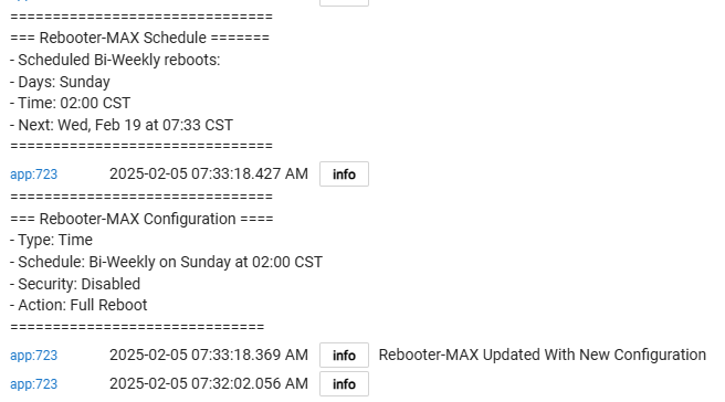

def logConfiguration() {
    log.info """
    === Rebooter-MAX Configuration ====
    - Type:        ${rebootType}
    ${rebootType == "Time" ? "- Schedule:    ${rebootFrequency} on ${rebootDays.join(', ')} at ${new Date(timeToday(rebootTime).time).format("HH:mm z", location.timeZone)}\n|" : ""}\
    - Security:    ${rebootSecurity ? "Enabled (user: ${rebootUsername})" : "Disabled"}
    - Action:      ${restartInsteadOfReboot ? "Restart Process" : "Full Reboot"}
    ==============================""".stripMargin()
def logSchedule(time) {
    def nextExecutions = []
    def nextRunTime
    // Calculate next execution manually based on frequency
    if (rebootFrequency == "Weekly") {
        nextRunTime = getNextWeeklyRun(time)
    } else if (rebootFrequency == "Bi-Weekly") {
        nextRunTime = getNextBiWeeklyRun(time)
    } else if (rebootFrequency == "Monthly") {
        nextRunTime = getNextMonthlyRun(time)
    if (nextRunTime) {
        nextExecutions << new Date(nextRunTime).format("EEE, MMM dd 'at' HH:mm z", location.timeZone)
    log.info """
    === Rebooter-MAX Schedule =======
    - Scheduled ${rebootFrequency} reboots:
    - Days:       ${rebootDays.join(', ')}
    - Time:       ${time.format("HH:mm z", location.timeZone)}
    - Next: ${nextExecutions.first()}
