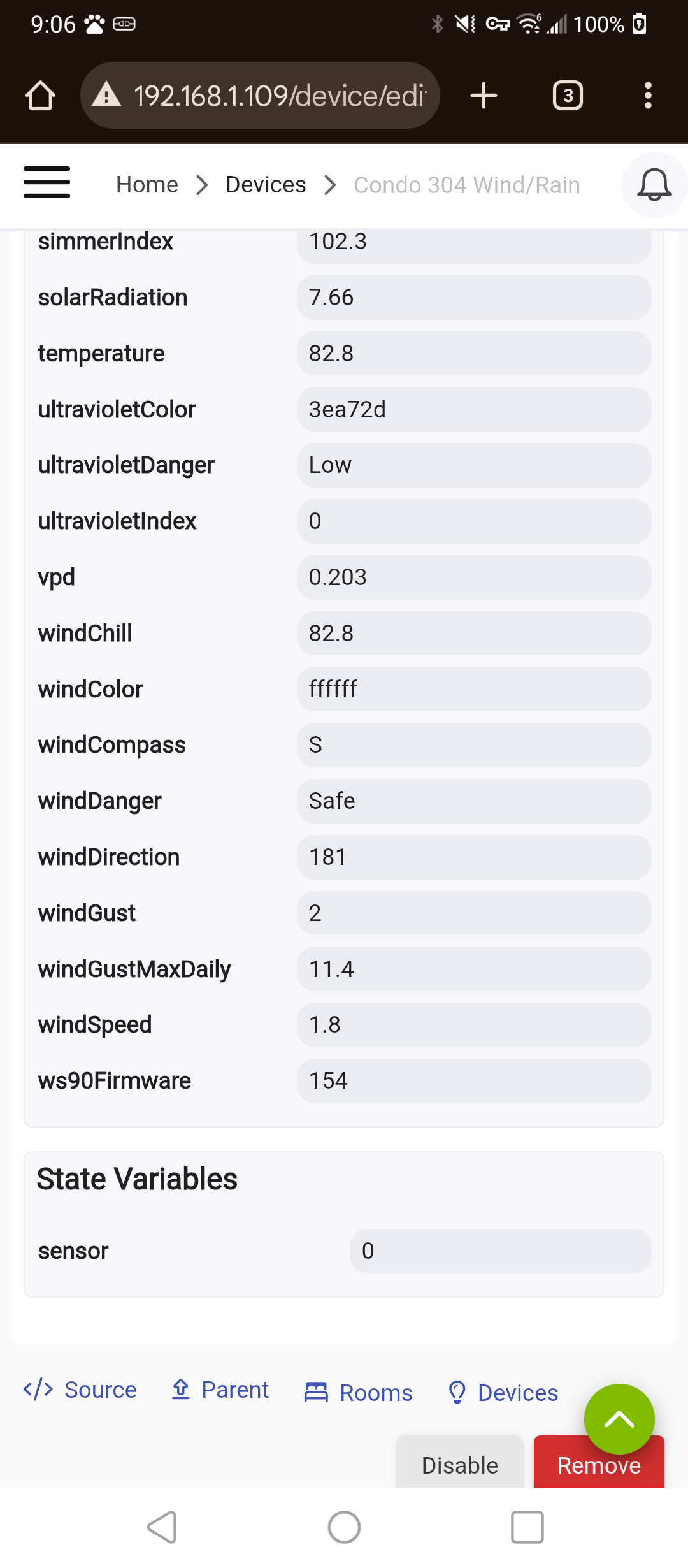

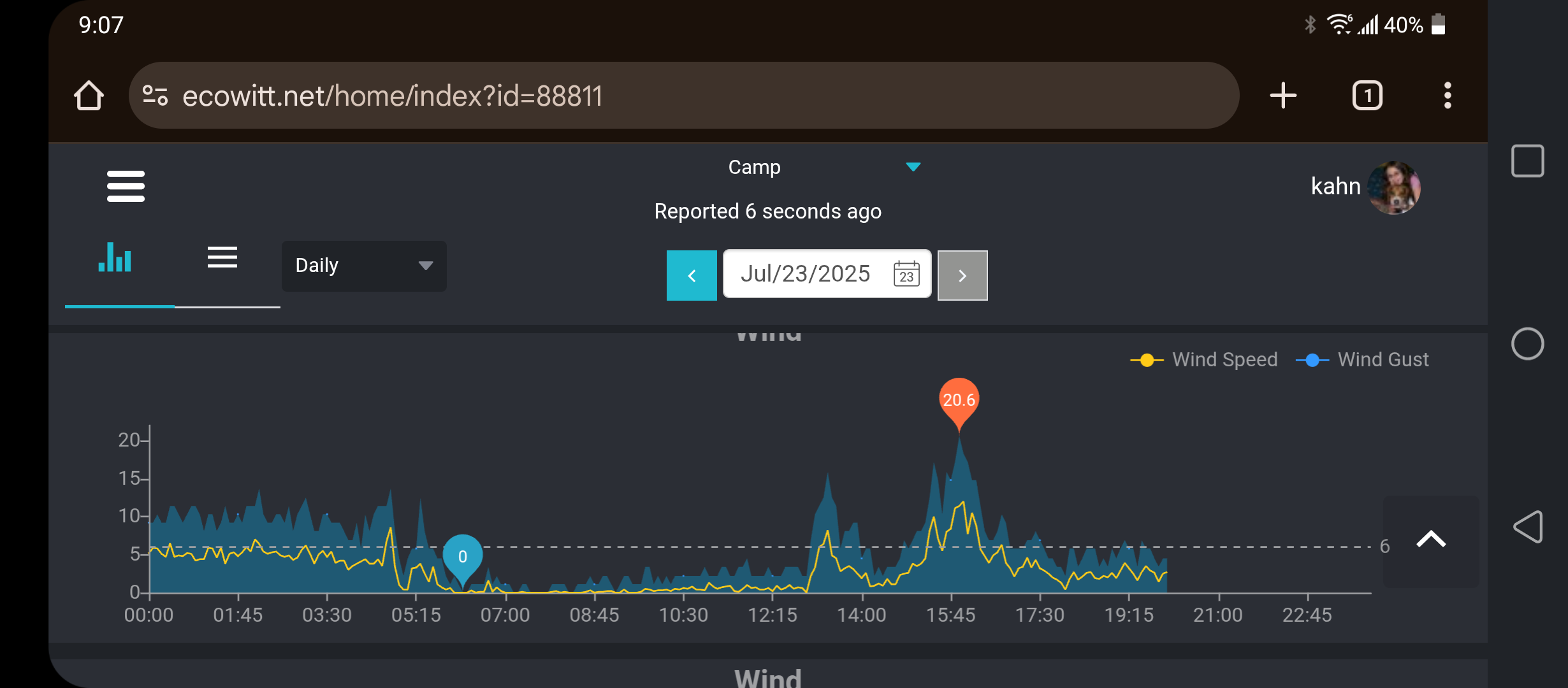

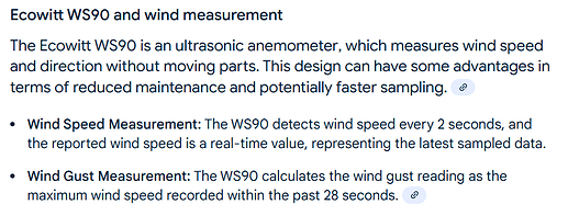

Windspeed does not drop to zero if there is any wind. See the graph. Wind gust does.
Sorry, but I'll need to look at this in a few days, when I have some more time.

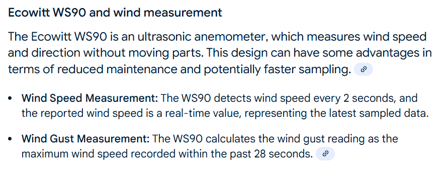

Thanks for the continued feedback! I found more info specific to the ecowitt WS90 sensor, see snap below. I think I'll be using windSpeed and windGust attributes based on this. Although I definitely would like to understand the windSpeed_avg_10m attribute too. Hopefully Simon can chime in over the next few days also.
I appreciate it Simon! This is turning out to be more challenging than I thought it would be (my whole shade automation setup).
There is no such attribute wind10m or whatever. Not in the attrs reported to hubitat nor in the.ecowitt aps. Not sure where u are seeing that.

I didn't find anything official to explain what that attribute represents, but the best I could find indicates that it is a 10 minute average wind speed, as you might expect. The reasons why some may see it and some may not is a little hard to be clear on, I wonder if it is a mix of the weather station or sensor model and/or the model of gateway being used.

In terms of your rule, I don't think an average is the best option for an automation, at least not that I can think of. As for the wind speed itself, or the gust.... I'd also be mindful of your update frequency, but I haven't read back through all of the previous conversation on that yet.

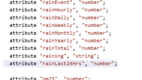

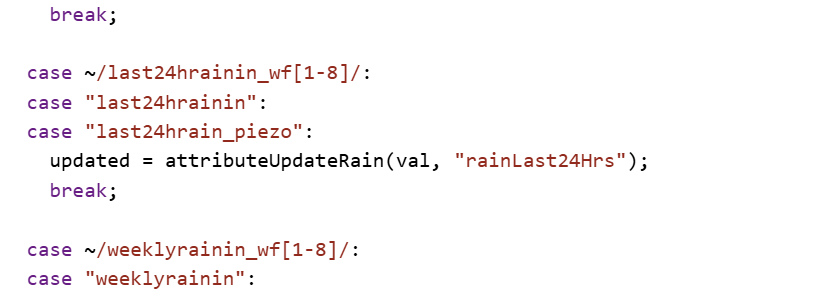

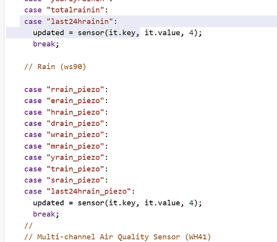

gw1100x firmware updated to 2.4.2 then 2.4.3 in last few days.
new attribute added last24hrainin and last24hrain_piezo
changes to gateway driver
changes to sensor driver

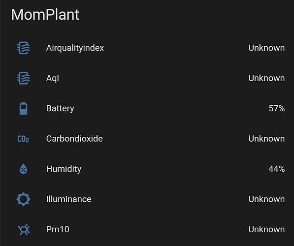

I have my Ecowitt sensors integrated into Hubitat and also forwarded through to Home Assistant for dashboard display. Today I updated HA to the latest core version and noticed my soil moisture sensors have become ‘unavailable’ in the Ecowitt HA service. All the other Ecowitt entities (I have 95 Ecowitt entities in total across 3 gateway devices passed through from Hubitat to HA) are still available and are updating fine. It’s just my 16 soil moisture sensors that have become unavailable since the HA core software update.
When I go into the entity settings in HA for any of the soil moisture sensors I get an error message stating “This entity is no longer being provided by the Ecowitt integration. If the entity is no longer in use, delete it in settings”
I’m sure this is a Home Assistant Ecowitt integration issue as everything seems to be working fine with all my Ecowitt sensors in Hubitat. Just wondering if anyone else who is also forwarding Ecowitt sensors from Hubitat to HA has also noticed this issue?

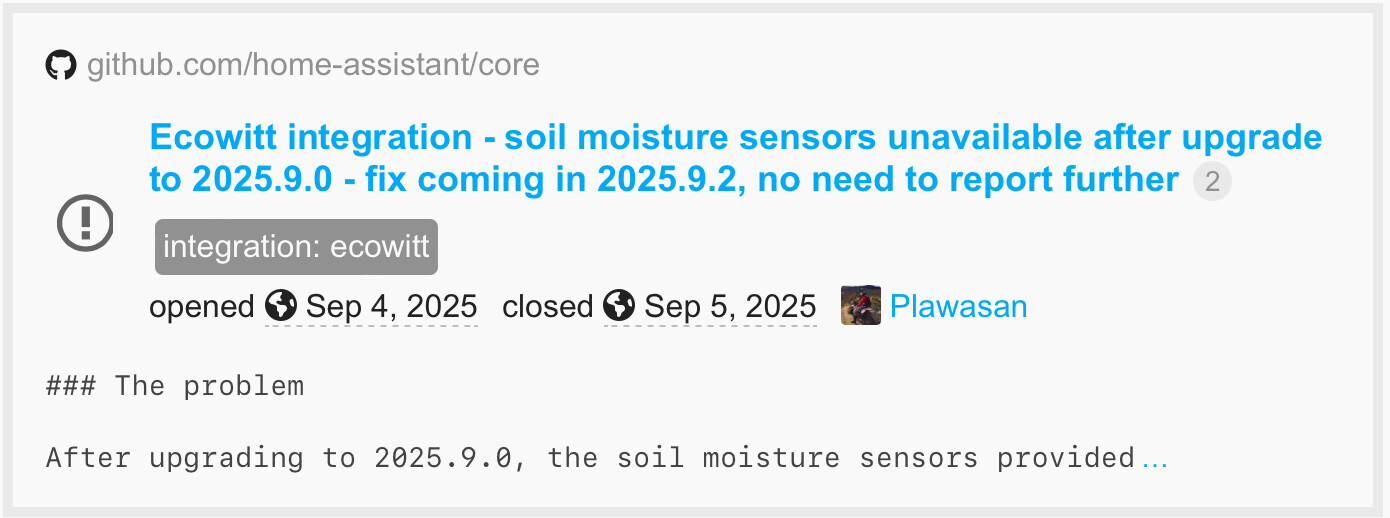

I don't actively use the feature, even though I introduced it, but I can take a look in the next few weeks if I get some time.
Thanks Simon for your quick response and kind offer to look further into the problem. I just found a status update on the HA forums confirming it is an HA issue and will be fixed in the next HA core software release, so no need to look further on the Hubitat side of the integration. Posting the update here to inform other Hubitat users that may be experiencing the same issue.

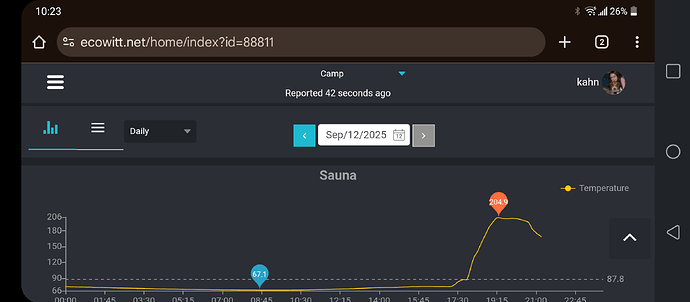

Summary

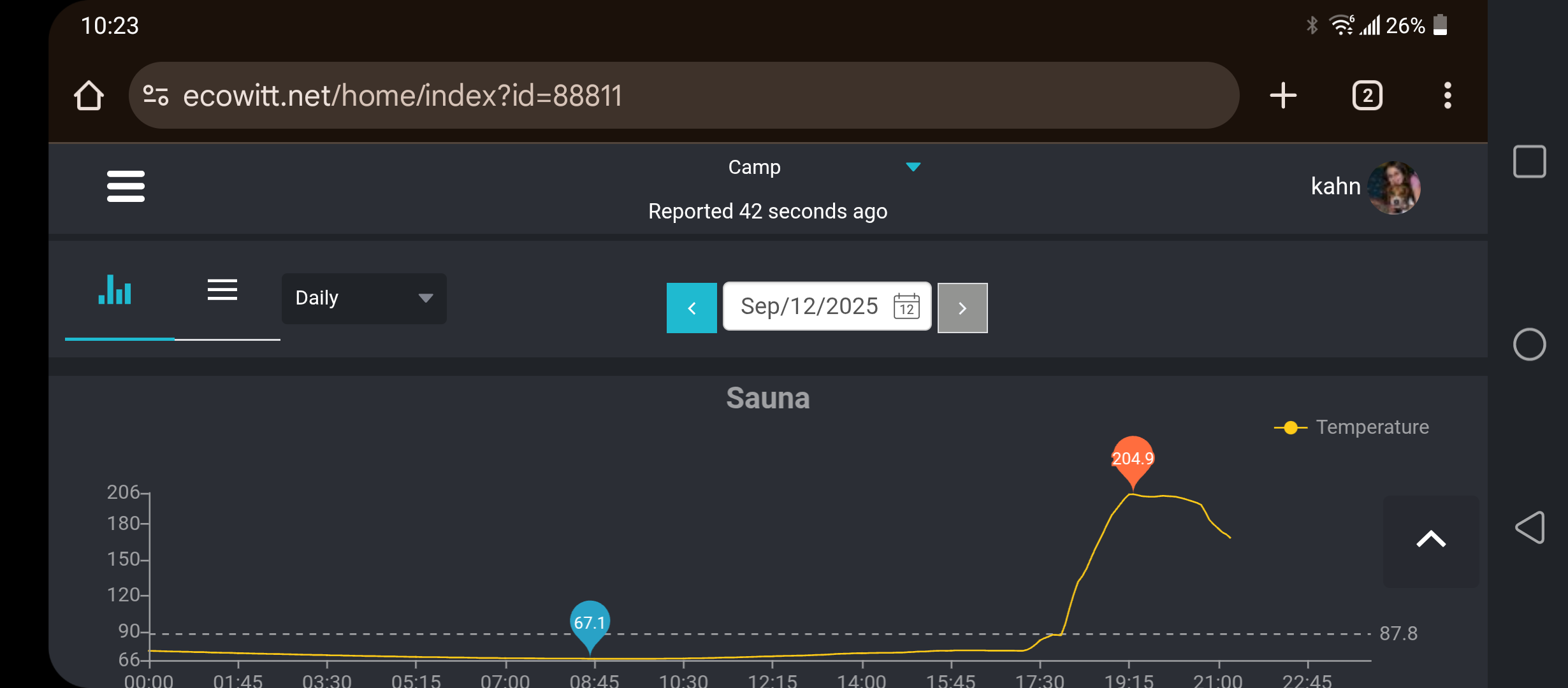

good sauna and stress test . thanks ecowitt
