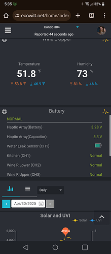

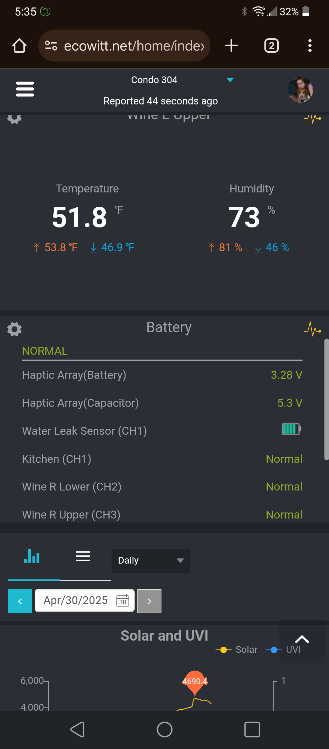

I have an Ecowitt WS90/GW200 Weather Station and I'm having an issue with the Solar Battery Reading (i.e., Haptic Array Capacitor)
The Ecowitt says it's currently at 5.3 V (5.4 V is 100%), while Hubitat (via this device) says it's 44% - which is not correct. I know that the two readings matched in the past. I've rebooted the weather station and the Ecowitt hub without any change.
Any suggestions?
Edit: All other readings are accurate.
The 5.3 is not the battery that is the capacitor. The battery is the batteryorg it should be around 3.3 for 100%.
This is my ws90

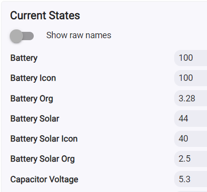

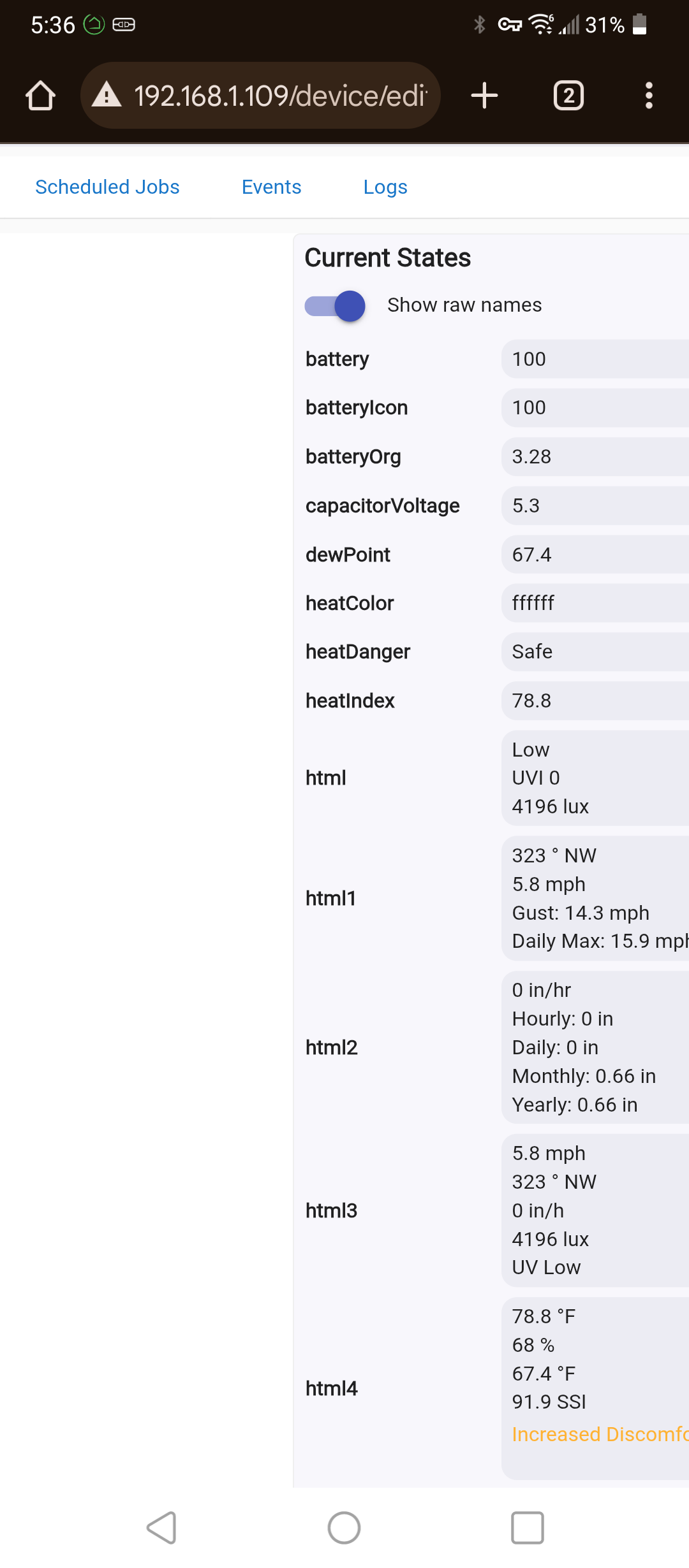

Thanks for your response. I'm sure I miscommunicated something. Here's my readings:
Ecowitt
Hubitat Device
Now, looking at my figures again, I'm perhaps still messed up.
Interesting i dont have those attributes but for you it definately looks wrong. The approach also seems wrong as you cannot really assert a battery percentage to a solar capacitor as it depends on sunlight strength and will fluctuate accordingly?
That is why i did not implement it when i coded ws90 changes. It looks like someone in the current release further changed it? @sburke781
I'll take a look
I'm a little more confused now.... :slight_smile: Or it could just be the time of night... Feel free to PM me if you want to chat about it some more that way...
The first entry for ws90cap_volt would produce the Capacitor Voltage attribute reading of 5.3, but I then can't see how the later ws80 and ws90 capacitor voltage case statements would get triggered...., which I expect are the only parts that would produce the solar attributes.... With the 2.5 solar voltage reading also being odd... Will keep looking at it, including timing of changes to the code and whether that could be at play....
