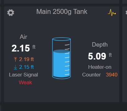

I have the LDS on my water tanks.

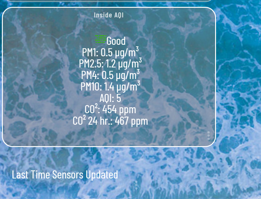

In addition to the snow depth or straight depth and percent full for the laser density it has support for the new wh46 sensor.
This new sensor in addition to measuring particulate matter less than 2.5 and 10 microns
also measures pm1 and pm4. (less than 1 and and 4 microns respsectively)
So these new attributes are added.. I also noticed i never reported raw pm25 and pm10 previously these numbers are only used to go into the aqi calculation.
This has not changed as the aqi calculation still onoly uses either pm25 or pm10.
The routine has and does take the best aqi if the sensor (wh41 and wh45 do) measures both.

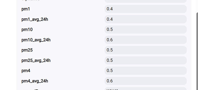

so to summarize i also added pm1, p1_avg_24h, pm4, pm4_avg_24h, pm25, pm25_avg_24h, and finally pm10 and pm10_avg_24h new attributes.
and a new template entry shown below (14) for these attributes.. the template file needs to be uploaded to you hub file the settings/file interface.

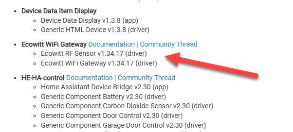

There's 2 Drivers that I know of:
-- The one maintained by sburke781. I've been using this one for a couple years and its works fine. It does not have some of the more recent Ecowitt sensors Yet but updates on they way.
--The other maintained by kahn-hubitat. This one has all the latest sensors including the LDS and I loaded the driver to take a look. Its a bit more complicated so haven't committed to it yet. Still checking it out.
Each have 2 drivers to load and both named; "Ecowitt WiFi Gateway" Parent and "Ecowitt RF Sensor" Child

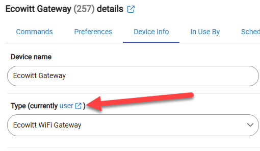

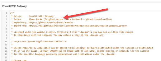

I think the first thing to do is to work out what drivers you are using.
  • Open up the Device page for the gateway on your HE hub
  • Open the Device Info tab
  • Next to the "Type", click on the "User" link to open the driver code
  • Check the details at the top of the driver to see if they look like this, indicating that it is my drivers you are using
You can also get a listing of the Apps and Drivers in HPM, but I think it is best to go to the device so you know exactly which driver is used by the device.
