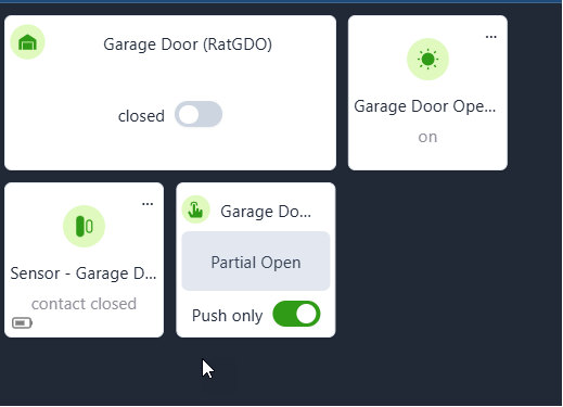

Just wanted to post a special thanks to @mitchjs for his awesome RatGDO driver. It's super simple - just install the custom firmware using the web interface, install the custom driver, put the IP of the device into the preferences field, and it works like a champ. SO much easier than monkeying around with HADB and other roundabout ways of connecting these.
The other cool thing is that it includes the ability to crack a door. We don't have a man-door in our garage, so it allows me to crack a door to let the cat in and out.
Here are the instructions he sent me, which worked like a charm:
