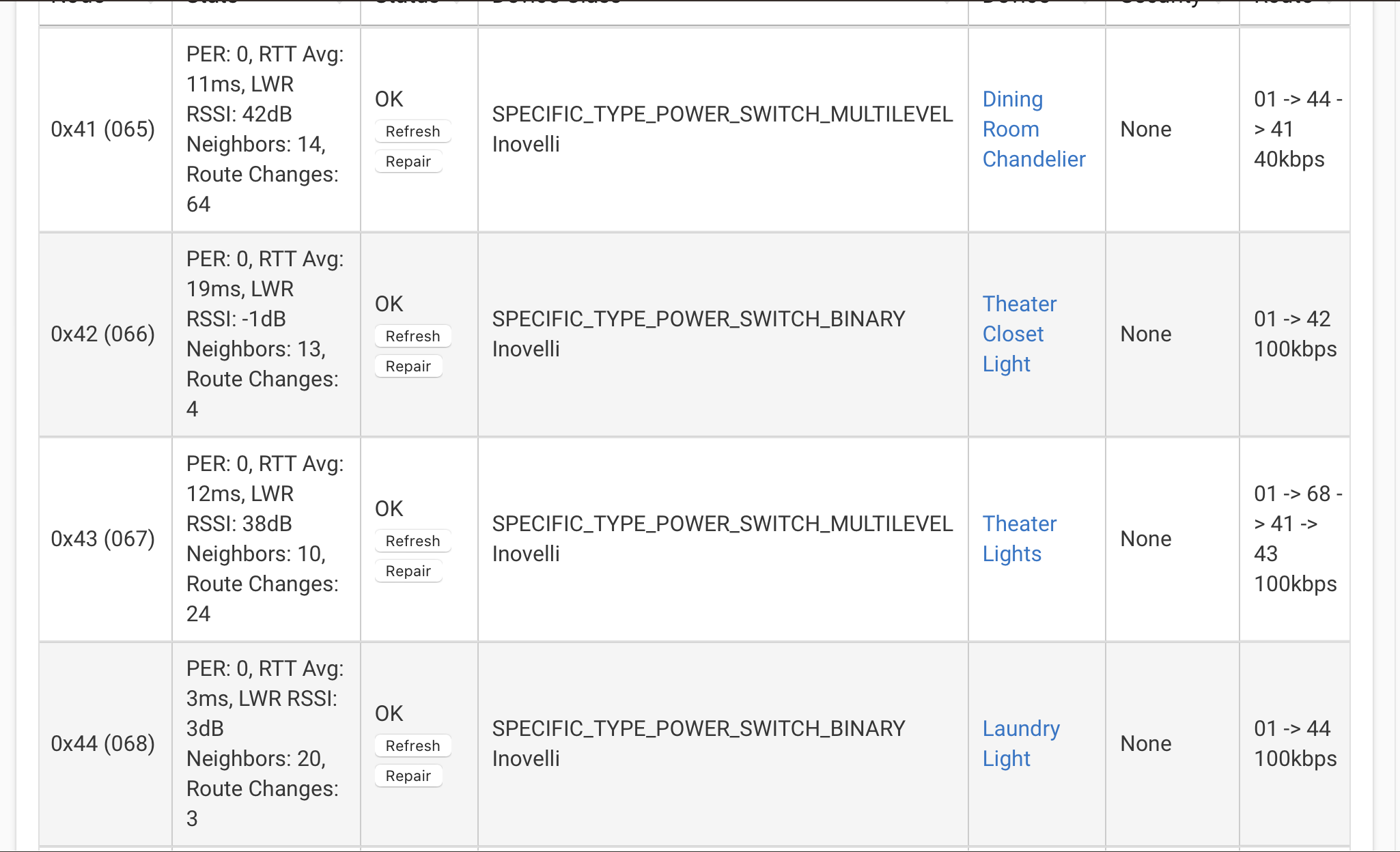

Rate my Z-wave Mesh, seems bad to me

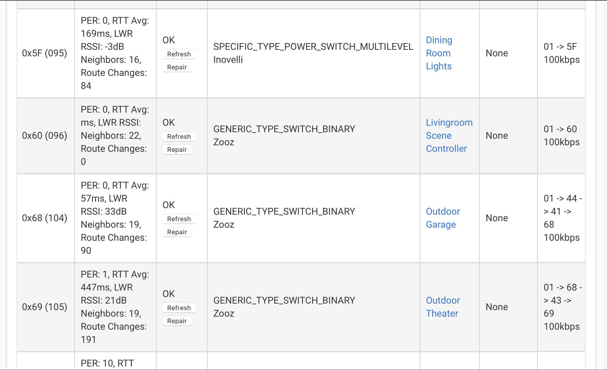

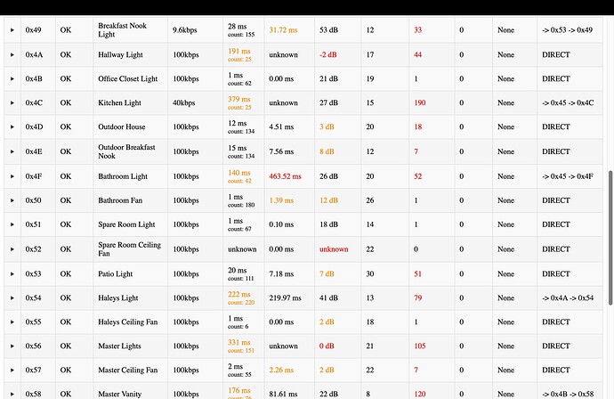

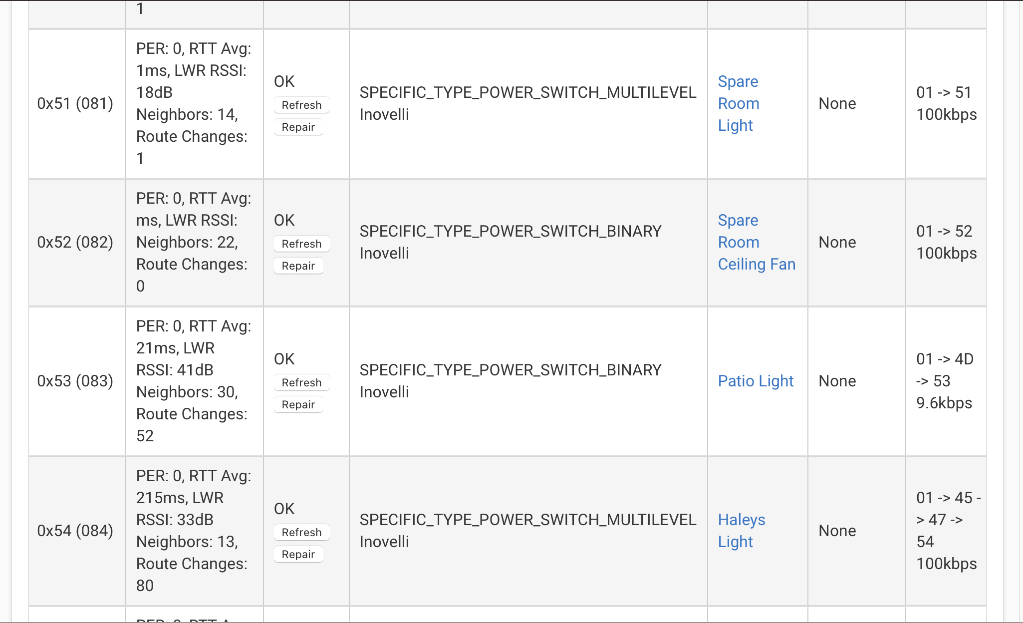

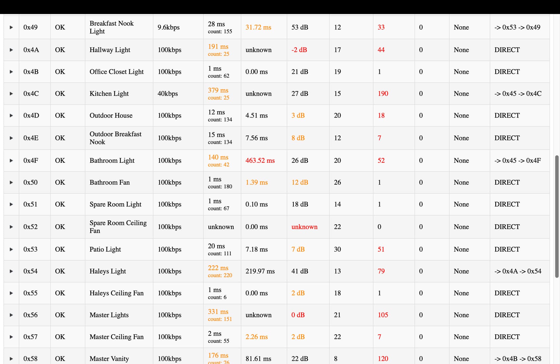

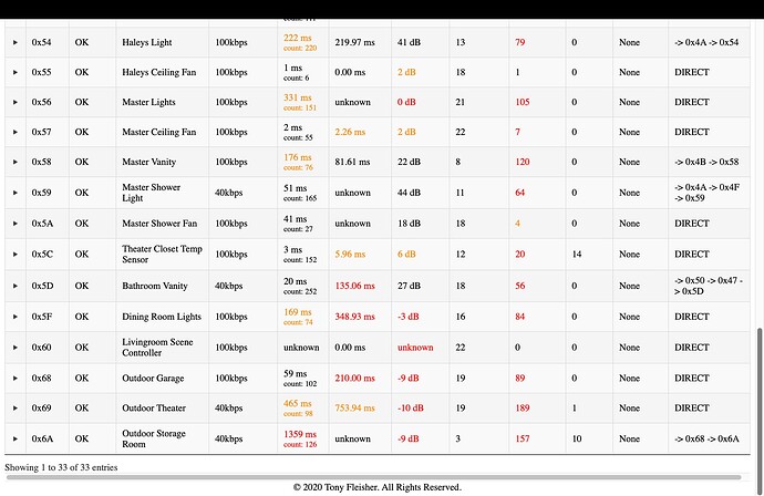

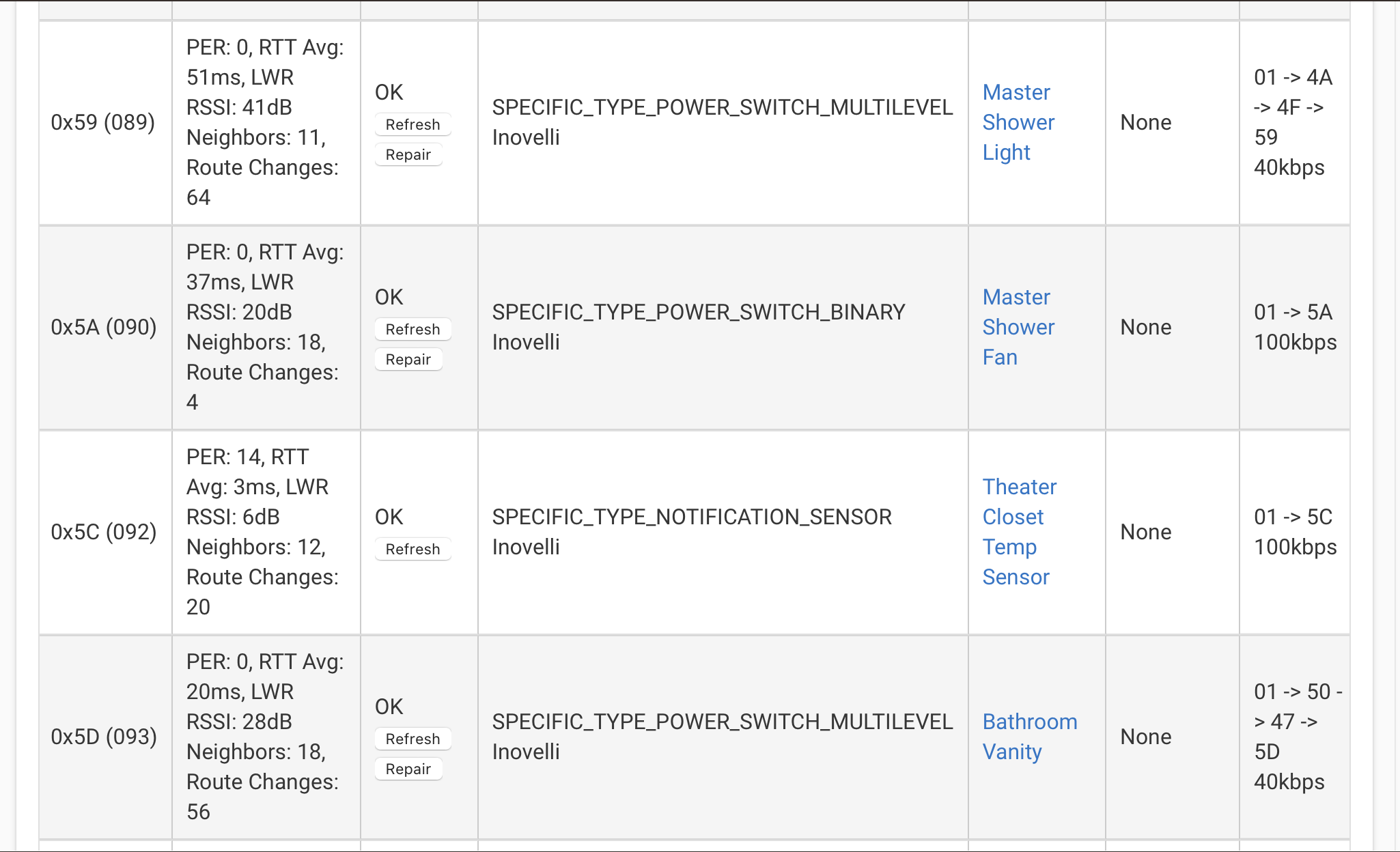

I see a lot of red and a lot of latency. Does this look normal? Every single hard wired light switch in my house is an inovelli red or black, with 3 or 4 zoos switches. This network has existed for a couple years now and all switches have latest firmware. Most of the time everything is fine. But occasionally randomly something might take 5-10 seconds to respond. I've mostly gotten around this with delays and it seems like more than 5-6 devices at a time will really cause some problems. But sometimes a single device command will get delayed as well. So what do I do? I can't imagine I could create a better mesh considering every switch is z-wave so nothing is further than a few feet from another one. House is typical stick frame and drywall. The motion sensors that trigger everything are NYCE zigbee.

Seems like an excessive number of route changes. Thats where your problem starts.

c7, hubs been up a week or 2 I think. boxes are all plastic.

So anyway... a lot of the issues fixed had to do with routing, what I see in your mesh lead me to think you had not done the update yet.
After it updates I would power off the hub for 10 seconds and then restart, this will allow the radio to fully reboot. You may want to run a full z-wave repair (once) after that as well to help speed up the mesh heal. I suspect you will see much better performance going forward.

Hmm, you have an inoordinate amount of route changes which usually means a weak mesh. I mean your 0x49 switch should be minimum 40 (best is 100) but it's at 9.6. I'm trying to figure out where the blockages are coming from since you have a lot of mains based things.
