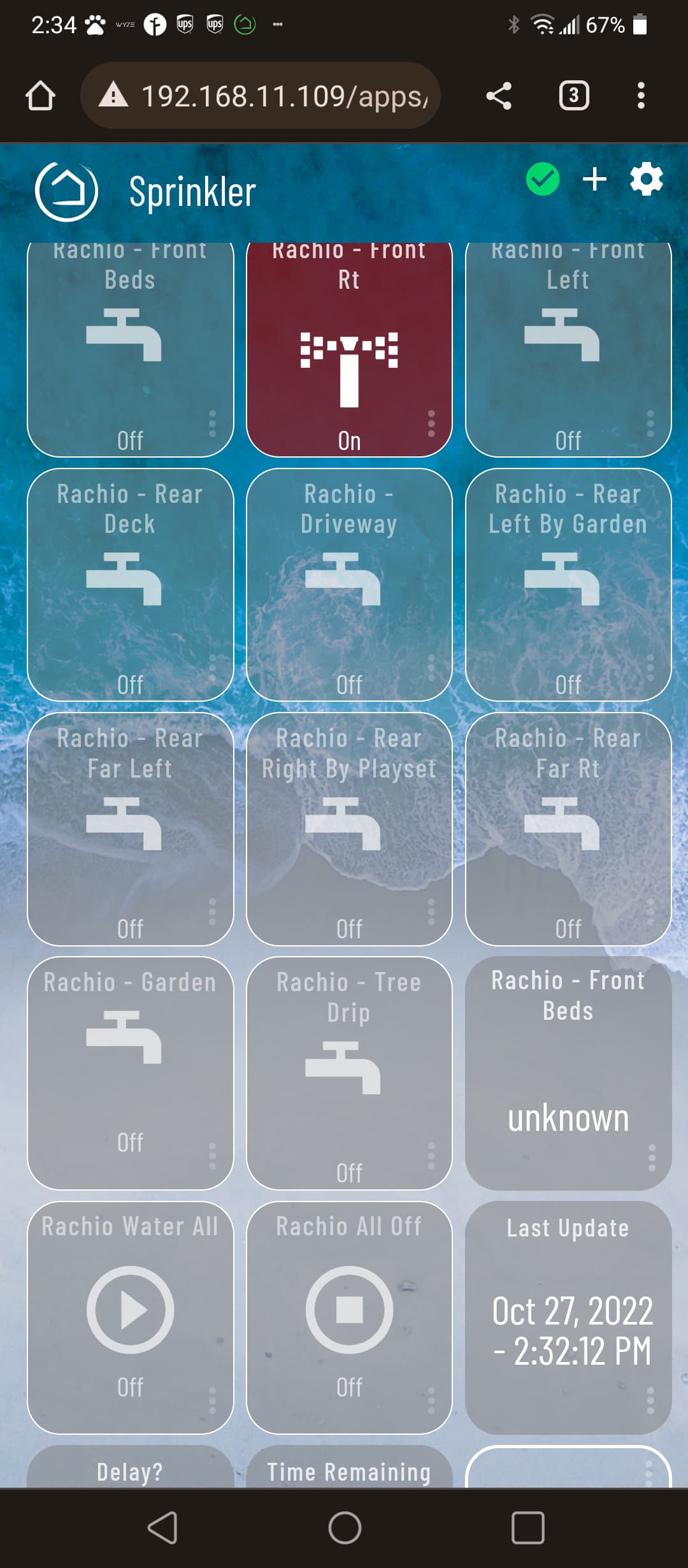

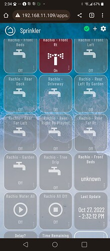

just spent like 45 minutes debugging why i couldnt get zones to turn on with my rachio dashboard to blow out sprinkers..
fffricking rain sensor was still on even though sunny today after 3 days of rain..
guess i need to add the sensor status to my dashboard lol
no attribute for that.. that is a bug.. there is a rain delay but that is for weather rain delays.. why not attribute for rain sensor triggered?
