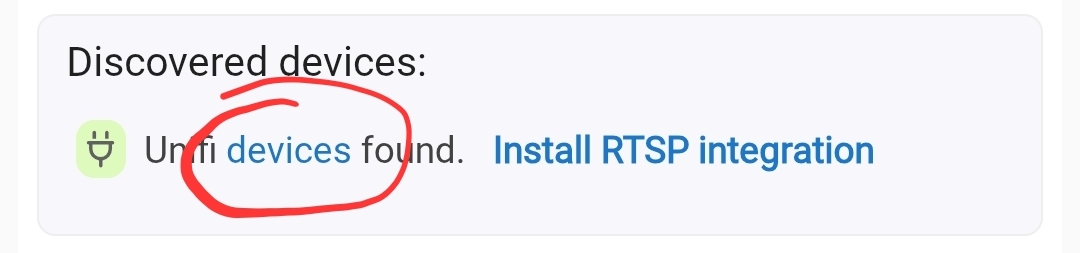

I just noticed in add devices that it said RSTP cameras were available. Showed 2 IP address's.
I have no idea what those are? They don't match any of my cameras. I tried adding one and created an ez dashboard but it doesn't show anything. How does the HUB detect these?
It's using mDNS protocol.
If you click on "devices" link, it should tell you the device names:
Just shows RSTP camera and IP address. No big deal just curious.
If you’re curious, your router’s UI might be the next place to check what’s using those two IP addresses.
