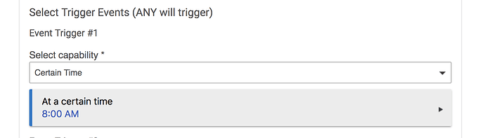

As @cuboy29 suggests, use a Trigger instead of a rule, if what you want is to just set it to 74 at 8:00 am. The trigger event is called Certain Time. That would run every day at that time.
Certain Time setting:
Main trigger screenshot:
