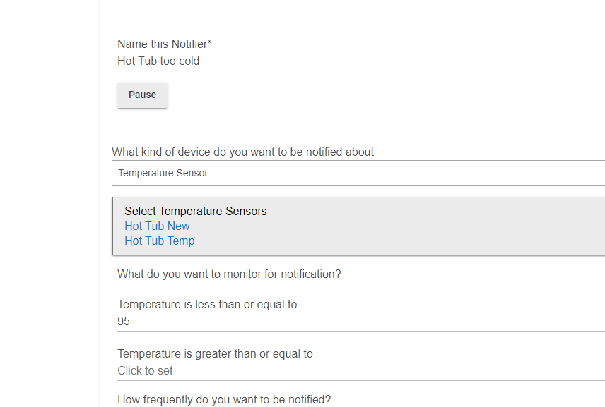

Weird it says nothing on the page when you select multiple sensors..,
Does it do an "OR" or an "AND" .. there should be an option or something that tells you.
I want an OR as these sensors are prone to fail.
thanks

Pretty sure these are an OR. I have notifications set up for multiple locks and I get an alert if either of them is left unlocked over the threshold time.
it works as OR. i set up notifications based on time, and placed multiple sensors in there. then i have it send the alert "%device% is open" so i know which one it is
Out of curiosity, if.2 are open at that time does it only send notification for one of them?
I have a notification setup for my two garage doors if they are open more than a set amount of time. If either one is open I get the notification with the correct door name. If both are open I only get the notification for one of them. That's OK in this case because it let's me know to check them if needed.
