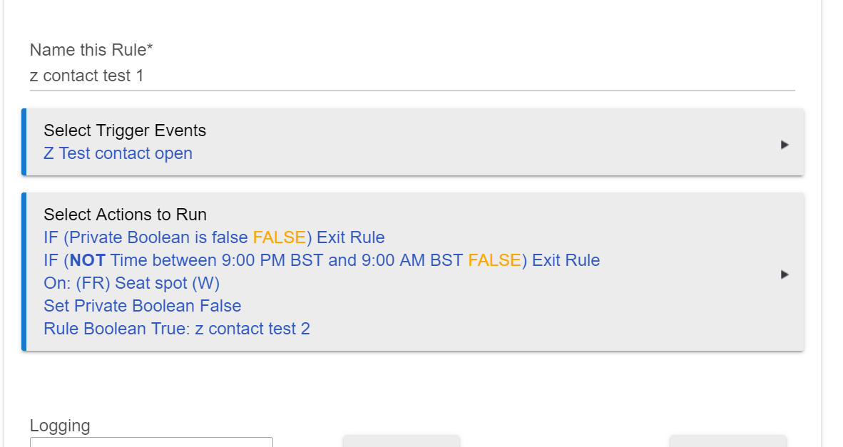

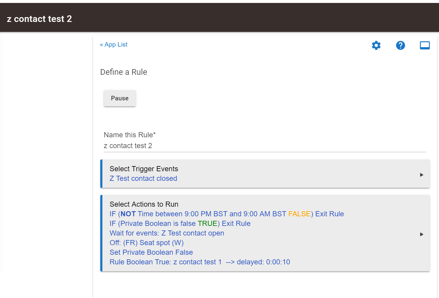

I think it could be done but with 2 rules 1st rule would turn it on flip the private Boolean of this rule and the other. Then the other would exit if the PB was false and if true turn off light and flip the other rules PB.
So essentially only one could run at a time and each time it runs, it disables it's rule for the next run and enables the other. Then visa versa, this way door open would turn on light then door open would turn off light. Hopefully you get it from that but If you need a example your have to wait until tomorrow as in bed :laughing:.

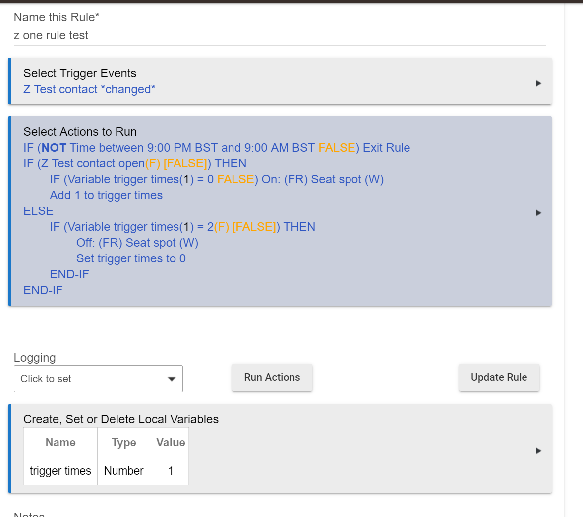

Not exactly your setup but I think you could use the same idea for what you are wanting using a Global Variable. You first check to see if the variable is True and then you can act on it if it is. If it is Not true, this is your first run through your logic. Your starting If statement will be to turn off the lights if it is true. This is skipped when opening the door the first time but sets it to true. Then when you open the door the second time, the variable is true so you turn off the lights and set the variable back to false.
In my example, the Variable name is "Front Door Motion". Hopefully you can follow my logic. In my case, I only want to hear that someone is at the front door once within a 5 minute period. You would just use the Variable logic out of my example. :slight_smile:

@bikesquid as alway @bravenel was right it wasn't easy as i thought and it did create a race condition that the 2nd rule fired straight away which i wasn't expecting. But i do i have it (was determined too), see below rules.
Rule 1 turns on the light and enables the 2nd.
rule 2 fires on the close and is now "prepped"
after the door closes again it will exit straight away so we all good. Then next open after 10 seconds will start the sequence again.
The 10 seconds is really important and during that time if you trigger again both rules are shut down so nothing will happen they will just exit :slight_smile:
or in one rule, but it works on the 2nd close.
This last example @BorrisTheCat is what I thought you were getting to in your first post! See, sometimes a failure to communicate is a good thing?!
