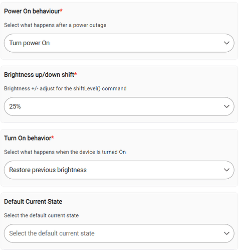

Some Zigbee bulbs, for example the ones from IKEA, have certain properties under the Preferences tab that are not present for Generic bulbs.
Examples: "Power On Behavior" and "Turn On Behavior". (screenshot below).
Are these properties in the firmware of the bulb itself, or is this something that has been added through functionality in Hubitat?

The power on behavior is part of the IKEA bulbs firmware. The good news is that the Zigbee specification already contains the scenario you are looking for, and I believe that IKEA also implemented it in the firmware (with very few exceptions, IKEA did an excellent job in staying true to the Zigbee specs).
I did not include this option in the drivers cause I did not see a use case for it. I'll test and add it when I get a bit of free time.
