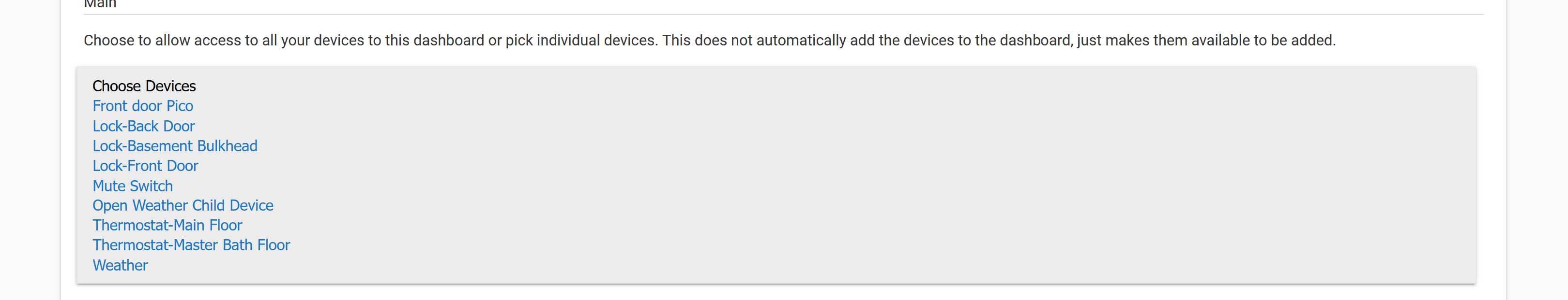

Right but you have ALL of them exposed to the dashboard and everytime you open the dash, even if you don't have a tile for the device it's rendered for availability. What @neonturbo is saying if you only have lets say 10 devices for a particular dash, ONLY expose those 10 devices, DO NOT hit select all. For instance, this dash only has a few devices. ONLY those devices are exposed
