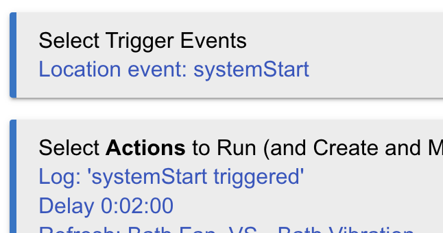

I use a 2-minute delay, and that's always worked well for me. Maybe I could shorten that, but I'm too lazy to experiment.
I also have a Log line as my first action -- that gives me a warm fuzzy knowing it all triggered properly and could assist me with fine-tuning the delay in the future (if I ever get motivated to do so).
Screenshot 2025-06-27 at 12.37.51
