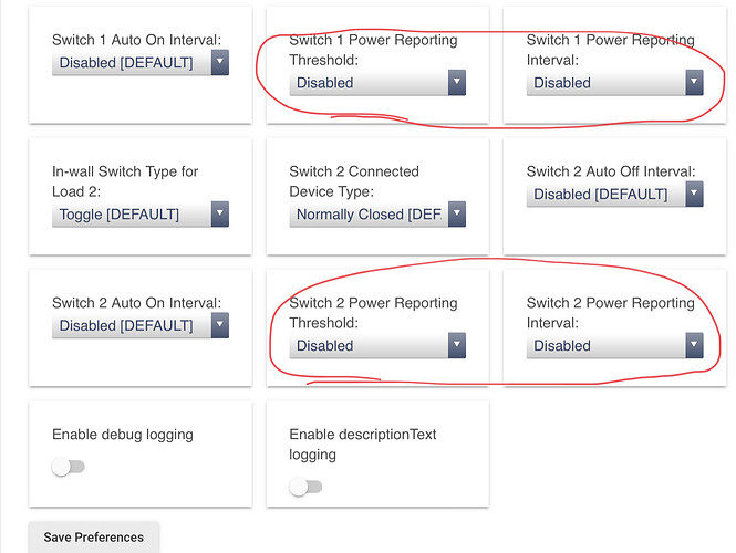

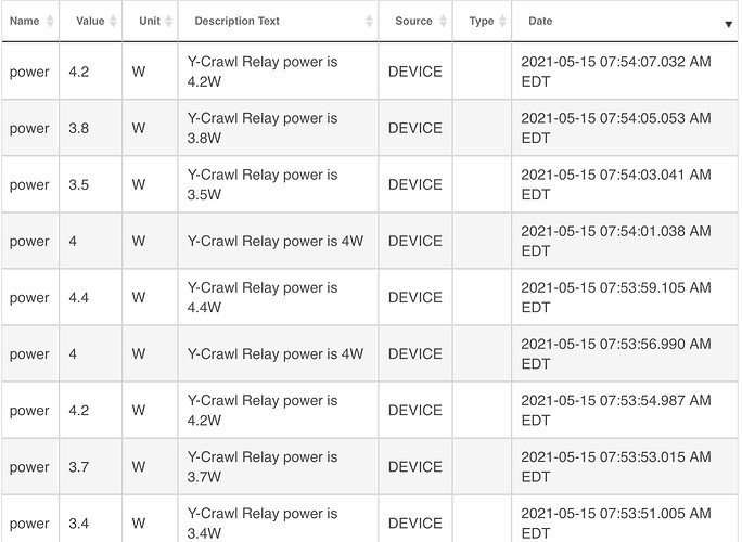

@mike.maxwell @bcopeland I recently repurposed a Qubino Flush 2 Relay where the child switches/relays are mostly on and noticed that power reporting events are firing even though I have them turned off in preferences. Unsure if it’s a driver issue so I wanted you to be aware.
For any Flush 2 users out there -- is this power-related spamming still an issue with the Flush 2?
I'd like to use one for a project I have in mind, but this power-spam bug would be a show-stopper (I have no need for any power reporting, so I'd disable all of that just like ritchierich's screenshots above).

I have had one in service for 4 or so years dating back to my ST days. I really lost confidence in them when I had to exclude them from the mesh. They are the worst to get into exclusion and inclusion mode. This relay runs my recirculating pump in my hot water heater with temp reporting so I really don’t like it spamming my Zwave network with temp updates. Eventually I will replace it with an Arduino since it’s in my crawl space with no space issues in an electrical box.
