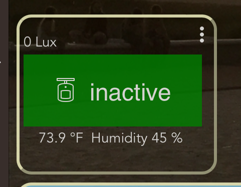

This is a custom template using the Tile Template Device Manager for an Inovelli 4in1, could have added the battery but chose not to.
PNG image
As for room, it wouldn’t be too hard to add a special attribute function for it.
Edit: v0.0.5 now allows for the use of <%@room%> attribute

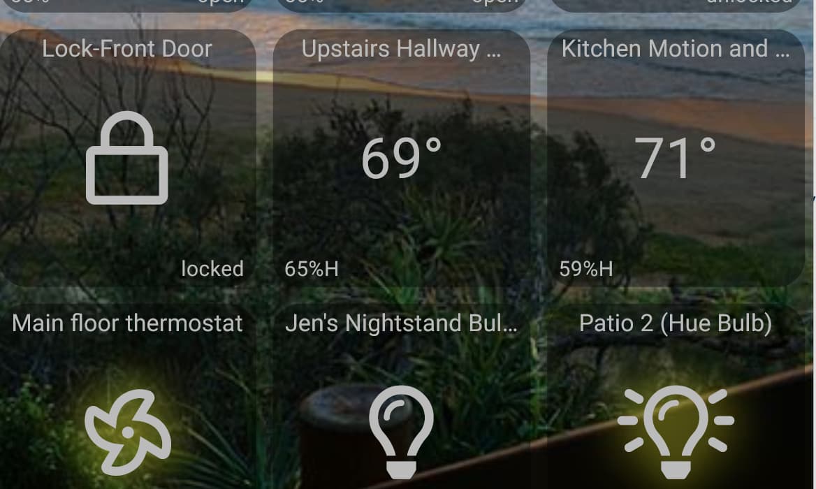

There is also @gslender 's Hubivue dashboard. You can see it at www.hubivue.com which also allows multiple attributes on their tiles (works for apple, android, and windows. I only did temp and humidity but I can add more
