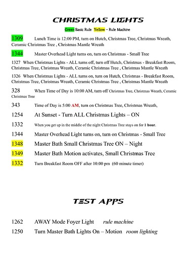

I would like to make a rule that only makes my Christmas rules to be active/run November 1 through December 31. Not sure if this is possible.
  • Some rules are Basic Rule and some are in Rule Machine.
  • I highlighted some. Yellow= RM Green= BR
  • I was hoping that I do not have to go into each rule and make changes.
  • NOT sure if this is forbidden? Can I pay someone to write a rule for me?
  • All I would need is some good screenshots.
  • If this can only be done with RM rule - I can just convert all the BR to RM

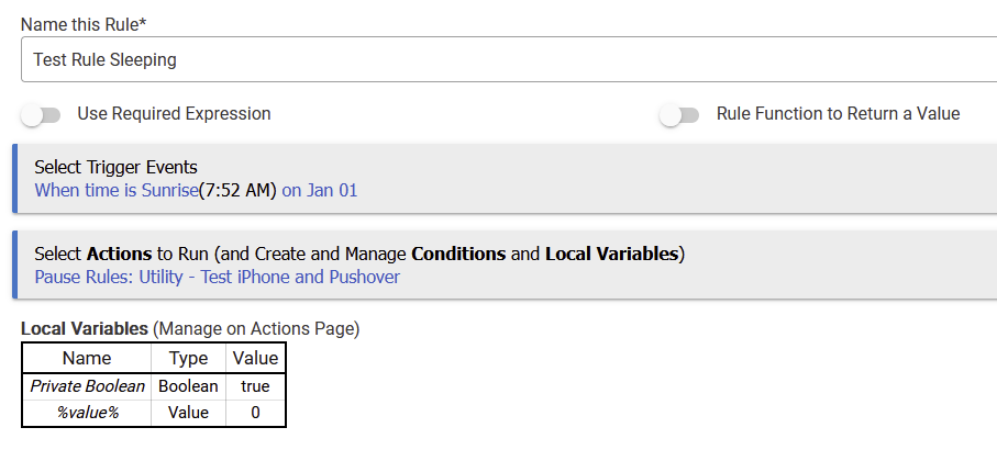

Use 2 rules, one to resume rules on Nov. 1 and one to pause rules on Jan. 1. Here's an example of the pause rule. It should work to pause Basic Rules as well as Rule Machine rules.

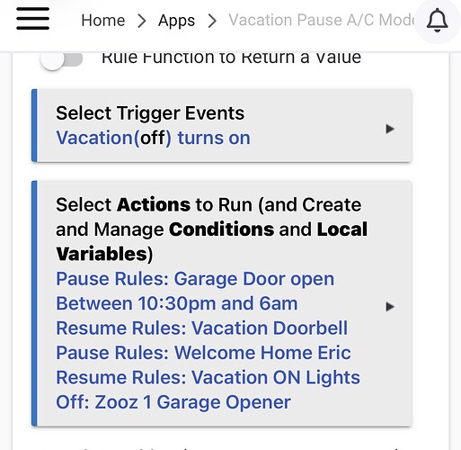

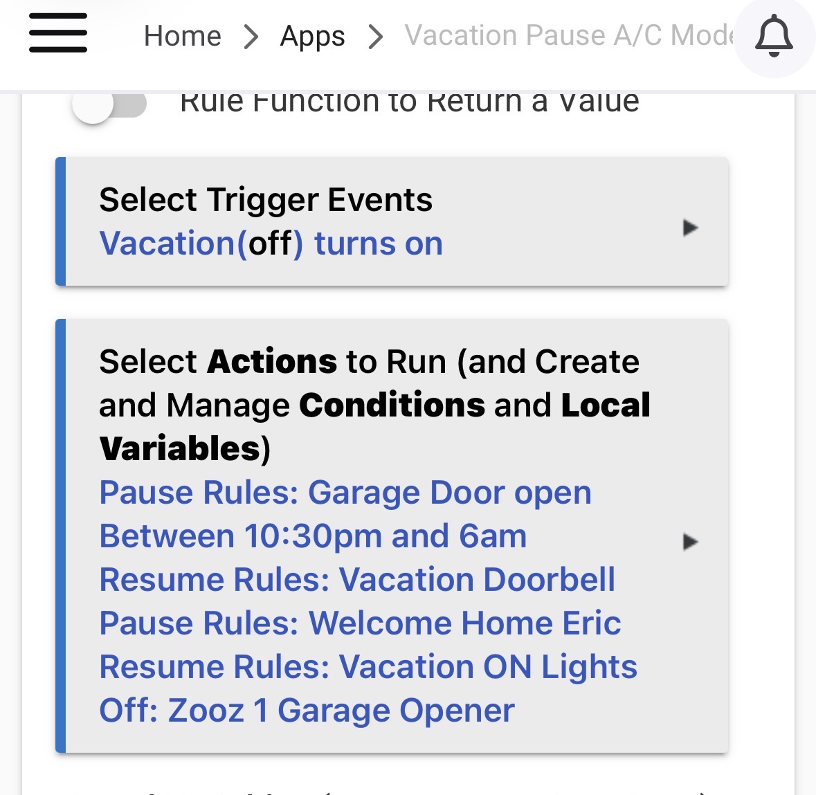

I use virtual switch to pause and resume groups of rules. I do this for holidays and vacations. Turn on the Christmas switch and it will pause some rules and resume others. Turn it off and it does the reverse.

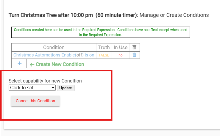

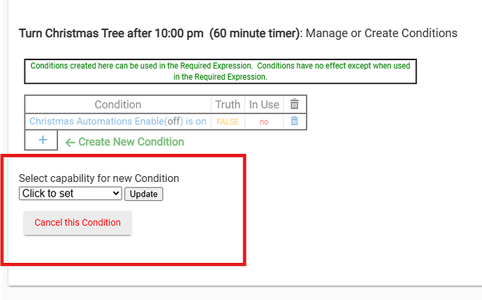

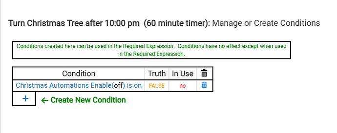

This is in Basic Rule. In Rule Machine, you'd add the switch being on as a required expression instead (or find some other way to do this -- there are many -- but that is the most analogous).
I was able to get it to work perfectly in BR but I can not figure out the rest of the rule in
RM. This is where I need the help.
What should I select here?
Thank You!! Love screenshots so helpful now.
Switch, because you are looking to create a required expression with a device that uses that capability.
