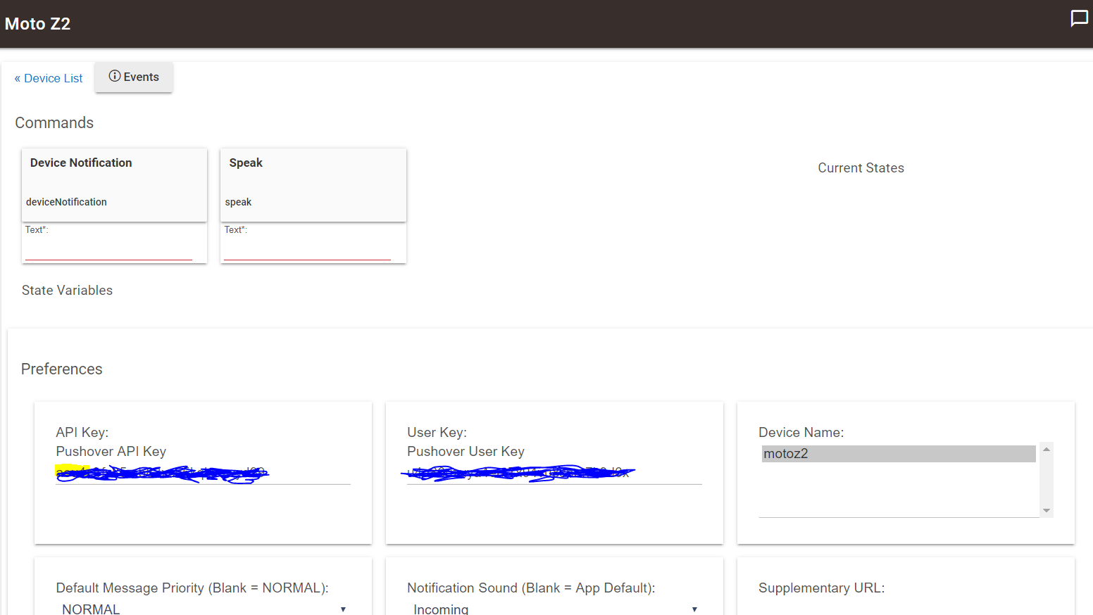

I click on the error and it brings me to 'Devices' I never touched anything in there. The top two boxes under COMMANDS for Device notifications, the Text and Speak are blank. I also added my API Key and User Key for Pushover. Am I doing something wrong, do I have to fill in something there? Any help would be greatly appreciated.

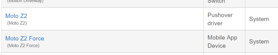

Truly appreciated you trying to help! I have my phone listed in DEVICES as your screen print shows on your Moto Z2 Force and type device being Mobile App device, but I don't have one like your first example with Pushover driver
The device you said you entered in your API key and User Key should have that Pushover driver listed in your devices?
The first device is for pushover (Moto Z2)
The second device is for the mobile app (Moto Z2 Force)
Thats exactly how my Device list shows how I filled in the user spaces with the API Key, User Key and Device name is my phone name.
That is the section that pops up when I click on the red error message in my logs
When you are in the device setting page for the pushover device, have you tried putting some text into the textbox and clicking ‘speak’?
If you get that text on your phone then it is the app which is wrong not the device.
It’s the easiest way to tell if the device itself is working.

I just put a phrase in the "Speak" section hit enter and my phone came up with Pushover and a TEXT I had just put in not a voice message. So theres something in the app I have to correct? Really APPRECIATE your help
