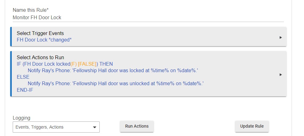

I cannot get push notifications from the mobile app via Rule Machine. I have checked Android settings for notifications and have also selected the device for Rule Machine notifications ... really don't know what else to do at this point. Run Actions produces the appropriate log entry but no notification.
Does it work if you go to the device's page in the admin UI and try sending a notification yourself? (I mean the mobile app device for your phone.) This would eliminate Rule Machine as a problem, which it doesn't look like it should be from above.
Nope, I still do not get any notification.
