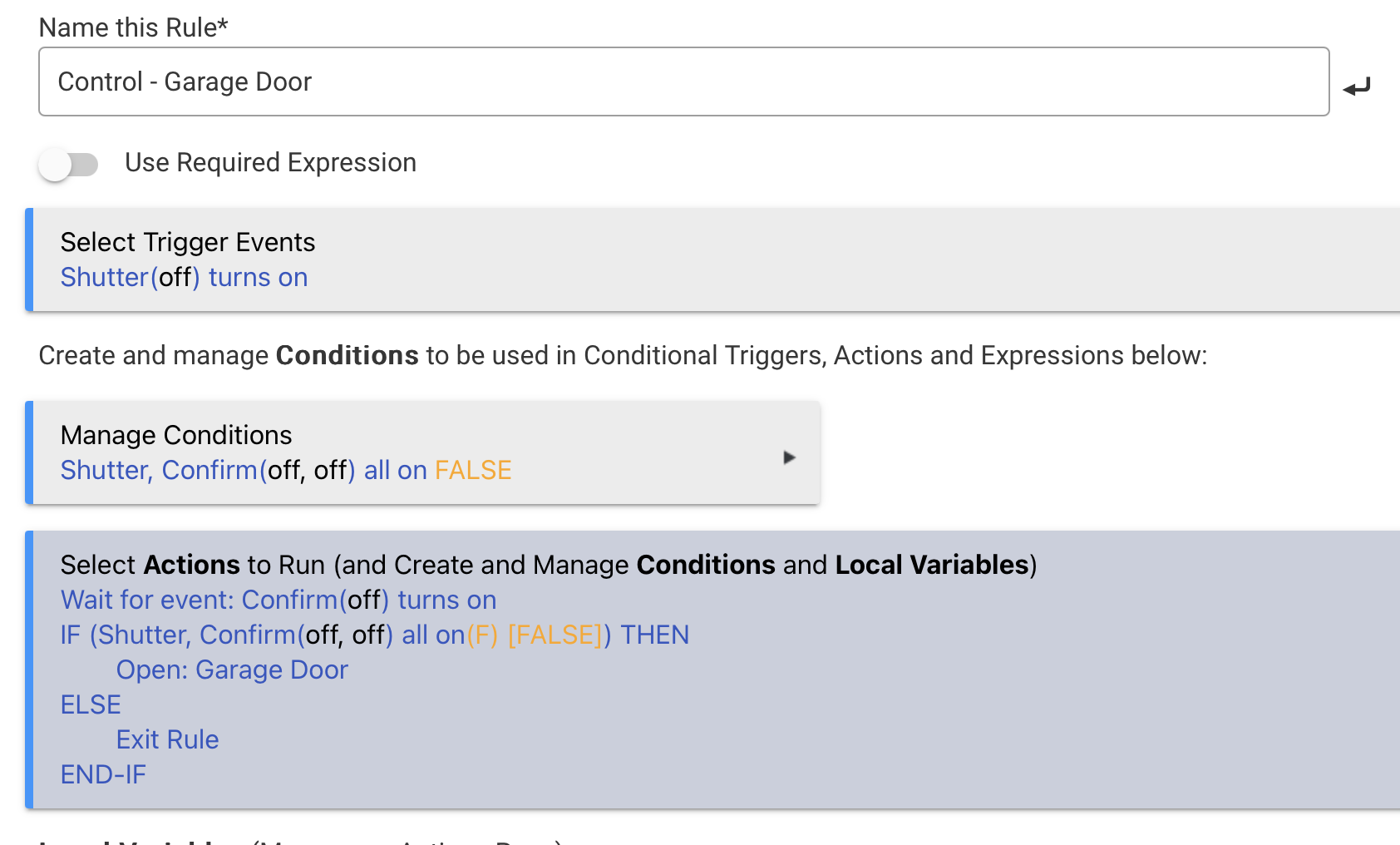

I did that with two virtual switches with auto off. I use it on my dashboard for the garage door which I'm paranoid about being opened accidentally. I did this rule:
Once the 'Shutter' button is pressed triggering the rule, the 'confirm' has to be pressed before it switches off (auto off is set in the virtual switch to 5 seconds) otherwise the rule exits.
Thats a really good idea, and then have it automatically turn off when the rule runs.

I like it better than push and hold. I'm going to give it a try.
