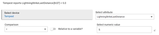

That is the same as mine with one exception. I am using the < comparator, not <=. Though it seems improbable that it would work in one case and not the other, perhaps that will work. Stranger things have happened in RM. I will give it a try. We might get rain this afternoon, so I hope I will be able to test it.

I have no idea why it would be treating LightningStrikeLastDistance as a String EVER. It is specifically defined in the attributes as a Number, both for the WeatherFlow parent AND for the WeatherSensorChild drivers. I checked the code and it is pulling in either the it.value (which should be a number only) OR (if you are not using metric) converting it to miles in which case the value returned is defined as a double. Would yours be Metric or Imperial for measurement?
I just created a rule to test it and am not getting an error. Using my C8Pro with the latest beta firmware.
LightningStrikeRule

I am imperial. The error I posted above does mention something about double conversion. Just an observation.

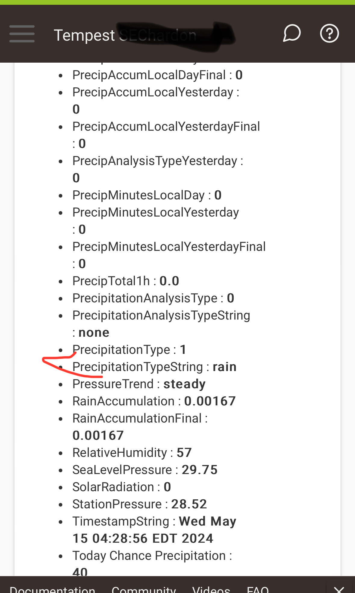

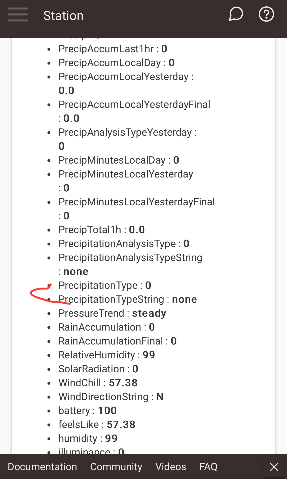

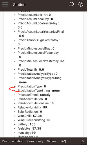

Just noticed an aberration within the unit for accuracy. The Station (child) shows PrecipitationType=0 and PrecipitationTypeString:none. However, the parent weatherflow (my case = Tempest) shows the type=1 and the string as rain.
I don't understand why, and don't know how to sync them, if it is possible, and which one should be trusted.

Unfortunately I do NOT have a good explanation. The child device is sent the exact same values the line right after the parent is set.
Do their State Variables match their Current States? I have found cases where things can get out of sync... Because there are so many data points in these, my drivers check the current value of the State before writing an Event, just to make sure it has actually changed or not. I can set it to "force" the value to be written but I usually do not unless it is something that changes a lot or is really crucial.
In my case the child was correct and the parent was wrong i.e. it was not raining at that time.
However, about 3 hours later, it did start raining and that seems to have synchronized things, for now. Maybe, I'll have to start using the child (station) for my rules....
If they get out of sync like that, it really could be either one. I am not sure HOW that happens, considering the code... but I am glad they got back in order.
Do you think rebooting the weatherflow hub at that point would synchronize them?
No. It is purely on the hubitat side because the API only returns the value once. My driver is what puts the value in the two locations.
This does not apply to the problem you saw, but now that I think about it... the code is all structured around having one station. So the parent gets the same values as the station being queried. But if you have more than one station... The parent device's values would get overwritten with each station's data (the individual stations would have their values) so likely only the last station's data would be left on the parent. Something for me to work on in the future.
