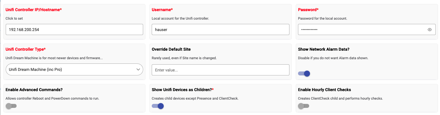

First time trying these drivers. Got a USW-LITE-16-POE. Added the Controller and can see the three child devices (Gateway and 2 Switches), changed the Device Type to the correct driver. Most things seem to work, but I can't change POE state on the ports. I can see lots of references in the thread, but in most cases, they seem to have been resolved, so trying to figure out if mine is unique or am doing something stupid.
When I try to make the change through the Device itself, I see nothing at all.
If I run it as an action in Rules, I eventually get,

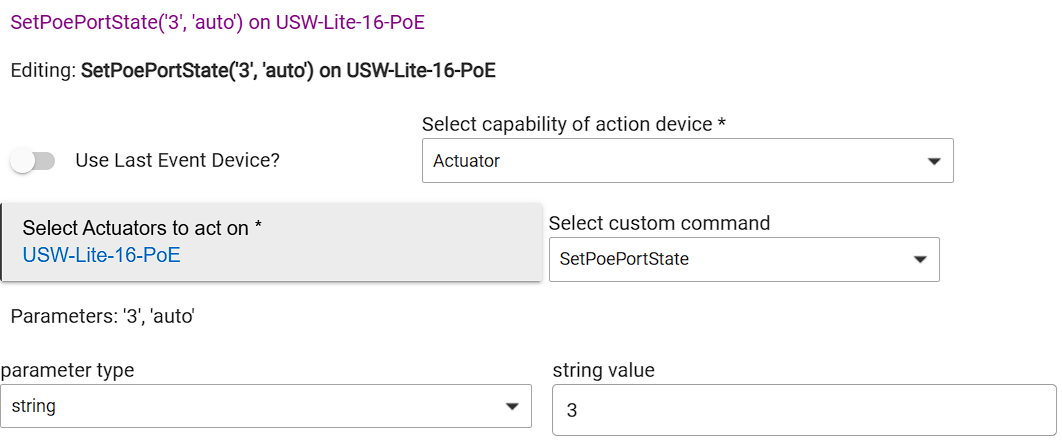

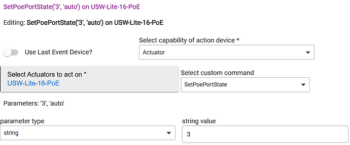

Initial check on my USW-Lite-16-POE (I actually have one of these myself) shows that it is responding to "Set PoE Port State" command on the device's page (I set Port 1 to Off, checked it in the Unifi app on my phone AND checked the Port 01 Status on the device's Current States, then changed it back to Auto and checked everything again). So that part seems to be working. I do not think I have a Rule for it, but I will check that and make an edit.
You generally will not see much change on the child device itself except the Port # Status. The only logging that would trigger from that (for the child device) is if you have Trace logging enabled for it. Most actual work and logging happens from the parent device.
In the meantime, if the drivers are loaded you should not need to change the Device Type. It should automatically create the child devices and use the correct child driver (as long as they are all added before the child device(s) are created). Did you get the child drivers after the children were created?
EDIT:

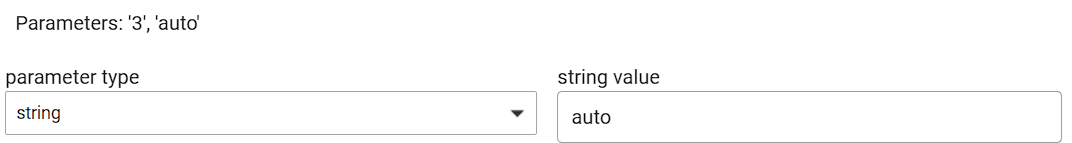

Turns out, I DID have a rule to change a PoE port as a sample, but it was for port 3 (which now has something being powered from it). Below are screenshots from it as port 3, but I did change it to Port 1 and confirmed it worked using Rule Machine (off, and then auto again). It requires 2 parameters, and both must be strings.
You should not get a Bad Request unless something is not formatted properly when the command is sent to the controller for a command like this. Did you create the Rule with 2 parameters and have both as strings (the port should not be a number field)?

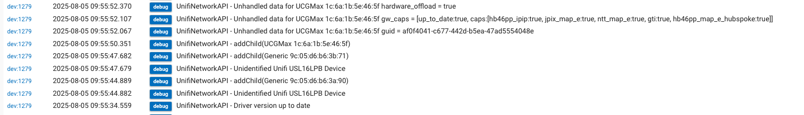

Thanks for that. I've tried restarting everything, so Removed the three devices and the Parent device. All drivers downloaded via HPM (and repaired). Restarted Hubitat (just in case) and re-added. So I added the Unifi API device, then went to Preferences, set as per the top of this thread.
Click Save. Went back into new Device, get Cookie error telling me to login again. Click Login and Refresh and then Refresh Unifi Devices. At which point, the three devices are added. The UCG-Ultra however adds as a UCGMax, but the two Switches add as UnifiChild (as they did before), I can then change to the -USW16LPoE driver, but I end up in the same situation, the set POE doesn't make any difference.
So it's not auto discovering the device type of the switches. I did try various combinations of the Rule / Action / Parameters yesterday, but had eventually landed on 2 separate strings, and I've double checked that today as well.
Only other thing I can add is that as above, its discovering the UCG-Ultra as a Max, which isn't a massive issue, except that's the device I connect to initially, could it be something to do with that, or is that clutching at straws?
(as a sidenote, I've separately setup the connection to the switches via HomeAssistant and from there I can change the state as expected, so I'm confident the problem isn't the switches or the user account or anything).
Thanks for taking a look at least.
EDIT:
Did just spot around the same time as the device was initially updated, I get the following, which could explain why its not auto discovering the devices at least...
Ok, so the switches are not being identified properly (which COULD impact how they work) because Ubiquiti changed the model identifier (probably these are a hardware revision) compared to what the code is looking for and what I have already. I already had USL16P, and USL16LP, so the USL16LPB is indeed a new one for the driver. I already had a new version of the driver in the works to add some of the things you got listed for Unhandled data, so this is an easy addition.
The UCGMax child driver supports the Max and the Ultra because they allow for the same functions. That would not impact the other devices at all (the child devices are all independent, everything runs via the parent).
You do not need to delete the whole setup. What you can do is delete a specific child device and it will automatically be created when there is data for it (like doing the Refresh Unifi Devices command).
