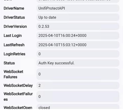

Having trouble getting my G4 Doorbell (POE) to show events or log anything when the doorbell is rang. I have a Dream Machine SE What am I doing wrong?
I've installed the Unifi Protect API & UnifiProtectChild Doorbell drivers. I then configured it and confirmed it can connect (using a non MFA local admin account):
It creates the doorbell child on its own, and all seems well, but whenever I press physical button on the doorbell, I get nothing in my logs or events. What am I doing wrong? I assume I'm a moron, but I can't figure out why I'm a moron.
This should be handled over in the Protect project thread, not the Network one. I have posted with some questions/feedback over there.
