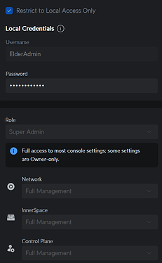

Is that login setup as an admin login ?
Yes, it's set as a superadmin
Edit: I've confirmed I can access the gateway using the local login credentials

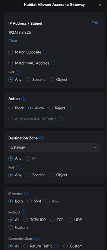

All ports are open for the hubitat to communicate with gateway. When putting my laptop on the same VLAN as the hubitat (IoT VLAN), I can't even ping the gateway so the gateway rule seems correct. Attaching screenshot of firewall rule.

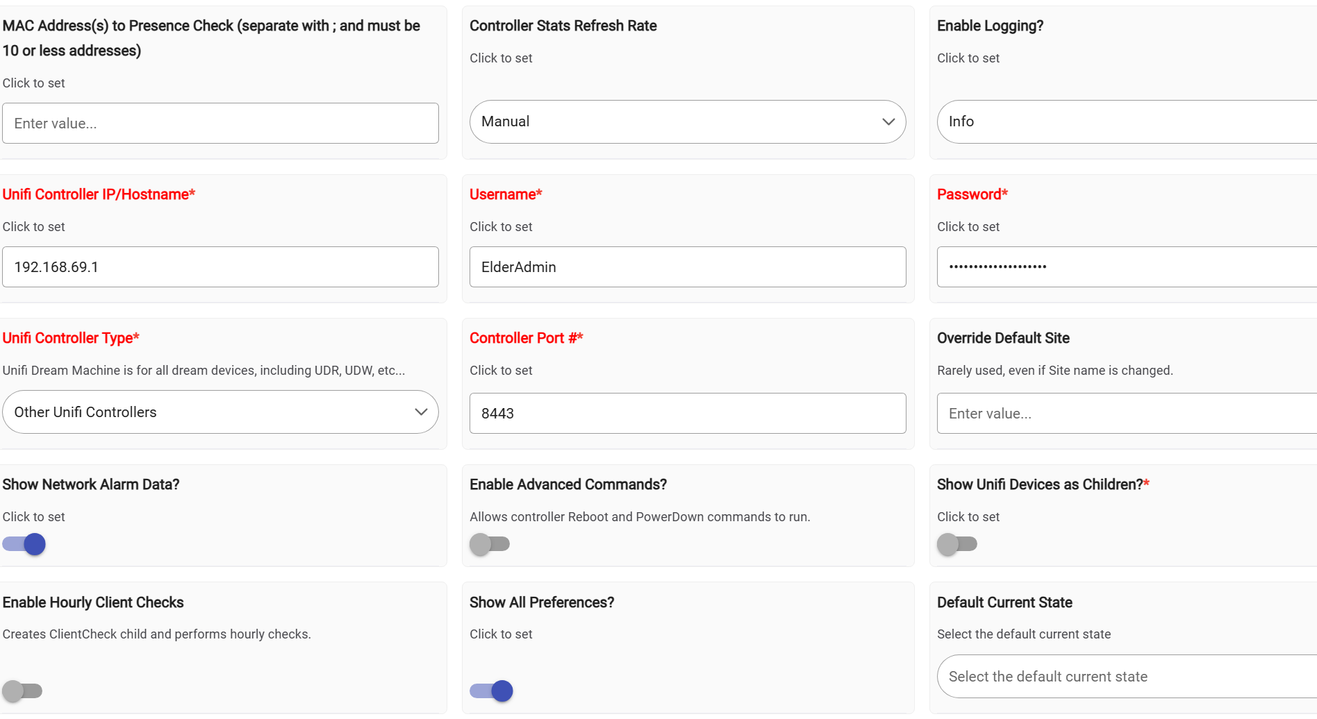

So the hubitat can "communicate", but it could to begin with since it got the "Unauthorized". The main problem would likely be with the account trying to do the communication. Since this is a newer setup it likely uses the "Dream Machine" style controller setting.

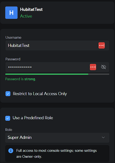

Does the account you are using have the "Restrict to local access" selection made? Here is a picture of one I made to demonstrate what the local account looks like from the web interface:
Yes, the local account is set up correctly and I've triple checked the password and just tried again with a fresh copy and paste

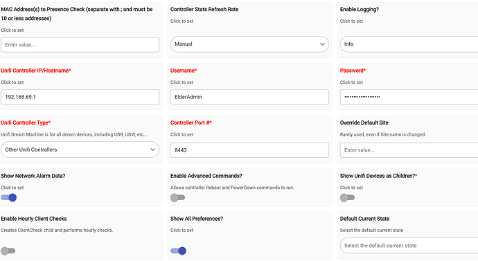

For the next thing to try, I would recommend setting the Unifi Controller Type to "Unifi Dream Machine (inc Pro). Many of the newer Ubiquiti firmware use that style of controller, even if the hardware is not a UDM.
Seems that did the trick! API now shows logged in! Time to start playing. Is there anywhere I should go to get you specific device info to add the UCG Ultra?

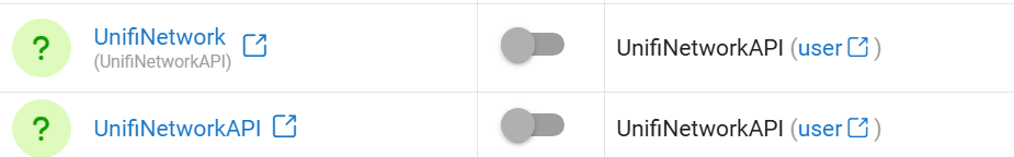

Also, under devices, I have both the virtual device I created and the API device showing after following your setup instructions. Is this normal?
No, that is not normal. The only device you should need to create is the parent virtual one. After that it will create child devices (if enabled in Preferences, or if you use Presence or ClientCheck capabilities) that are under the parent only. It should never create another one at the top level nor is the naming convention such that anything would have Unifi in it as part of the DNI. You can delete whichever one is not the one you are going to use. If you are going to use the Protect API drivers (I saw your note on that thread also), that is a separate set of drivers and will need a separate Parent/Child setup using those.
