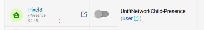

The other side of this is that the Unifi Controller has to have an actual name for the device. For example, I added my Pixel 8 to the Presence checking and it created it, but did not label it. So the label was blank. It should get the Name, correct? If I go into the Unifi controller and check the client devices I can see that it has a name in the list... but it really does not. If I select it I can see this:
Pixel8inUnifi
The name field is blank on the controller and it is providing it some "generated" name. If I enter something into the Name field and Save it will now have one. So I named it Pixel8.
Went back to my Hubitat and by the time I logged in and opened the devices, the child device's label has been switched to Pixel8.
Pixel8inHubitat
Now, if you have entered something into the Unifi side and saved it and it is not showing up... then I have more work to do because I JUST did this to get the screenshots...

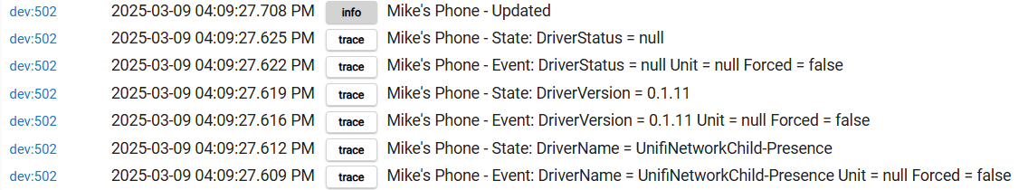

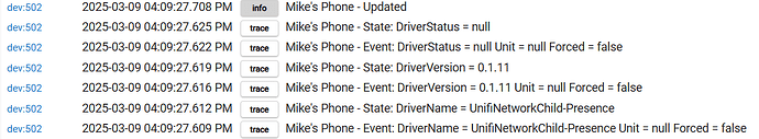

The logs for the child device are nearly silent -- on a Refresh command, I see this:
The parent meanwhile sees the Refresh and does a check, but doesn't appear to do anything with the result.
Strange... is there any chance that the MAC address reported by the phone has changed? I know on Android phones they will use a randomized MAC to connect to WiFi (and I think iPhone was going/did something similar). I know I had to stop my phone from doing that on my home WiFi so I could accurately monitor it... although then it should show the presence as "not present" even if it was there...
You can remove the second image since it has your network information... I will shoot you a separate message.
