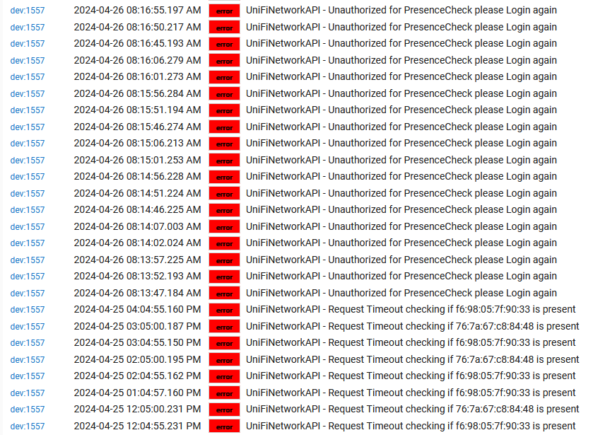

I didn't change anything between 2024-04-25 04:04:55.160 PM and 2024-04-26 08:13:47.184 AM:
Every now and then those "request time out checking if X is present" errors appear for me. I find if I pull up my UnifiNetworkAPI device and click Save Preferences the error goes away.

@Busthead: Try doing the manual Login command from the parent device to see if that helps get things reauthorized again.

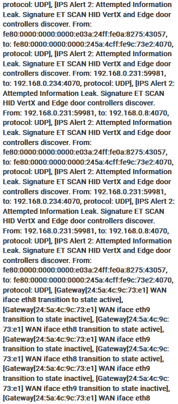

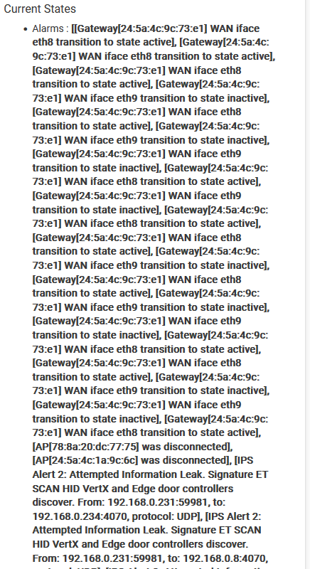

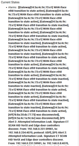

You also have a pretty large buildup of Alarm data. You might want to ArchiveAlarms those if you have dealt with them.

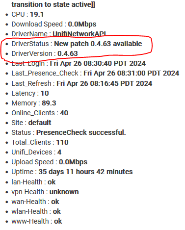

As for the version, it can take 24 hours to update the DriverStatus because that only gets checked/updated as part of the DailyCheck. I did not want it checking all the time both to not be annoying for people since it is EVERY one of my driver/devices checking every day AND because all those are checking my own webserver.

I don't know how to do archive alarms.

As for archiving alarms, there should be an "Archive Alarms" button on the parent device.
Also, this isn't going away after 24 hours:
The 403 error is "Forbidden" basically unauthorized... The controller recognized the command but the login did not have authority to run it. Are you still getting login errors or any errors if you run a refresh command?
There should be a new version coming soon... Not sure why that has not gone away on yours but we will see if it changes in the next couple days (maybe tonight ~12hrs or so).

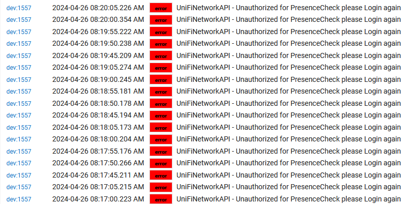

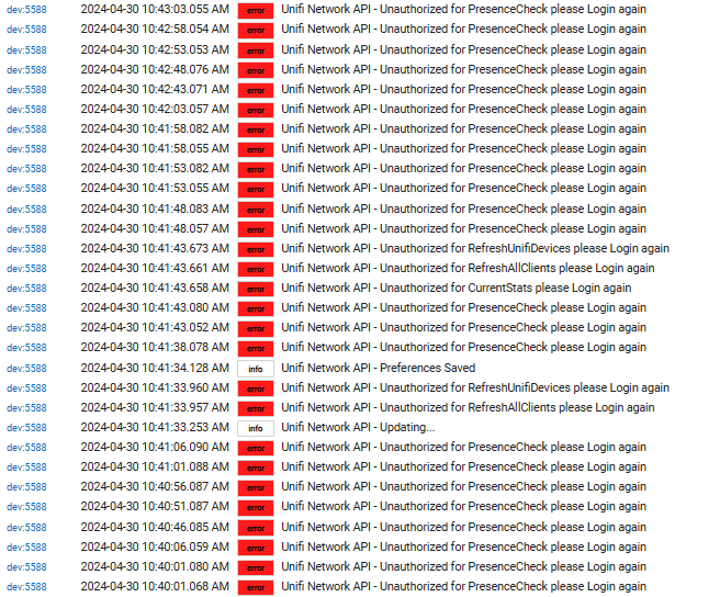

I just updated to the Early Access firmware update version 4.0.3 on my UDM Pro. That update also installed Network version 8.1.127. I don't know if this is the cause of my problem, but I suspect it is.
The problem is below and just started up today after the update:
Is there some way to log in again that I am missing? Or did Unifi make a change to the API?

**EDIT: ** I should add that when I press the Login button on the main Device, the status field updates to "Login successful." However, it immediately starts showing the Unauthorized messages again. The logs show no login attempt or success. Also, the User ID for this is local only so I believe that 2FA does not enter into this.
I'm using a View Only UniFi account.
No, I clicked the Refresh button on the parent device page and nothing appeared in the Live logs.

Are you still getting the Unauthorized errors that you posted earlier and that I posted immediately above? Mine just started this morning. What did you do to clear them and Login properly?
LJ
No
Strange, updating to 8.1.127 started this for me. That version came bundled with Console firmware version 4.0.3.
What Console firmware version are you on?
LJ
UniFi OS v3.2.12
Ok, a View-Only account cannot Archive Alarms. They can only poll general data. It should not be able to do any port actions or anything like that either.
