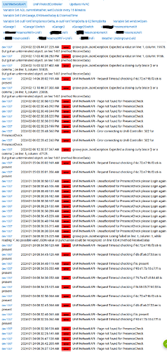

I see UniFi - Request Timeout checking if XX:XX:XX is present in the logs every hour in the last four days. Does anyone have any clue what might be the reason?
Are you performing a client check? Those are the only thing that (by default) runs hourly.
Not sure why it would be timing out but at least this will help narrow down where I need to start checking on my side.

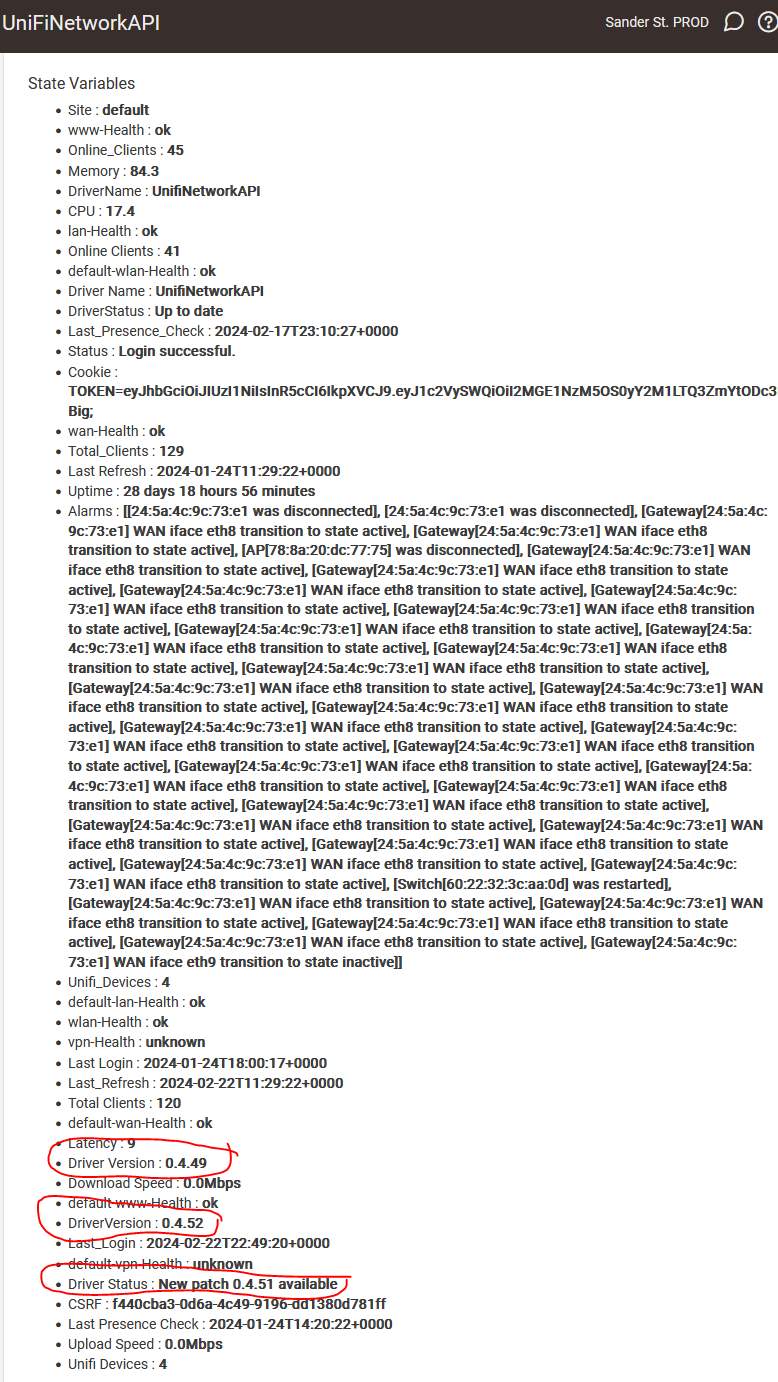

Running UniFiNetworkAPI driver version 0.4.52. UniFi Network 8.0.28
Strange that State Variables lists two different Driver Versions listed and Driver Status is reporting a patch available:
Current States:
Ok, there is a bunch going on here so I will try to do it in parts. Easiest first:
  1. The naming for driver-specific variables (Driver Name, Driver Status, and Driver Version) were changed in version 0.4.51 to remove the space in the names. So the "correct" ones are the ones without the spaces. This is a change I am slowly making across all my drivers as I try to remove spaces in names (because of how they can show duplicate entries as Events on the device page).

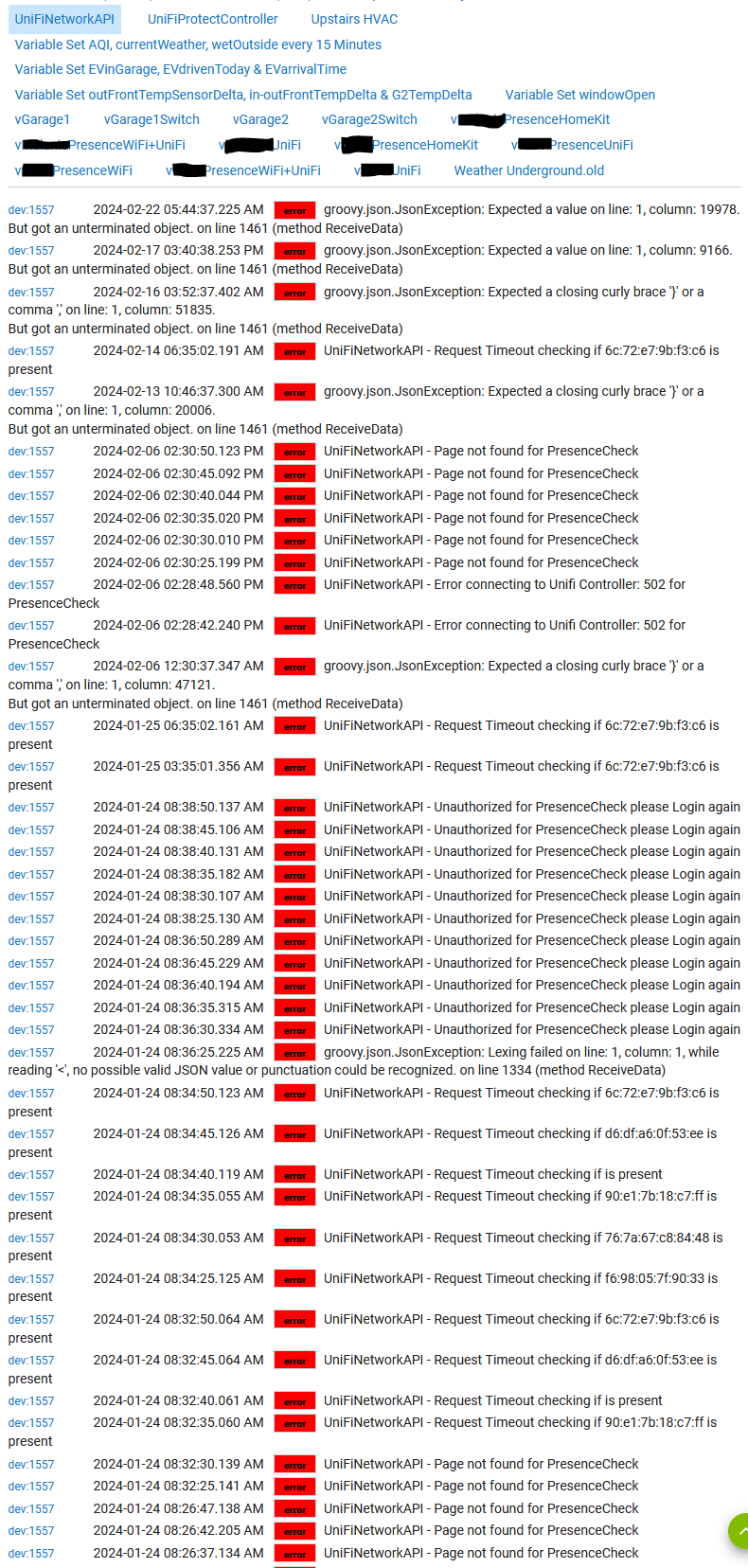

  2. Only looking at the more recent errors in your log because many of those are before the more recent version was published (0.4.52 was published on January 21st) and the "worst" problems look like the unterminated data. The problem there is that it is the data coming back from the API that appears to have an error as the json cannot be parsed properly. It is also for the most generic "ReceiveData" function that most everything uses to handle returned data. So... does the timing of the error seem to coincide with a refresh or some other scheduled activity? It does not seem to be on a regular cadence for the time and it is not even happening every day.
I checked my own logs and got something similar but not exactly same and I only have one instance of it. The line number would be the same as yours for 1461 but I have a newer version that has added a couple lines and is not published yet. The 3:10am does not correspond with any specific scheduled activity except MAYBE a presence check (since those are so frequent). Certainly not a refresh or daily check. Here is the error I saw:
[dev:2]2024-02-21 03:10:39.145 AM[error]groovy.json.JsonException: Lexing failed on line: 1, column: 1, while reading '<', no possible valid JSON value or punctuation could be recognized. on line 1463 (method ReceiveData)
If you can see if it corresponds to a particular activity or starts happening regularly maybe Trace logging can be enabled and the response checked (since the log would have the response listed as "Received" with the data after it). Then we can see if the API is provided some incorrectly formatted json.

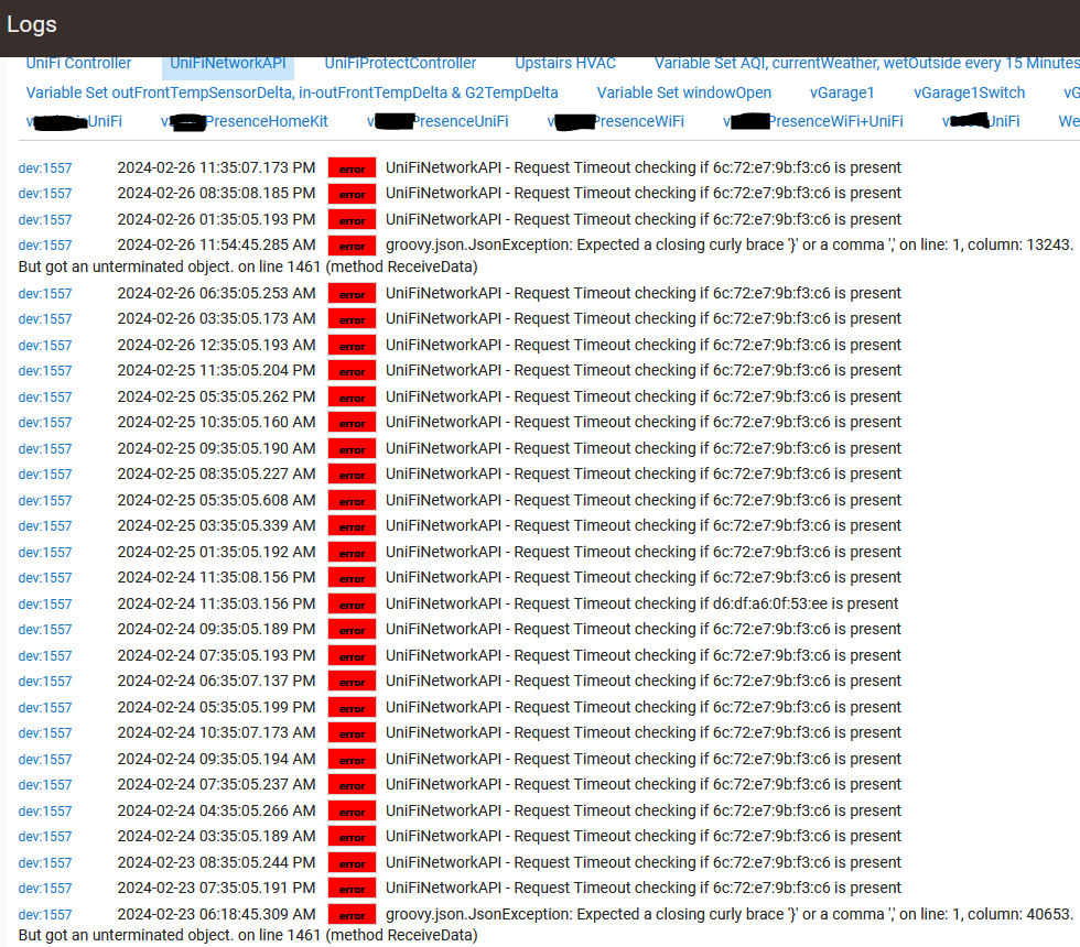

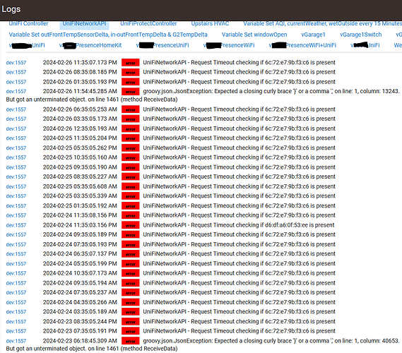

We were out of town all weekend. These errors appear to occur when the driver is checking for presence of our son's phone - which was not present because it was with us on our trip.
The same thing happened to me when we were away. @snell that explains why I don't see the errors now when I am back.
Huh... so that implies that one of the newer versions of the Network API changed the response method. It used to just return a 400 error "Bad Request" if a device was offline, which I handle. Maybe in some cases they are now returning a 408 "Request Timeout"...
Seeing what I can do on my end. Still not sure why there would be any JsonExceptions though. I am hesitant to just immediately make 408's for Presence Checks become offline without testing. What is troubling (for me) is that I have a device I keep "offline" (powered down) for a lot of the testing and it comes back with the normal response.
