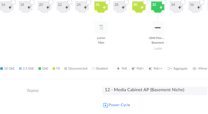

This is a bit odd. I don't use it very often, but I can't recall any version of network where it wasn't there. I see it now in 7.4.149:
Also, I just tried your PowerCycle button and it worked fine on my USW-48-Pro-PoE
@Bullfrog If you click on the individual port in the Unifi controller, you will get a "power cycle" option under the port name.
Right, I'm saying that it's working fine for me. I was wondering why @snell seemed to think that the powercycle had been removed.

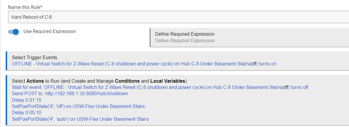

This is my rule (screen shot was grabbed while it was running, thus the "Offlines"):
I just ran it to test and it worked perfectly.
