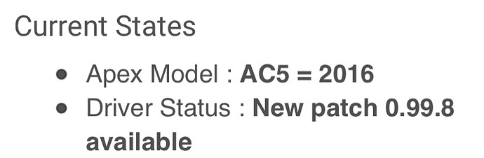

Also, what’s the trick for upgrading through HPM?
Still showing this… confirmed the driver code showing 0.99.9
No trick for upgrading, you have the latest. But it only checks the version info once a day (so I do not get a bunch of people pounding my server) and I do not know a way to trigger a check if the driver itself is changed/saved. So it should "fix" itself tomorrow.
