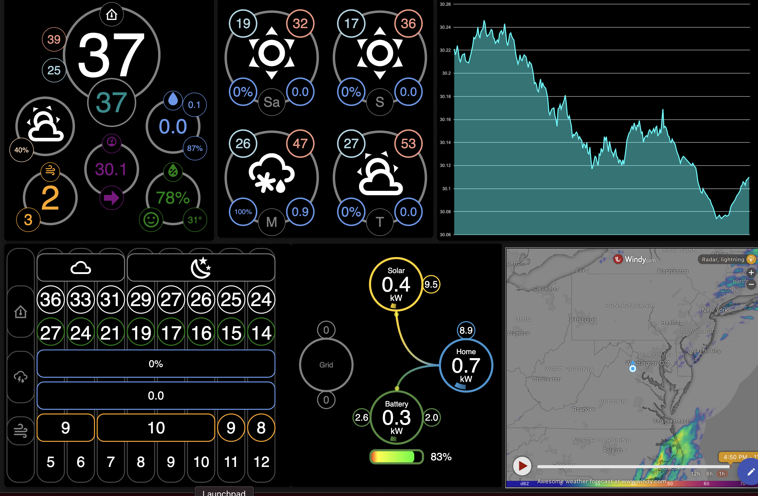

Everything running again! Your driver is excellent @snell. Screenshot below:
I will have to see about the cookies... I do not actually have a Powerwall myself so I have no way to know when they change things (it is not a published API after all). If you do not mind sending me a sample of the header response (with the cookie) I can build it in. Plus, a sample of the TempData would be useful. Those previous 4 were based off what I had been provided for samples before. If Tesla has different versions out there I am going to have to make a way to detect the difference and have the driver provide the correct thing (since I do not want to botch the other users that it is currently working for).
That is a nice looking (if a bit busy for my taste) dashboard. Just to confirm... is that saying you are not drawing any power from the grid at that time?
Yes.
The “business” are some weather widgets I am working on for the wife. (To lazy to crop it). I have been working though the bottom left “hourly” widget for 2 weeks…
In any case, I can provide any data you’d like. It is also possible that the data change with the “upgrade” that hit this morning. I took a look and it seems to parse everything else correctly.
Yes, the graph in lower middle is showing that I am running off the battery and solar, no grid. It updates each minute so the wife can see “what is happening”
I went one step further and added a “midnight” data collection so that the driver can now compute the daily power generation. I am testing it tonight/tomorrow and can send you changes I made over PM if you’d like…
