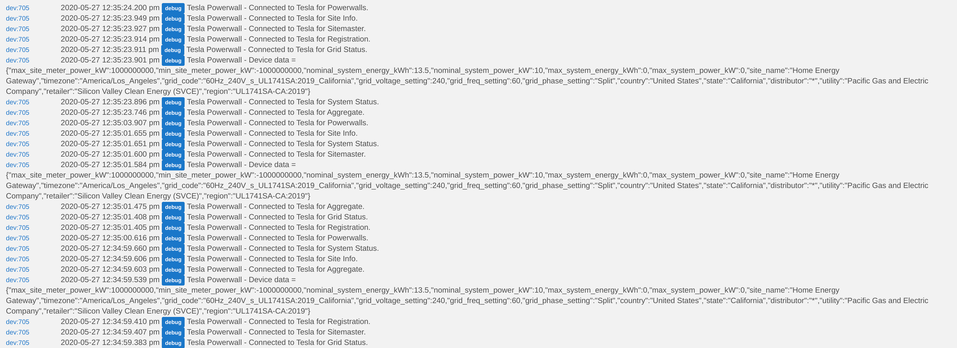

everything seems to be working smoothly for me for the last few days running 0.2.4 and 0.1.3
dev:7052020-05-27 12:35:03.907 pm debugTesla Powerwall - Connected to Tesla for Powerwalls.
dev:7052020-05-27 12:35:01.655 pm debugTesla Powerwall - Connected to Tesla for Site Info.
dev:7052020-05-27 12:35:01.651 pm debugTesla Powerwall - Connected to Tesla for System Status.
dev:7052020-05-27 12:35:01.600 pm debugTesla Powerwall - Connected to Tesla for Sitemaster.
dev:7052020-05-27 12:35:01.584 pm debugTesla Powerwall - Device data = {"max_site_meter_power_kW":1000000000,"min_site_meter_power_kW":-1000000000,"nominal_system_energy_kWh":13.5,"nominal_system_power_kW":10,"max_system_energy_kWh":0,"max_system_power_kW":0,"site_name":"Home Energy Gateway","timezone":"America/Los_Angeles","grid_code":"60Hz_240V_s_UL1741SA:2019_California","grid_voltage_setting":240,"grid_freq_setting":60,"grid_phase_setting":"Split","country":"United States","state":"California","distributor":"*","utility":"Pacific Gas and Electric Company","retailer":"Silicon Valley Clean Energy (SVCE)","region":"UL1741SA-CA:2019"}

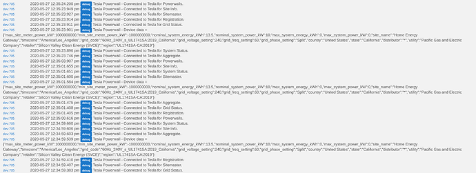

Somthing might be wrong,
I'm in debug and the long logs generated are
dev:7052020-05-28 05:00:22.356 pm debugTesla Powerwall - Driver version up to date
dev:7052020-05-28 05:00:21.824 pm infoTesla Powerwall - Updated
dev:7052020-05-28 05:00:21.810 pm debugTesla Powerwall - Refresh rate: 1 minute

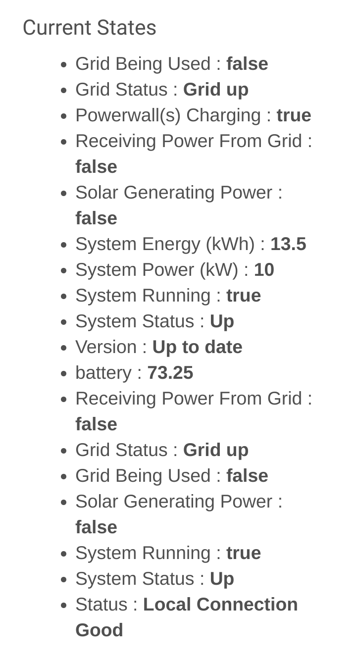

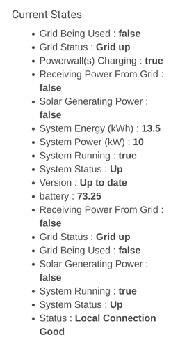

current system state is :
the main driver shows this

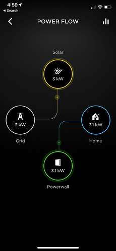

Solar is being generated, but because we're in "high time of use" power billing rate, the solar that is being generated is going to the grid and I'm using my cheap stored power.
So solar should be a string maybe? (Not Generating/Sending to Grid/Sending to Powerwall)
Certainly works and is recovering more items as said. But like @jared.zimmerman I'm still seeing the grid Being used as false, even though in my house, I only pull from the battery when the Grid is down.
There's something odd in how Tesla is dumping that data, as it also reports my battery as charging, which it it doesn't do off the grid (its night here) unless we're under storm watch, which we presently are not.
