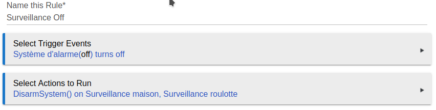

these are my rules:
The last line triggers another rules witch disarm the system:
Maybe disarming 2 networks at the same time is too much?
I will install the new version and see what happen.

Authorization works. Arming works (2 networks at the same time through a rule) but I get the same error as mention by others:
The network devices states they are disarmed even though they were armed.
