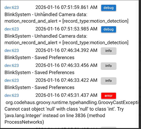

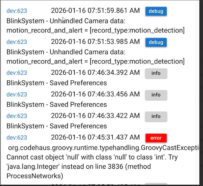

Having an issue - I installed the Blink driver via HPM. At first everything was going fine. Now when I try to arm a camera, it takes up to 4 minutes before the action is complete. Another item, looking through the logs, it lists only 7 cameras and I have eight, The naming of the cameras in the logs does not correspond with what is in the device list. Receiving an error also.
Updated Version(s):
  • BlinkAPI.groovy = 0.7.2
Change(s):
  • Attempt at fixing the null condition @LGNEO hit on line 3836 (at that time) as well as similar lines within the same function. This likely caused the overall issues that were seen as it would prevent the rest of the code from processing.
Note(s):
  • I did not get the Unhandled data "motion_record_and_alert" in. That will be in a future version.
