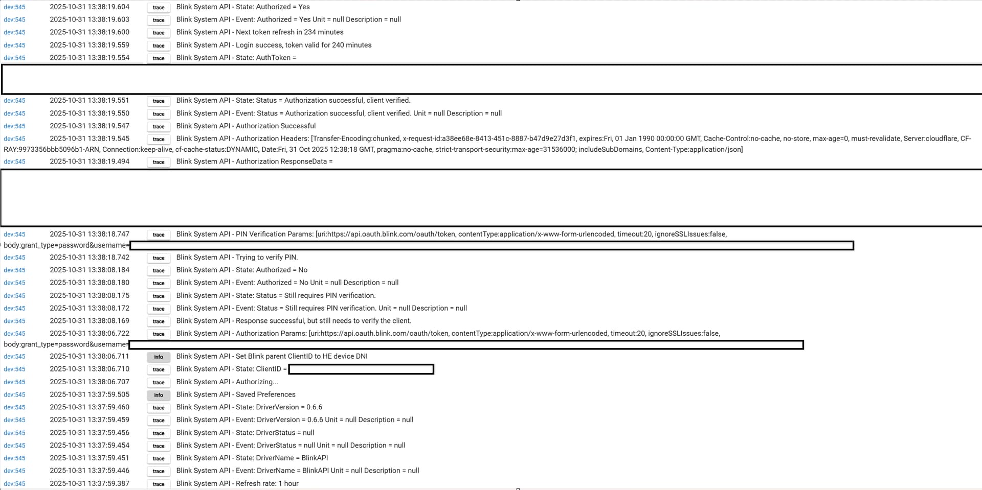

Authorization command with PIN works fine, but running any commands, including "Get Homescreen", results in an "Unauthorized" error in the logs so obviously no child devices get created.
@dnickel this was a brand new install of 0.6.6 so my original Authorize command was set to Reauthorize=false
Do you receive the text message with the PIN after setting ‘Authorize’ to false, and then use the ‘Verify PIN’ command to complete authorization?

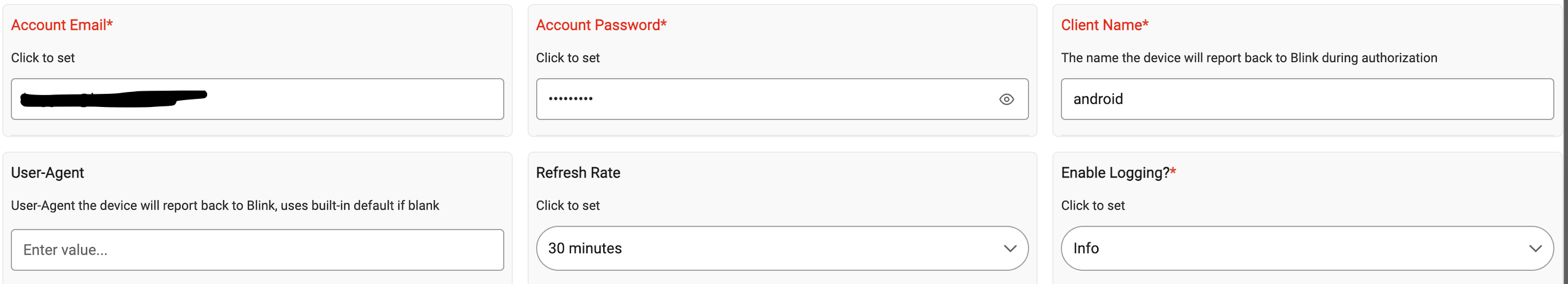

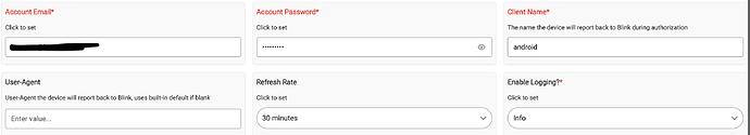

Also confirming — your preferences look exactly like this (case sensitive) for ‘Client Name’ and ‘User-Agent’? I understand that ‘ios’ does work, but none of the reverse-engineered code shows that variation.
Network traces of the iOS app show that's what is used as the client name, however the user agent is definitely not 27.0ANDROID_28373244 in that case (e.g. Mozilla/5.0 (iPhone; CPU iPhone OS 18_7 like Mac OS X) AppleWebKit/605.1.15 (KHTML, like Gecko) Version/26.0.1 Mobile/15E148 Safari/604.1). Would be impressed if the backend crossed-referenced them (I do use "ios" here, with the user agent pref left blank).
That looks perfect with the token valid for the correct duration.
Sorry, not sure I can help from here with the driver. Anything stand out when you hit 'refresh' with trace on? Maybe @snell can comment from there on that ^^.
