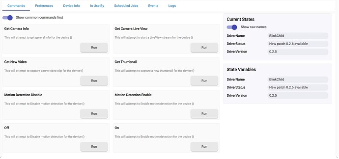

  • @Terk: Mini cameras cannot have their motion enabled/disabled directly. It does not work (never has, and to my knowledge nobody has ever figured out why). The Rosie device you see is the pan-tilt mount associated with a mini camera. However, there is no controls known within the API to handle the Rosie... so it is effectively a placeholder using the BlinkChild driver. BlinkChild has more commands than can be used with it because it is meant to be a generic "placeholder" driver until something better can be made for individual devices. Unfortunately, nothing better has been possible for a Rosie yet (I have one myself).

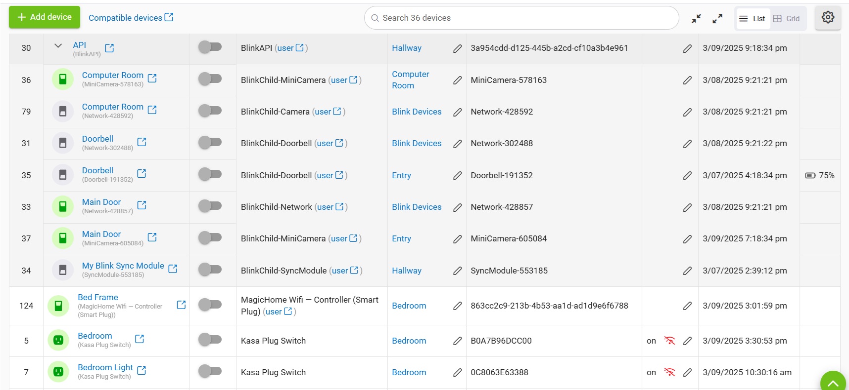

Hey @snell ,
Fantastic work! Everything ran as expected and all child devices were created per my setup.
