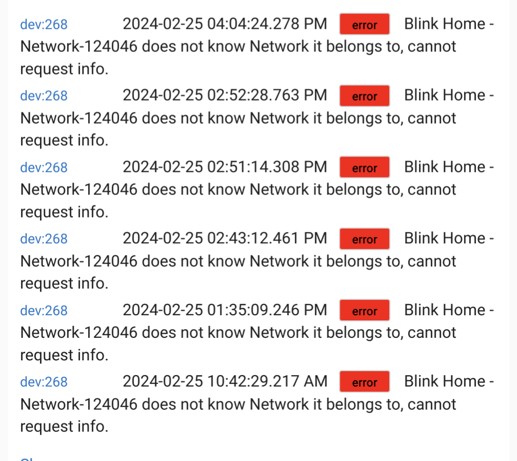

No errors in the logs?
Ah ha. I don't know why I didn't go look in the logs..
I assume, from that error, that the Network does not have a "Network" field in it's State Variables. You are doing the Arm/Disarm through the network and not via the Parent or the particular cameras?
My automations arm and disarm it through the blink child device. Actually by using the on/off switch of the child device.
The network in that number is populated is the device ID for the child.
I also see it as a state variable under the parent device as well.
Now in hindsight, I think those log errors were when I was trying to use the arm button from the parent and child devices during my testing.
I just hit the arm button from the child device and have another log entry about the network ID again.
I'm not quite sure what changed because I've been using it like this for a while and haven't changed anything. Unless something changed on the blink side perhaps?.
Cannot think of anything that I changed but I will check the code. The parent needs an ID provided but child devices should provide their own ID (unless some problem occurs).

What version of the drivers do you have? I am having issues even finding logging that could generate that error message...
I did try On/Off for my Network and it did work (on the Hubitat and showed the correct status in the Blink app as well)... but I did not get an error either.
Interesting. I have a state variable of ID with that same number in it under the child but not under the parent device.

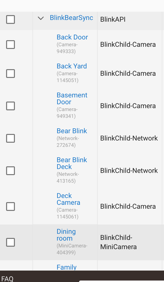

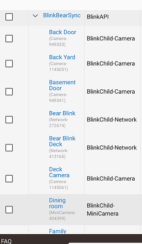

Here's my devices and how they show up. If it's not right, I have no idea what happened. I really haven't changed anything in quite a while besides habitat updates and reboots every once in awhile.
All of your Blink-Child entries now have specialize drivers available
I just did a modify on it via HPM and installed the camera child drivers.
In the parent device, I did a re authorize, got the pin, and reverifed it. Then did a get home screen.
Cameras have the correct driver now, but still doesn't seem to want to do anything.
Still getting the same log entries about the network
Out of curiosity, do you have anything configured for the Client Name or User Agent preferences in the parent device or are those the default "blank" values?
Both default blank..
You said you were doing the arm/disarm via the Network child, correct? You need to switch the Network child device(s) to use the BlinkChild-Network driver. The Network driver makes use of the state.ID when making Arm/Disarm calls. The generic child driver uses state.'Network ID'... but a Network child device generally will not have a 'Network ID' because it IS the network.
On a side note... I finally found where that logging error is used... Since it was not in the BlinkAPI parent driver and I thought I was going nuts. That error "Network-124046 does not know Network it belongs to, cannot request info." ONLY exists on the BlinkChild driver and the BlinkChild-Camera drivers.
