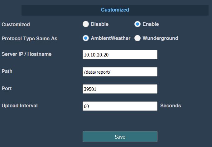

So I just got the WS-1965B and was thinking that local would work but it's not. I turned on Trace and it looks like it's doing a GET for /endpoint and not a POST for the data. It's annoying how they make everything function so differently.

Looking over the information, it does say that it can publish the data to a custom website, so that is what allow it to do the local data. So a few things to check:
  1. That the Ambient App has been configured to publish data to your Hubitat correctly.
  2. That the Hubitat device has the correct MAC entered properly as the DNI and that the Weather Method is set for "Ambient Local".
When it is set for Ambient Local, the Hubitat device does not poll for data. It receives it when the Hubitat gets the data sent to it by the weather station.
  1. It has been configured correctly, I triple checked it. It is "trying" to publish, that is what those events are from above. That is the WS reaching out to my Hubitat.
  2. The mac that it shows in the raw data is the correct MAC that I have in the DNI and what shows on the actual device. It is set to Ambient Local.

Strange, I do not have a new Ambient by any means (WS-2902A) but all it does is send the data to the endpoint (the Hubitat) per the custom destination. It does not have any handshake or such... just send and forget about it.
Their setup page is pretty simple too. I looked at mine and compared it when you sent the screenshot originally and they were basically the same (except the IP, but oddly, I ALSO use 10.10.10... so everything but the last number was the same).

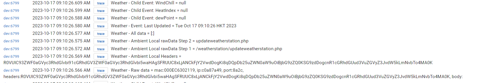

I just got a different response in my logs..... what do you make of this?

Is it trying to provide data using a weather underground method? This driver will only accept receiving data that is formatted for Ecowitt or Ambient (which are nearly the same data, but not quite) methods.
It also looks like the device might be set to "Ecowitt Local" mode. From digging into the Misol IP Observer (which I had never heard of before this nor seen the similar Ambient IP Observer) it looks like it is specifically an Ambient "esque" device. So you want to set the Weather Method preference on the device page to be "Ambient Local".
On the device page, it is updating every 15 secs, so it is talking to the driver.
It must be a format issue at this point. Is there a way to capture this data stream and see what data is being generated?
In trace mode the log generated is.....
Can you send me the logging lines from the Raw data and Local Headers that you have shown as text in a message directly to me? It does appear to be a decoding issue.
Whatever it is doing... it is NOT providing it in the "normal" Ambient Local method. So it will be necessary to figure out how it is encoding the data, decode it, and then maybe I can add a new method to support it.
