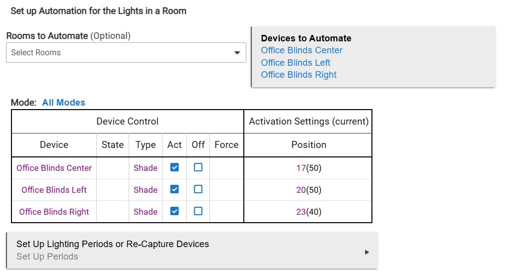

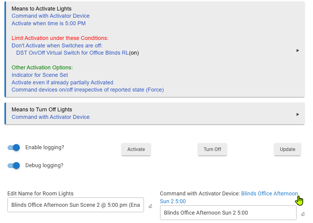

Here's a picture of a similar room lighting automation that I set up to set my blinds to a specific position during the day.
Per @bertabcd1234 's comment, create an Activator Device by typing the name you want to use in the "Command with Activator Device" field at the bottom of the screen. Then use that virtual "Activator" device created by RL rather than a virtual switch. I usually name my activator device and the RL automation w/the same (or very similar) names.
