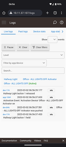

Anyway, I have 2 "scenes" for every room: One for ALL LIGHTS ON for that room and one for ALL LIGHTS OFF. It seems like after a platform upgrade, all of my ALL LIGHTS ON scenes work perfectly fine. However, ALL LIGHTS OFF does nothing. According to the logs, the button press IS being registered and the ALL LIGHTS OFF scene IS getting triggered, but the lights do not change.
Again, this only affects my scenes that command the lights to be OFF when the scene is "activated", but it affects ALL of them. And again, this exact thing happened after the upgrade from 2.3.3 to 2.3.4, but eventually resolved itself after a few days.
