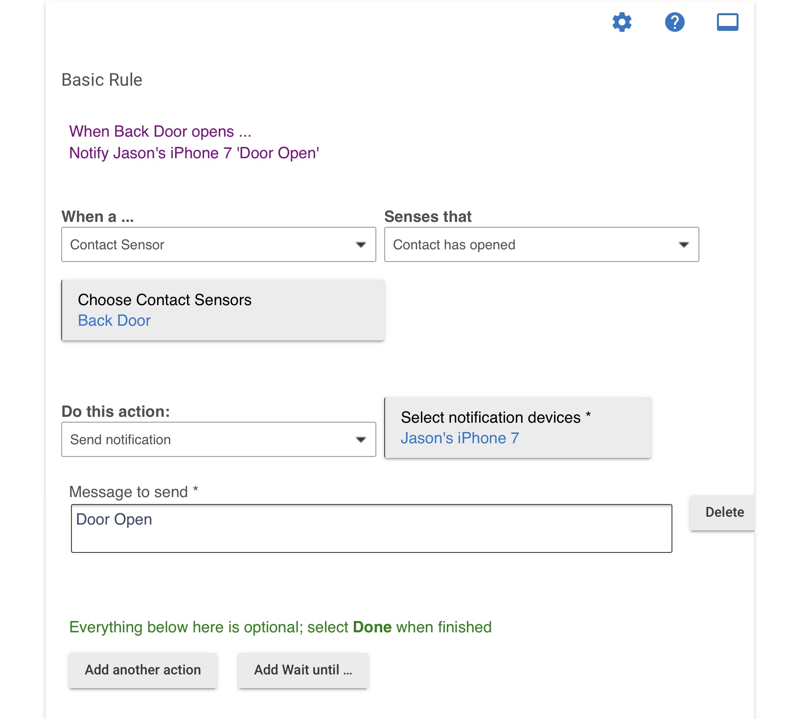

Here is a example using the Basic Rule App.

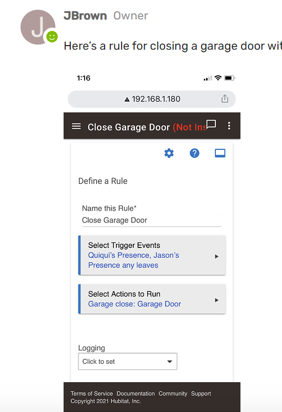

Here’s a rule for closing a garage door with rule machine.

Thanks, but I was hoping to get the system to send an audible noise every time a door opens. This is a basic function of a typical security system that I am trying to replace with Hubitat. If I need to buy some kind of speaker, that is fine, but was hoping that I could just use my Alexa.

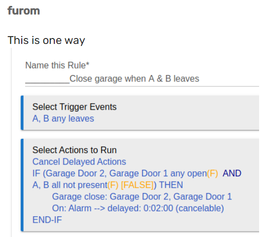

Thanks, but I was able to create a rule that opens the door when one of us arrives, but I would like to close the doors only when both of us are gone. Is that possible?
This looks like what I want, but need a little more info. How do I create this in RM? Your help would be deeply appreciated. Thanks.
Ed
Thank you. It will take me a while to understand the full logic to apply to other situations, but you opened my eyes. Much appreciated...
