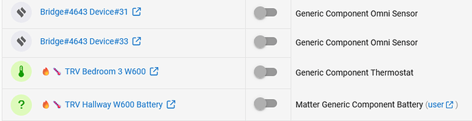

@mike.maxwell,

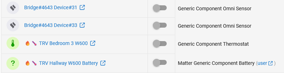

Please see comparison of system vs custom driver.
As you can see that the system driver has not picked up the mini switches and W600 TRV.

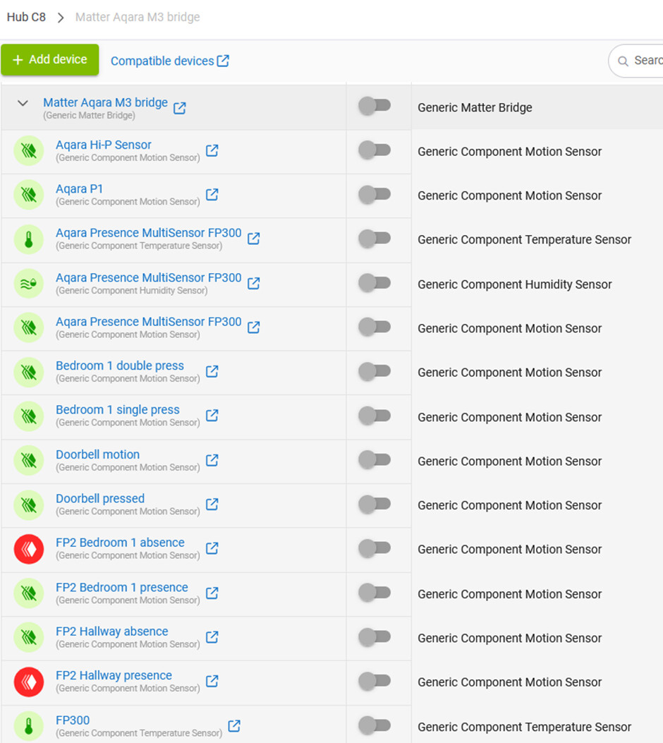

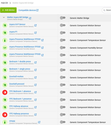

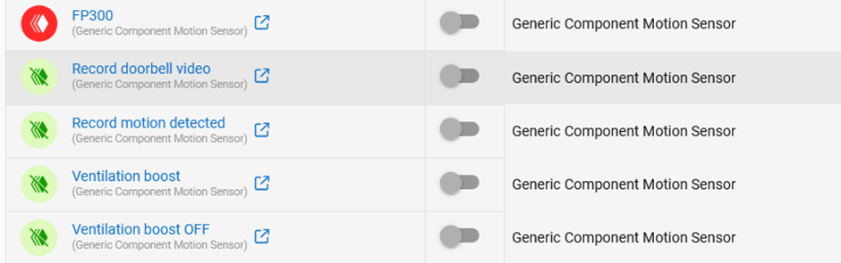

Generic Matter Bridge:

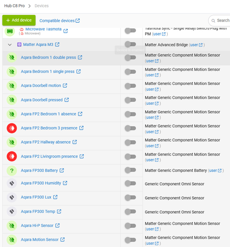

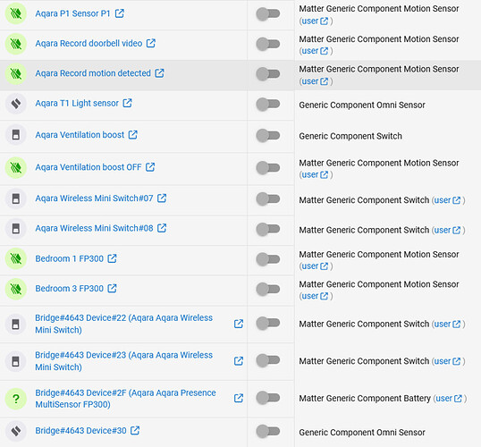

Custom Matter Driver:
