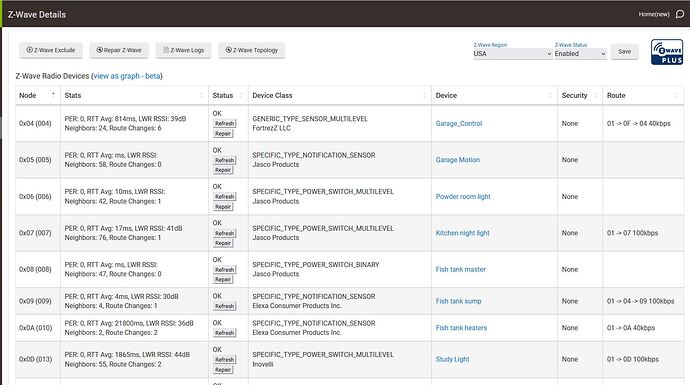

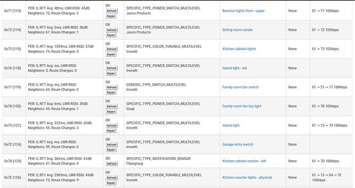

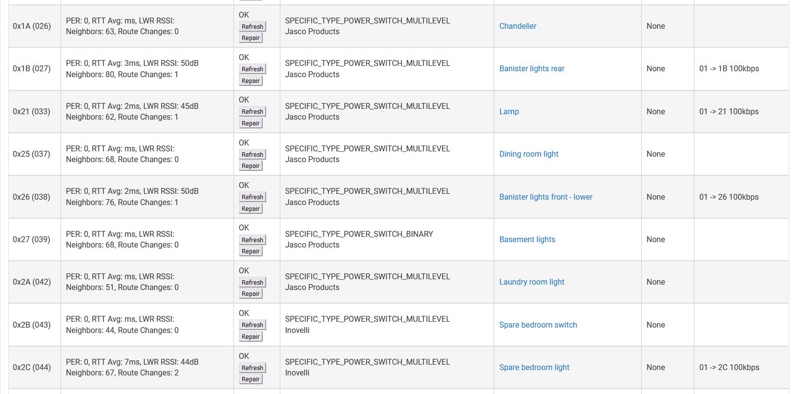

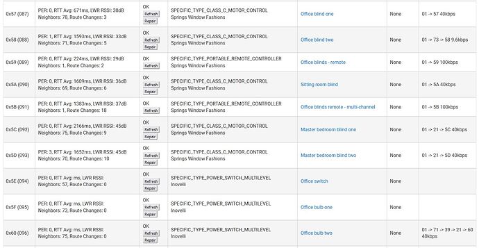

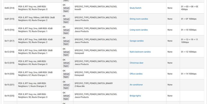

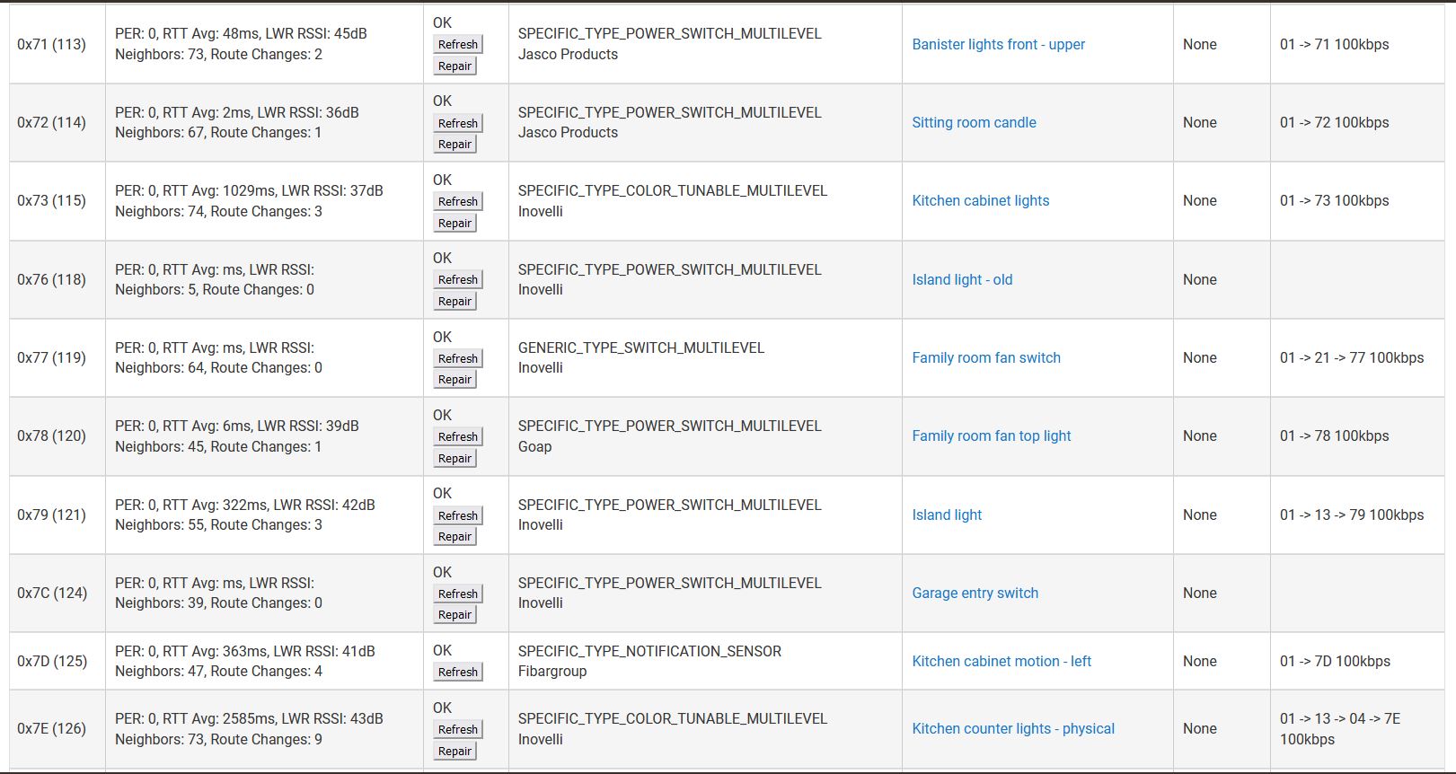

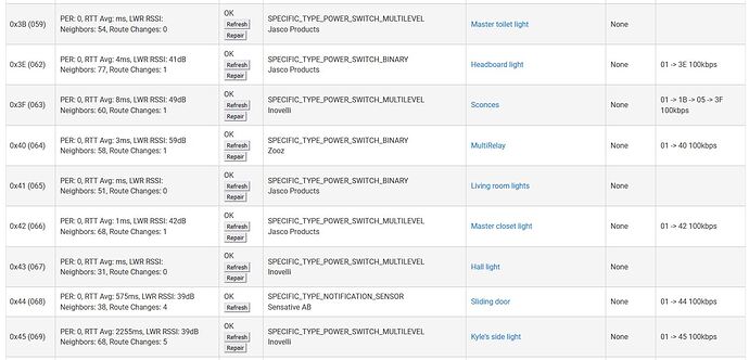

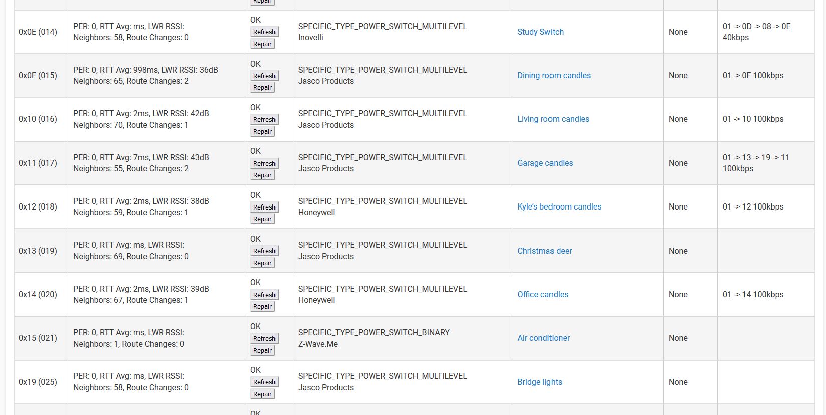

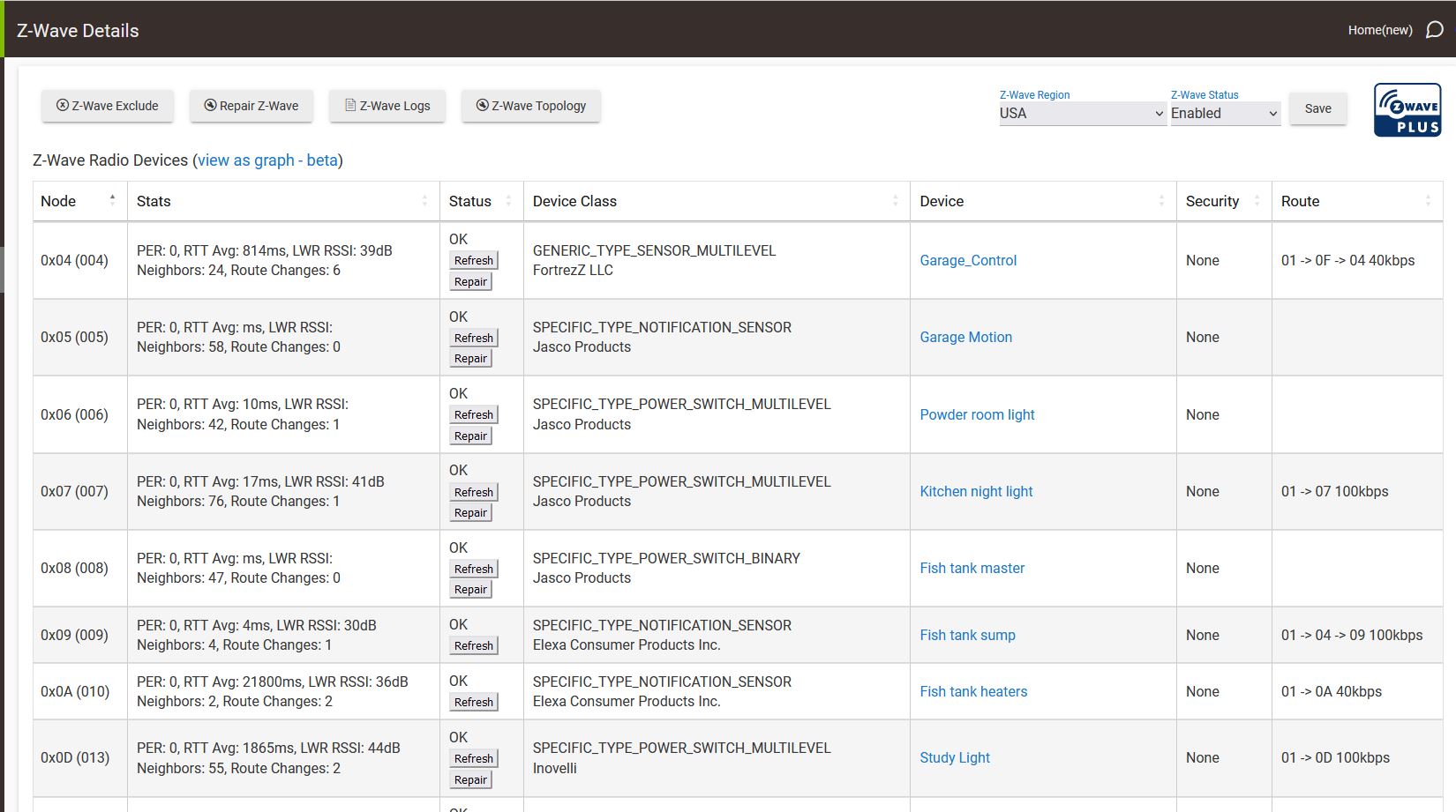

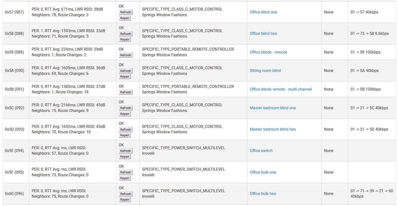

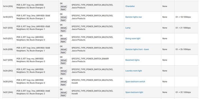

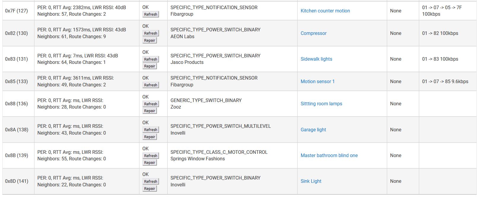

I understand it's long but it would still help us to help you if you posted your z-wave details page. Just use windows snip and break it up. We can tell other things from the mesh setup than just ghosts as well.

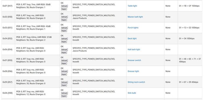

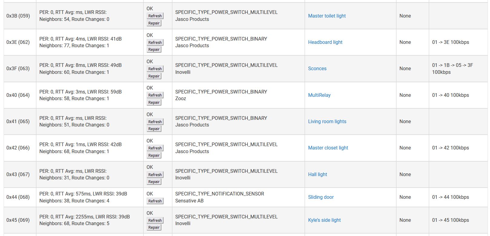

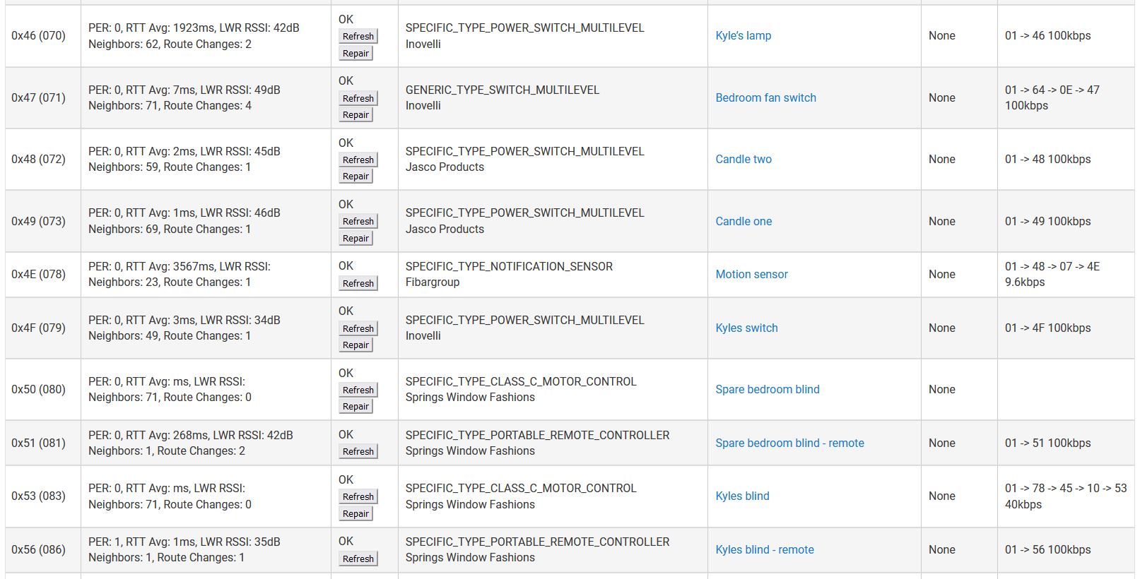

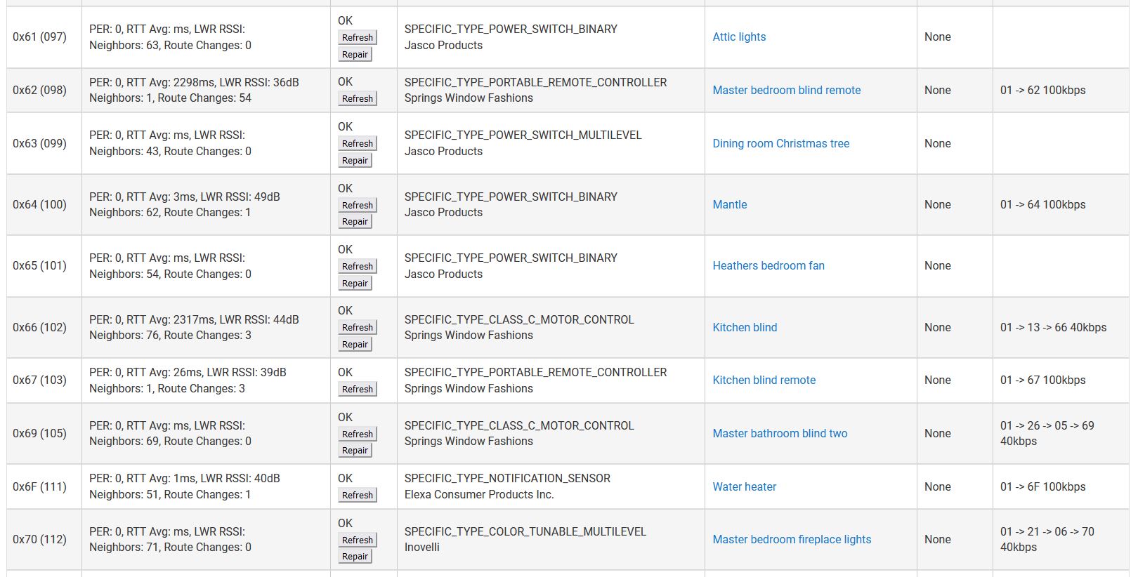

As of today, the entire zwave mesh is useless, and nothing is controllable ... clearly, waiting is not the answer here. Here are the mesh screenshots ... (and a note for the Hubitat developers should they happen upon this thread - it would be nice to have an "export screenshot" button, or other mechanism to break the zwave details list out of whatever sudo frame they are rendered in within the GUI.)
In general it doesn't look bad. Do me a favor. Shut down from the settings menu. Unplug power to the hub for 2 mins and power back up. Then start trying to control devices directly on the device page.
IF this is after an overnight, I'd disagree. All those missing routes are paired to zero route changes... there should be one, right? If the route table is cleared, then finding a route would be a change?
