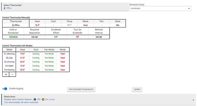

Since I have upload the last version of Hubitat and install the new thermostat scehduler v2 with the new mode manager my heating control doesn't work with my Sinopé thermostat.
It looks like the scheduler thermostat doesn't send the temperature to the thermostat. The only mode which works is the Away mode. My thermostat scheduler is also set for restriction mode, but the controller don't switch off my thermostats.

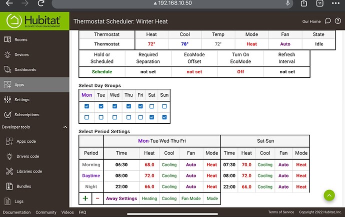

Actually, I have still problem, the patch has only solve the on and off control. However the thermostat scheduler doen't send the temperature to the thermostat.

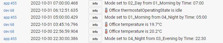

On the log we can see that the mode change but the thermal command is not send.

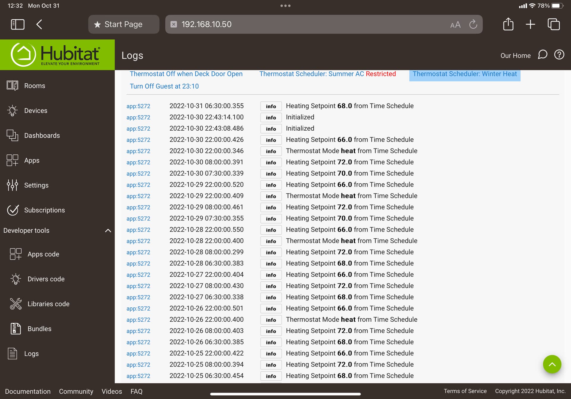

Im having random “skipped events” in TCv2 also. 72degrees was skipped this morning. As was a 66 on Saturday night, I’m running .140 but it occurred a few weeks ago on a prior.
